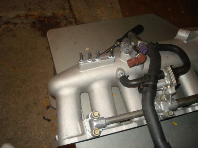

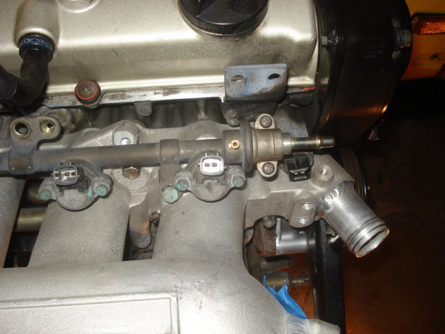

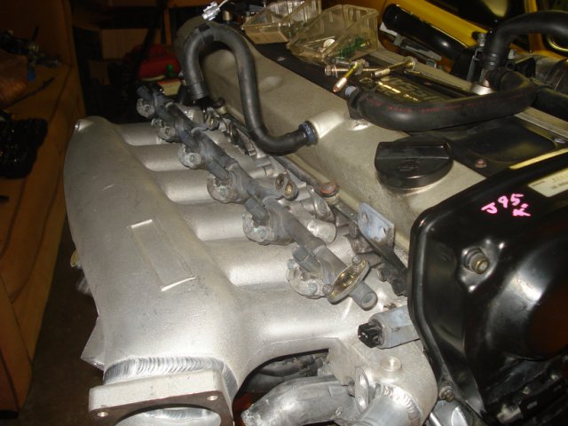

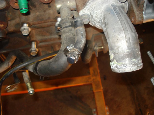

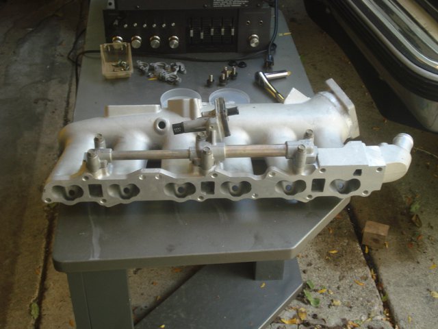

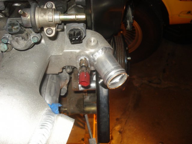

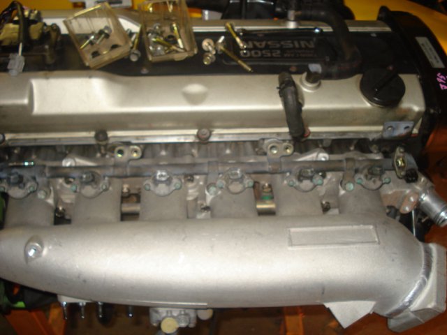

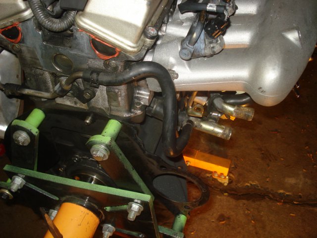

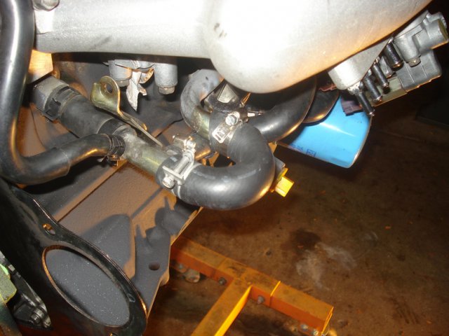

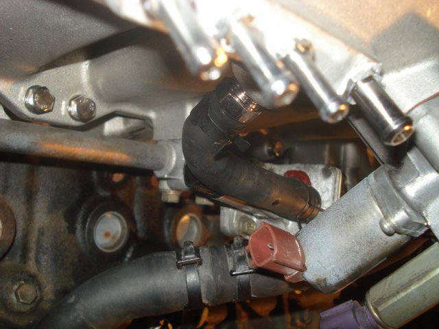

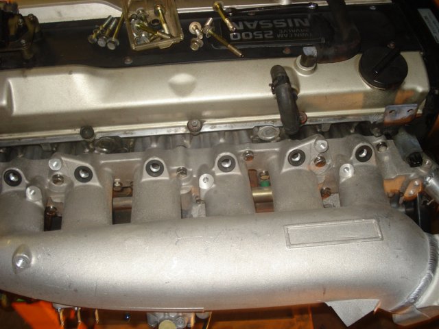

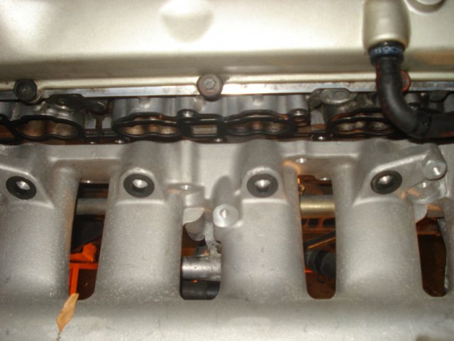

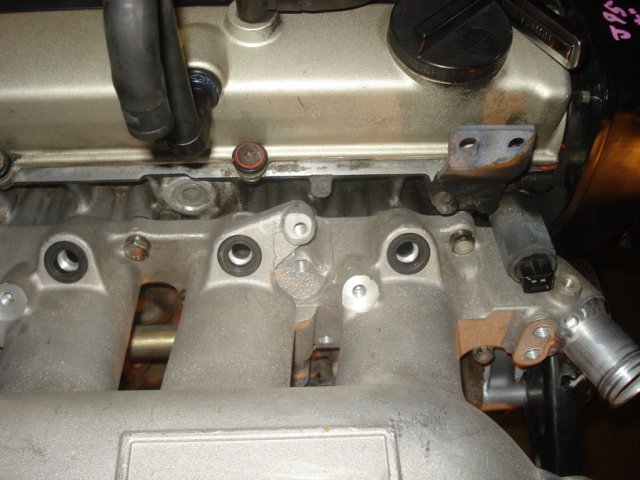

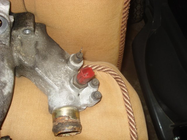

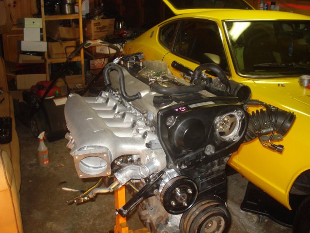

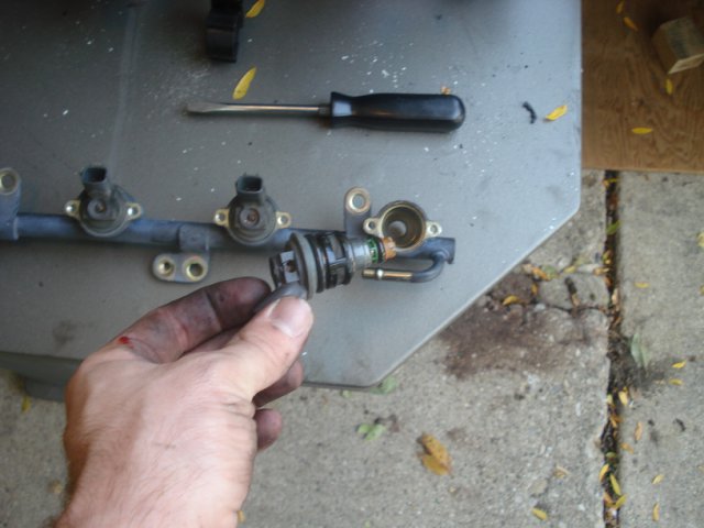

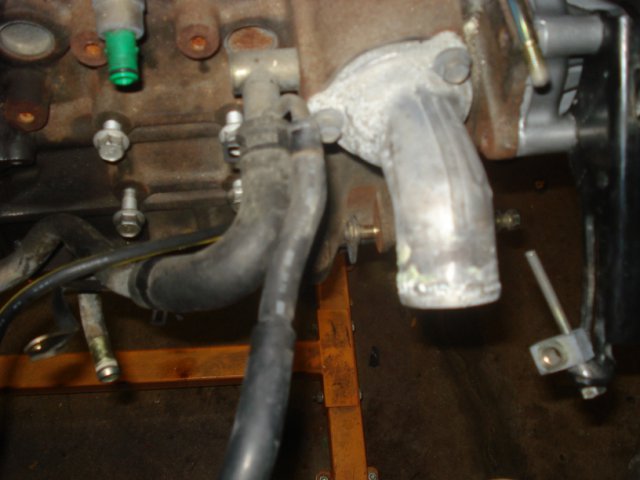

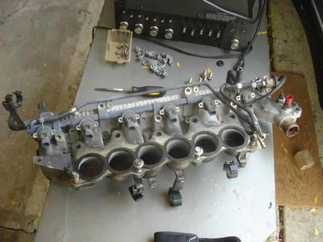

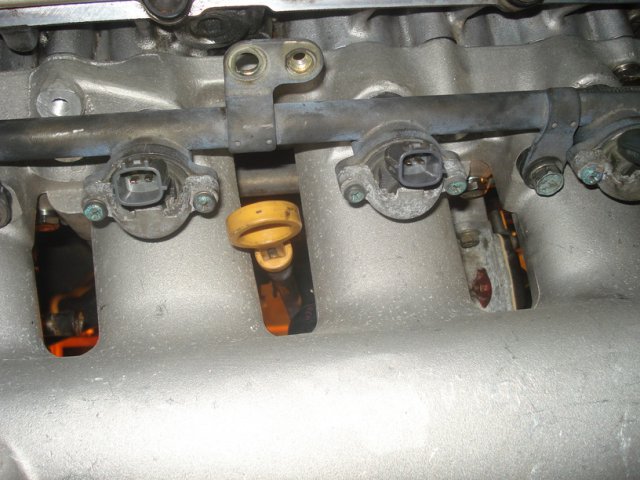

Update: Intake manifold Removing the stock intake is a bit tricky. Their are some bolts that you must get to from the bottom and they are a huge pain. Needless to say it was easier because I had the motor out of the car. But it is not impossible when its installed. I followed a link that I found here. http://www.skylinesaustralia.com/forums/topic/181826-how-to-greddy-style-plenum-install/ Following the step by step I removed the injector caps Then I pried the injectors out. All this was listed in the step by step in order to cut off a pipe that my fuel line didnt even have. That was a huge waste of time. first thing I did was mount the water pipe from the stock plenum onto the new manifold. have to plug this hose next to the thermostat. like so Mount the Aac to the plenum and relocated hoses like so. Test fit manifold with gasket. Mounted. Then attatch the fuel rails. mounted the fuel pressure regulator. I put it on backwards as the step by step recommended but it turned out not to be needed. pic of the dipstick relocated. removed the temp sensors from the stock intake. mounted them to the new plenum. pics of the water line connected fromt the turbo connected the 2 water pipes together on the back of the block.
