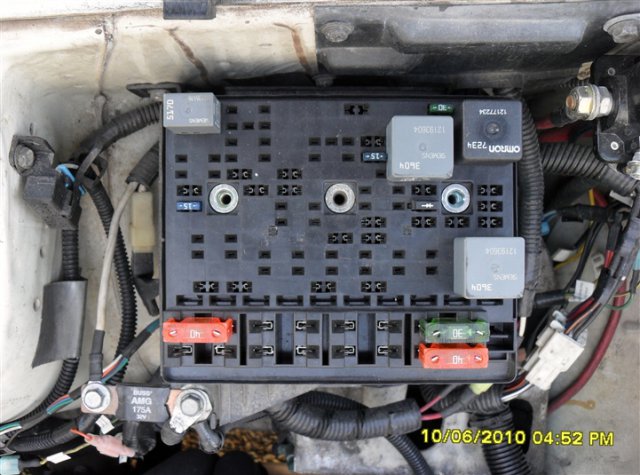

  5. I got rid of all my fusible links . I got a fuse box from Ebay ( 2000 Malibu ) . I now have extra fuse and relay holders for my futures add-ons . This is a S130 LS1 conversion .
