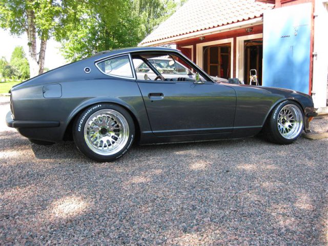

Soon finished! Arizona Z suspension, Design Products camberplates, CCW Classics 16x9,5 et-10, Silver Mine Motors Stage 4 front & rear brakes to mention some of the upgrades.

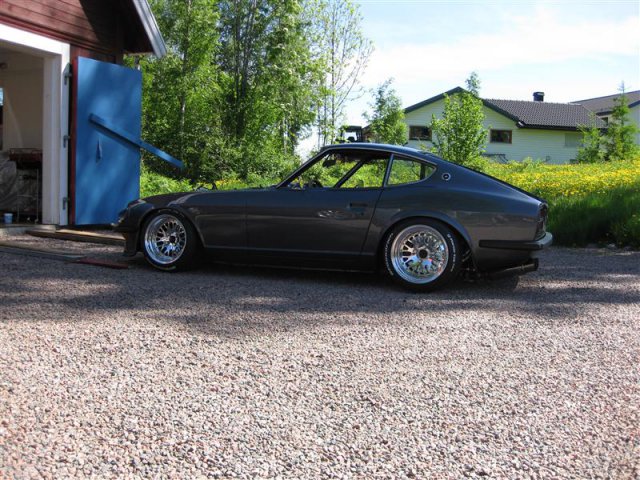

Thanks, I'm looking forward to have her finished too! Not much left, but it takes time since it's my first shell-up car project and money and time is scarse because of collegetimes. It should be ready in 3-4 months. I'll take that shot when I get home from the holidays, but it's completely flush on top. The bottom sticks out of course because of the negative camber. I've had my hours calculating and measuring to get that to fit;) -
HaaJeHaa replied to k3werra's topic in Brakes, Wheels, Suspension and Chassis

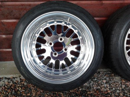

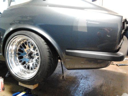

Can't wait to get my 280Z back on the road summer 2012;) CCW Classic 16x9,5 et -10 all around, 3,5" lip front, 4" lip rear. 225/45-16 BFGoodrich KDW2 tires. -3 degrees camber front and -1,5 rear. That's the widest and lowest offset possible you can go with no pulling or flaring of fenders and not having clearance issues, visacardfitment going on;) Just rolled the lip, camberplates and coilovers. The rims are completely flush with the fender. Going to mount AZcar LCA's to adjust the toe properly. -
Yep, your advice is great if he doesn't want to modify or running minor stretch. My setup clears the fenders when hitting bumps and you can get a visacard between tire/rim and fender. The track width decreases when you're that low and you can use that advantage to fit wide low offset wheels. It's not slam low, but usable DD low. See how it looks: http://forums.hybridz.org/index.php/topic/58528-wheel-show-post-your-pics-of-you-wheels/page__pid__973914__st__1460#entry973914
I've fitted 16x9,5 -10 with 225/45-16 street slicks under no flared fenders in the rear on my 280z. That's the lowest offset and widest you can go, look up willtheyfit.com for comparison with the 15x9. You need camber plates (running about -2 degrees in the rear), coilovers, stretched tires and rolled fenders. So yes, the 15x9 -10 will fit in the rear.

It's close to no clearance with the 16" ccw's. I guess it's up to how the inner barrel is designed. I've got a set of 16x9 -13 Watanabe and they seem to have better clearance than the CCW's. I guess casted 1 piece wheels have larger inner diameter than 3 piece...? My measurement is 173mm from hub center to top of caliper. That makes the total diameter 346mm and that equals to 13,63". If your inner barrels right behind the center (where the calipers will go) on the 15" is larger than that this kit would fit. -

Luseboy: You need a minimum of 16" wheels to fit this kit;) My 16x9,5 CCW classic barely clears this kit, the Rota RBR 17x9,5 clears it just fine.
