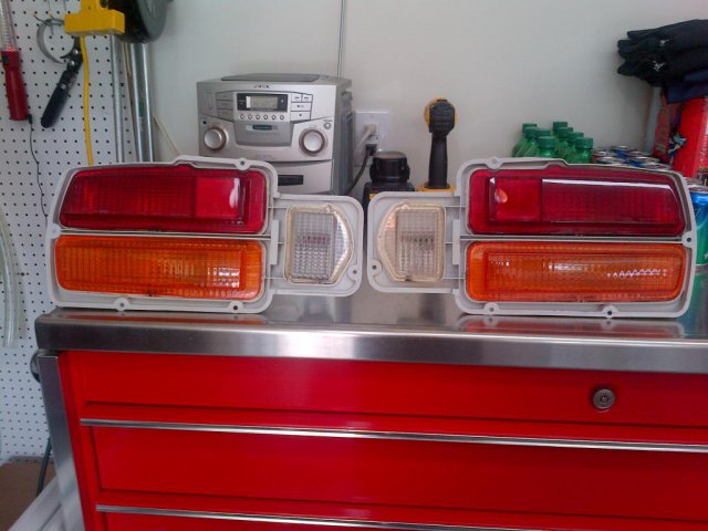

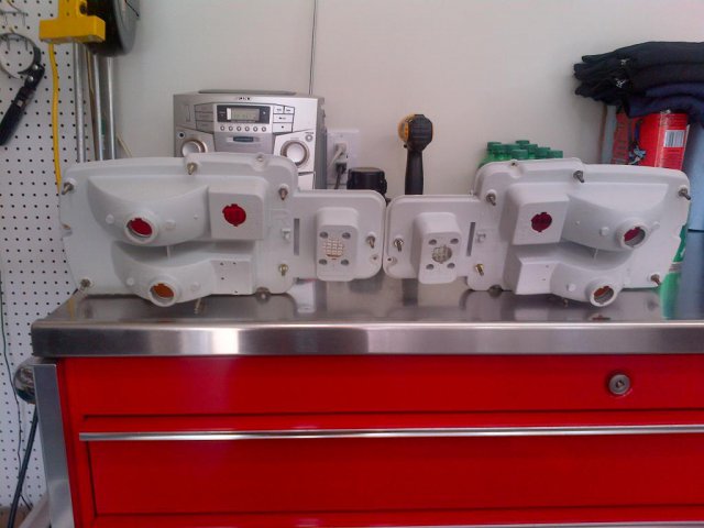

	That's right I recall him telling me that he is getting the transmission from Mast as well. I will PM you my contact info, I think you were going to meet up with Mike as well maybe we can all meet up since I live near Mike. Just received my tail lights this week as well. I had bought them on ebay a while back and sent them off to be restored. The pictures do not do them justice, they look brand new. Well worth the wait.

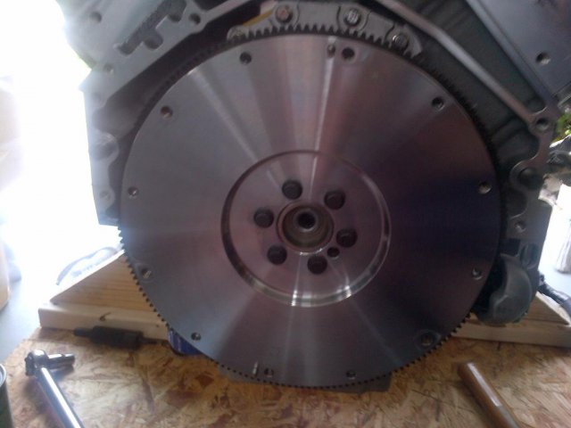

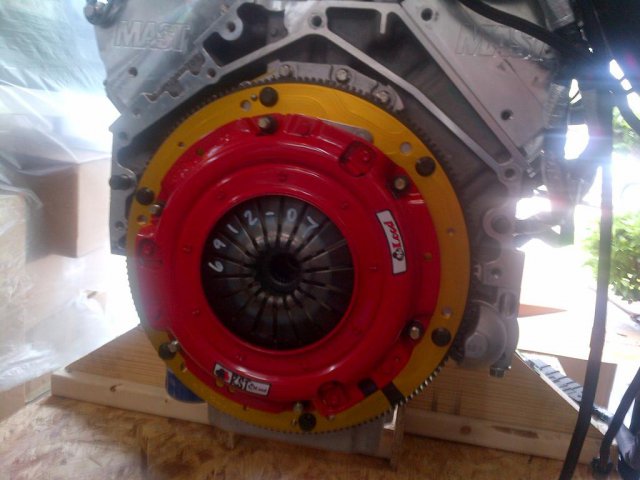

	Thank you Dan, An LS2 260Z build should be nice, not too many of those around. LOL... I know what you mean about the wife complaining, my project has headed a direction it was not intended to go money wise but it is one of those things that I'm too far into it to change gears. As for the transmission I personally think the first thing to consider is the purpose or intended use of the car and secondly it is all about personal preference. If you are building a drag racer then I would go with an auto but if you are building a street car to have fun in on the weekends then I would go manual. The shim goes behind the slave cylinder. There needs to be a gap of .125" to .200" between the bearing and clutch. If you have less clearance you need to call the clutch manufacturer and discuss it with them as that could cause premature clutch wear but if you have more than .200” than a shim must be added to reduce the spacing. In my case I had .365" gap therefore I fitted a .0180" shim. I have attached a diagram showing where the measurements are taken. Hope that helps. Clutch.pdf
	Got my motor from Mast. Very happy with the Dyno results. I could have gotten a few more hp but I asked Mast to build it for a 200hp shot of Nitrous, still 620hp NA is not bad. I was able to install the flywheel and clutch but could not fit the transmission because I need to add shims. I should be able to have it all together this weekend though depending on how hard I party on the 4th...... Dyno Results.pdf

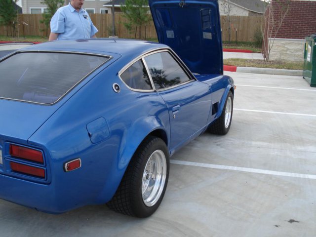

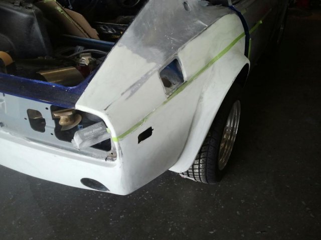

	Thank you, The fiberglass flares I had on the car were installed a very long time ago (maybe 20 years ago) and came from Jim Cook Racing. I'm not sure if they are still around. Those are the ones on the painted car. The ones that are on there now are made out of steel, and they are the ones primered. The body shop basically heated the quarter panels and shaped them into flares then added the necessary metal to make them wide enough. We decided to go this route because when they took the rear quarter panels down to bare metal the fiberglass flares were starting to come loose from the metal as well as rust was developing under them. We figured making them out of steel would be more durable (even though 20 years is not bad) and don’t have to worry about disbonding issues. I just asked them to get as close to the fiberglass flares as possible when they started making the steel ones because I liked the shape they were. Hope that helps.
