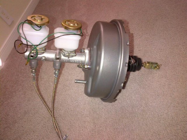

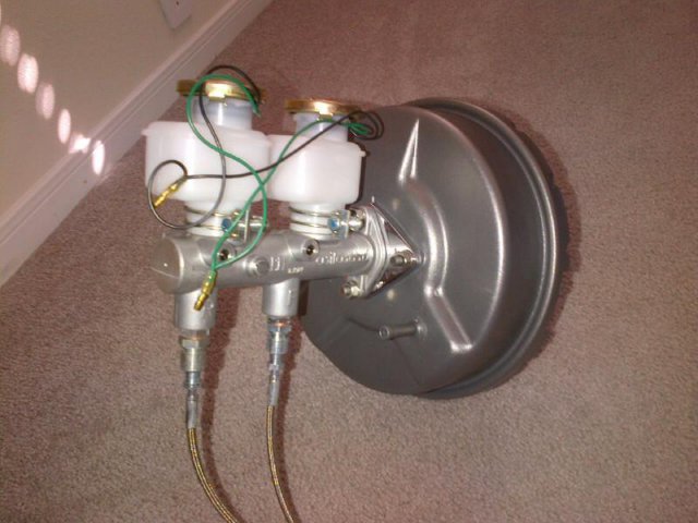

	Mike, it was very easy for me since I bought it already converted to fit an S30, the master cylinder modifications are done already and it bolts right in place of the old one. I bought it from www.datsunpartsllc.com. Good guys to deal with. Since you already have one I believe there is a thread in the brakes section on how to modify the 1" Wilwood MC to fit the S30.

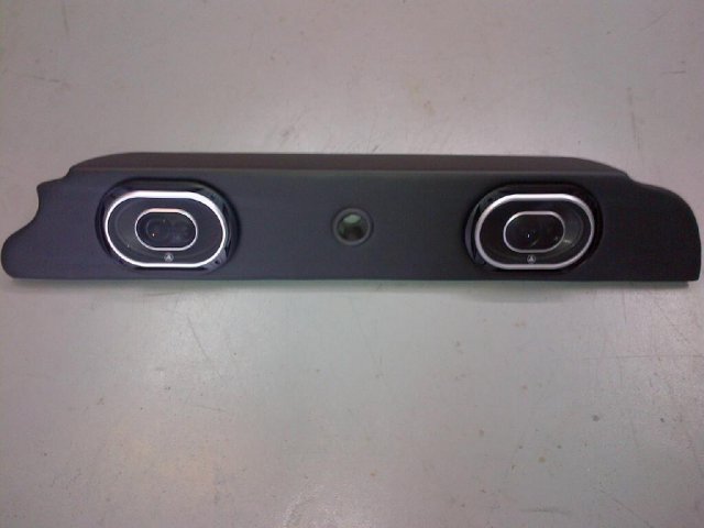

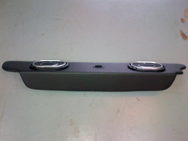

	I just picked up my leather wrapped rear speaker panel from the upholstery shop and installed the 6X9 JL audio speakers. Not much progress as I'm running out of things I can do without the car body. I just got a email from Tick Performance stating that my transmission shipped out yesterday. Will post pics when it arrives.

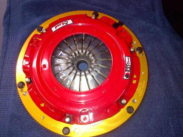

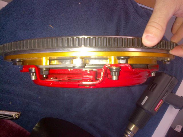

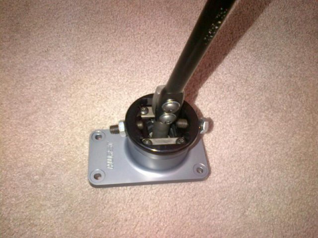

	Got my twin disc clutch and Hurst adjustable shifter from Tick Performance. I like the quality and I hope it works just as good as it looks. I decided to go with the McLeod RST twin disc set up with their steel flywheel as it is supposed to be very street friendly and good to 800 ft/lbs. It took a little longer than usual to get it because I had McLeod balance the clutch and flywheel together. No hurry anyways since I have not even ordered the motor yet and my car still a couple of months from being back from the bodyshop. I also got the 1" Wilwood brake master cylinder fitted to the brake booster.

	Thanks for all the input guys. I have decided to go with the Mcleod RST twin disc set up instead of the LS9. Seems like a lot of people are using it and it works well for what I'm looking to use it for. I was never too crazy about the spacer idea.
	My car will not put down anywhere near 900RWTQ. I'm expecting around 525 on motor and 650 on the gas. The reason I went with that transmission is that I don't have a T56 core to send in and have rebuilt. It appears the cores are now between $1,500 to $2,000 plus a stage 2 build at Tick Performance is around $1,400 without all the extras I'm having done like podwer coated case, new slave cylinder etc.. I just decided for a $1,000 more I can have something brand new that even the Viper spec T56 can't touch. Also I had a 6060 and it shifts so much better than the T56. As for the driveshaft, I may replace it depending how the JCI one does. I looked at Monster clutches as well but my experience with them is that they are awesome on the track but not very street friendly. I'm now thinking about a Mcleod or Spec twin discs set up but open to suggestions as well.
	Any suggestions on a twin disk that has good street manners? I have been all over LS1 tech but some of those guys are all over the place on what they think works well. I just don’t want any chattering or noise coming from it. I hope the drive shaft holds up, I wont be doing any drag racing at the track. just running around on the street but if it breaks I will just have to have one built that will take the extra torque.
	In that case I may need to consider another clutch. I just want a twin disc that does not chatter or make noise at idle. I have the same car as Joe (rags) and if says it might be tight I may need to go another route.
