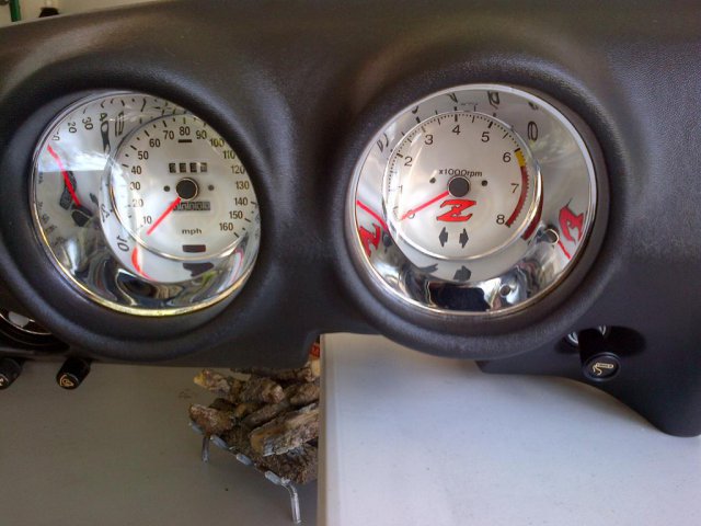

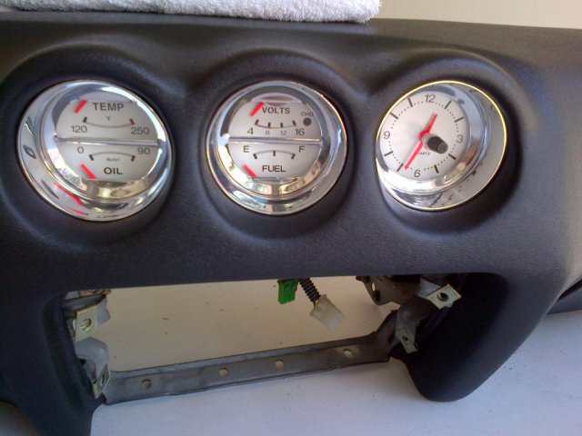

  6. Thanks guys, they were kind of expensive. I could have bought new aftermarket gauges for the price of restoring these but I always liked the S30 dash and gauges and wanted to keep the original ones. Chroming the plactic was a PITA. Post some pics of your lights when you get done please, would love to see them.
  7. Just got my front hubs back from powder coating this morning. Fitted new bearings and seals as well as ARP studs then mounted the Arizona Z 13" front rotor. That thing is massive compared to the stock one.
  8. I will just post it here in case someone else may need it, hope that's ok. APT Instruments 952-881-7095. They specialize in restoring all kinds of gauges and clocks. I had them do mine with a white face and orange needles. It's all hand painted and the wrokmanship its outstanding. Here are pictures of how mine turned out.
  9. If it does not work out let me know and I can give you the info of where I had all my factory gauges restored including the clock.

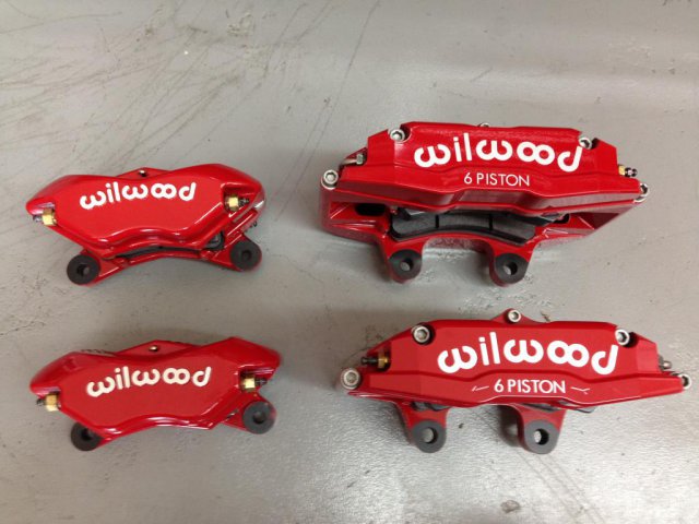

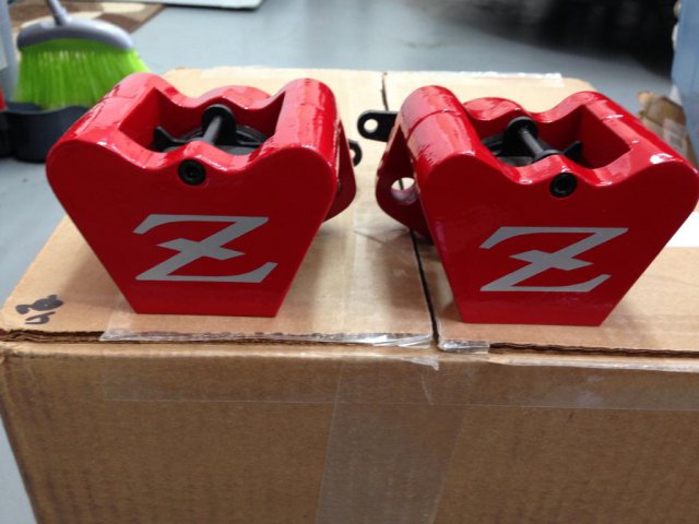

  10. Thanks Mike, At least we are now making progress. Just got my calipers back from being custom painted. I did not care for the black calipers.

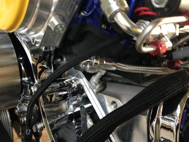

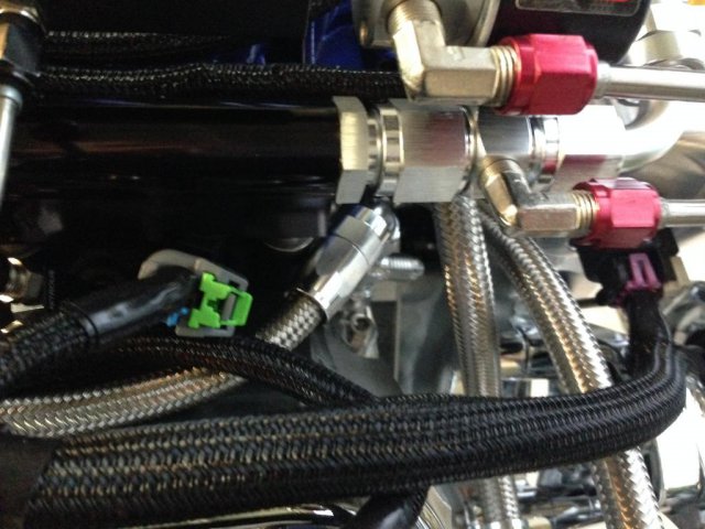

  16. While my car is getting the royal treatment at this new body shop I decided to upgrade the fuel delivery to my motor. Changed all fuel rail fittings from AN6 to AN8 as well as the crossover line. Also fitted an oil catch can as well as tied in all 4 steam vents on the heads, I will have to connect them directly to the highest point in the radiator. Darn braided lines and fittings are starting to add up.

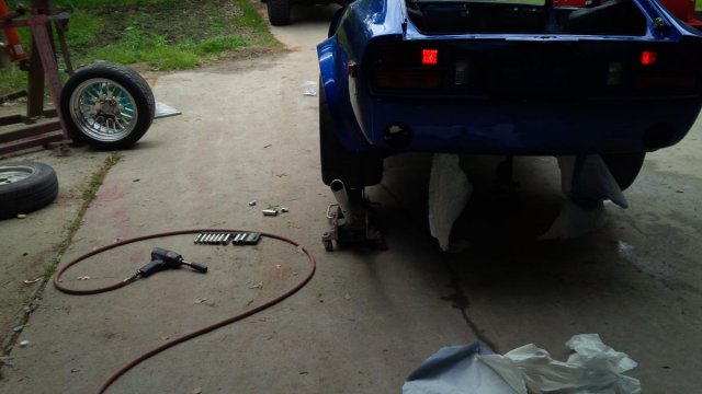

  20. LOL... Actually that's not my jack, the picture was taken at the body shop that is re-doing my engine bay. Chrome floor jack, ummmmm you may have something there though. Thanks for the compliment, I can't wait to start putting it together.

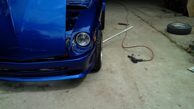

  21. Thanks to thezguy for letting me use his wheels to see how they would fit on my car. It looks like I may be able to get 12” wide wheels in the back but have to go to 8” in the front. The rear ones in this picture are 11” and I still have some more room left. The fronts are 9.5” and stick out 1.5” past my fender.
