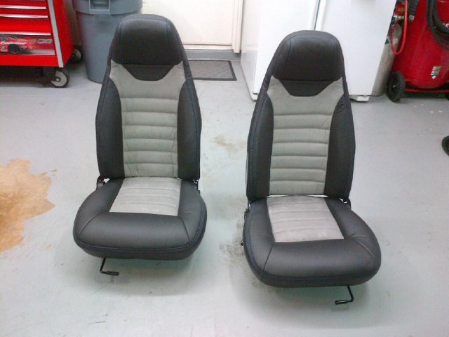

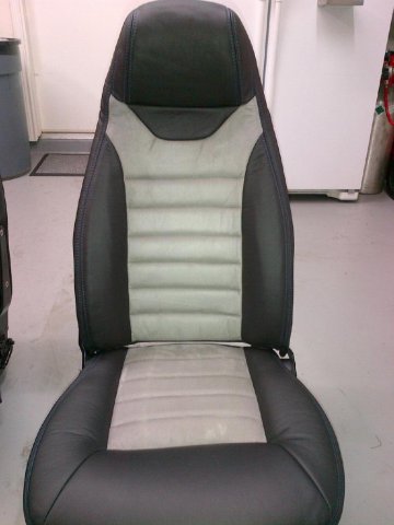

	Since most Z owners change their seats I decided to do something different and redo my original seat in leather and suede. Extra padding was added and they are actually very comfortable.

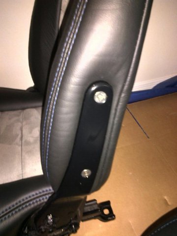

	Still not much progess, Just got the seats back from the upholstery shop. Used blue double stitching to match the color of the car. I had the seat brackets sand blasted and painted at the body shop working on my car. Replaced all the hardware with stainless bolts. I just love the smell a leather, not bad for 34 year old seats.

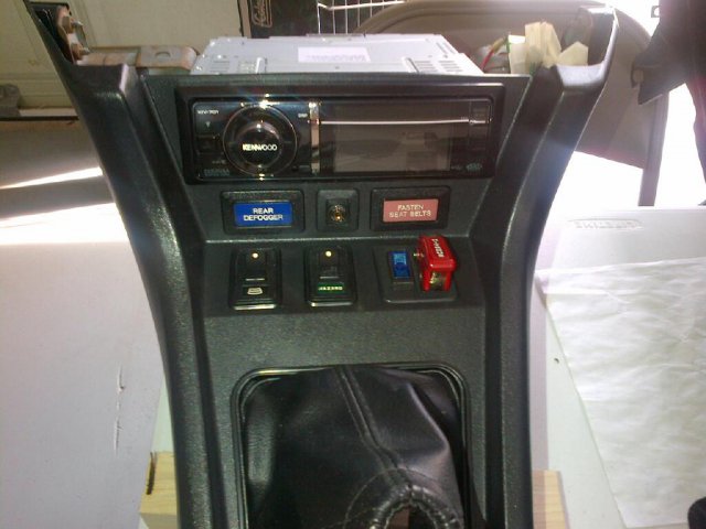

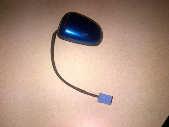

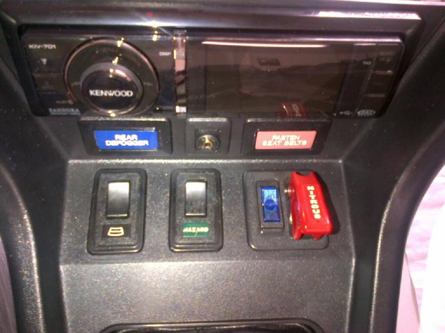

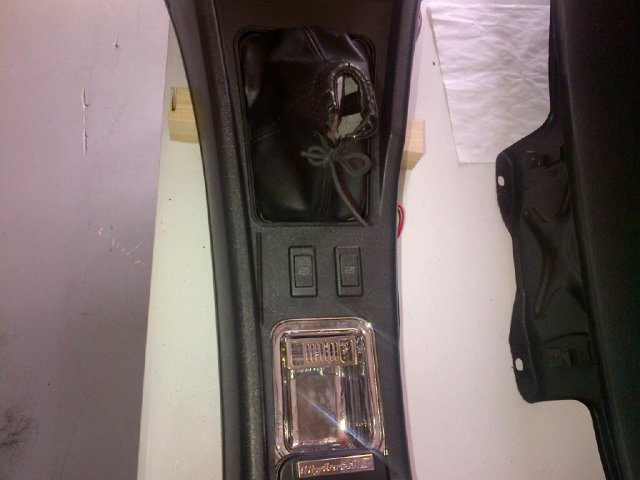

	Installed a new Kenwood head unit with 3 inch screen for video viewing and back up camera option to the new center console I just received. Also fitted an Aux audio port and Nitrous enable swith. Installed both power window switches along with the chrome ashtray and Hybrid Z logo chromed ashtray handle. Waiting on Ipod interface cable and XM radio antenna coversion cable to use with the 2010 Corolla XM antenna I will be installing on the car. Not much progress but it's something. Looks like I may get the car back from paint in Feb. 2013, that will be one year since I dropped it off.

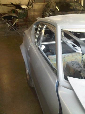

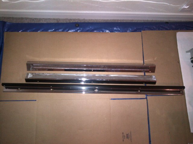

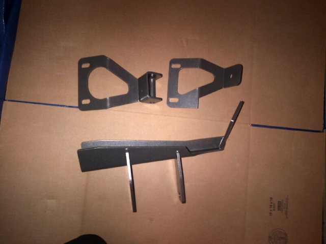

	I can't say I have made tons of progress in fact things are moving rather slow. The body shop has been working on the car and I hear it is now primed and almost ready for paint. I will go by there tomorrow to take a look at their progress and take some pictures. In the meantime I have been ordering some of the parts I need to complete my interior. The motor mounts made it back from powder coating, I also received the door sill plates and trunk divider from the chrome plater and last but not least I received my 6 channel 600 watt JL Audio amp along with the four 6X9" and two 6.5" speakers I will be running.

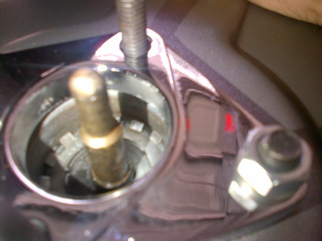

	You maybe right but I think I'm going to need the larger booster since I'm running the larger master cylinder and Wilwoods front and rear. It should not be that bad, I have determined that I will have to shave 2.8 mm from the spacer to give me a 3 mm clerance. That should not be a big deal, a local machine shop should be able to handle that with no problems.
	My push rod is not adjustable for some odd reason and it's about 4mm too short. I'm thinking about taking the spacer between the master cylinder and the booster and have it milled to make up the difference. I would replace the booster but it's brand new and I had it powder coated already. Any other ideas would be greatly appreciated.

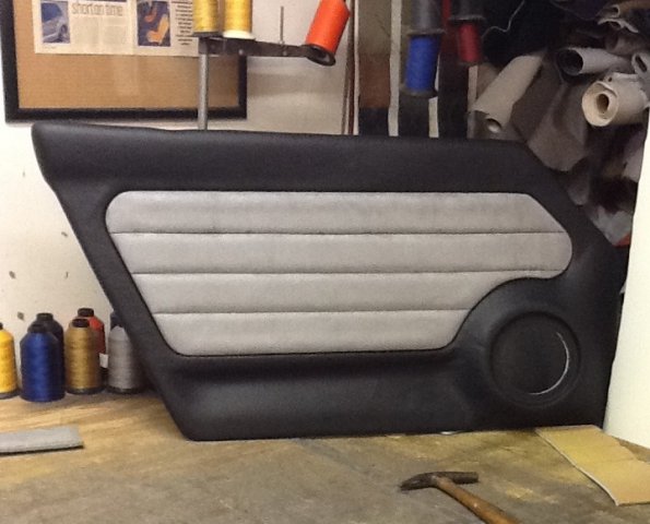

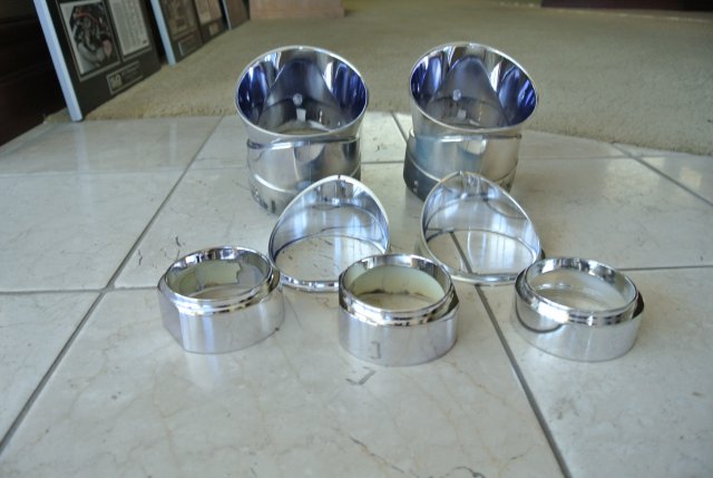

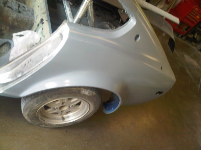

	Well after a couple of months we are making progress again. I got my plastic gauge pods chrome plated and all the metal trim that goes in the small gauges chrome plated as well. The gauges are being fully restored and the faces painted in white. It will be another 12 weeks before I see those. The car is now partly in primer but coming along really well. The body is now straight as can be. These guys are awesome in the work they do and the materias they use. My door panels are now finished and they are starting on the seats. Still going with the black leather and suede inserts. My budget is blown for sure now.
