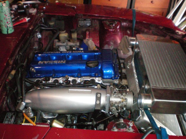

  16. Hey everyone, i've been messing around with my sr20det in my z for a while and I am starting to get bummed out Becuase it seems to be one problem after another. this was my first ever build so i had a few set backs. first got the motor and found out it was toast, then i decided to rebuild it. that took almost a year to do( was in school with no job ) got it put back together, then got it installed and sent it to Vildini Motorsports to get the wiring done and some other goodies done to it.( Those guys Rock!!!!) I had installed a used metal head gasket with out spraying it with copper spray, they let me know that it was leaking, so i bought a new metal headgasket and installed it( this time with copper spray) well i got the motor running and it hits really hard when you accelerate and seems to run nice but the problem i noticed is that when i open the valve cover cap when the engine is idling it puts out alot of blow by( puffs out air and a little smoke) it doesnt put out any smoke out of the exhuast so im not sure what the problem is. I did do a compression test and i got: 1. 170psi 2. 165psi 3. 165psi 4. 165psi Im really bummed out, any help will really be appreciated. thanks guys

  20. hehehe good to know i was able to answer your question. BTW here are some pics of my sr20 if ya want any ideas. I actually got the top mount idea from Alex and Adrian from Vildini Motorsports, they did a great job on my swap.
  21. "Sr20DET compression should be around 170psi (highest) and 130ish/140ish as long as each cylinder is within 5% of each other". i found this on a nissan forum, here is the link. http://www.nissanforums.com/forced-induction-nitrous-oxide/4575-normal-compression-sr20det.html hope this helps
