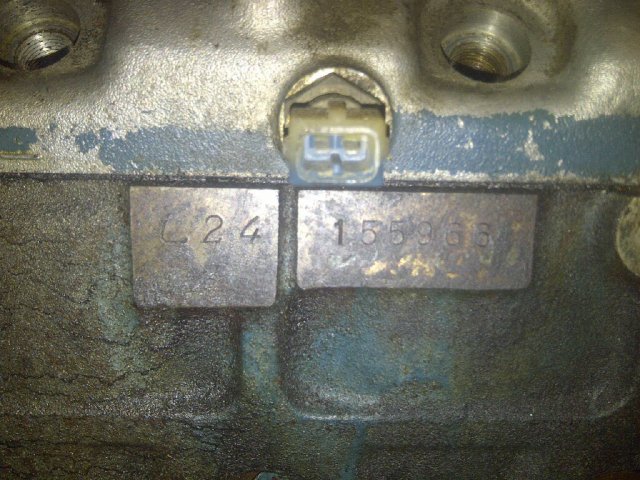

I can't easily get to the engine right now but the car was built in 2/73. Let me know if you want them and I'll clear things out of the way and get the serial number for you tonight. BTW, were is the serial number on the block? This one is so dirty that it's probably not going to be obvious.
I still have the original L24 from my '73 sitting in the garage and have been looking for a good excuse to get rid of it $125 + shipping.
