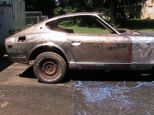

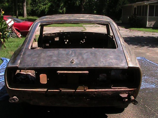

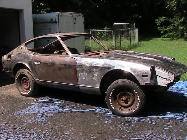

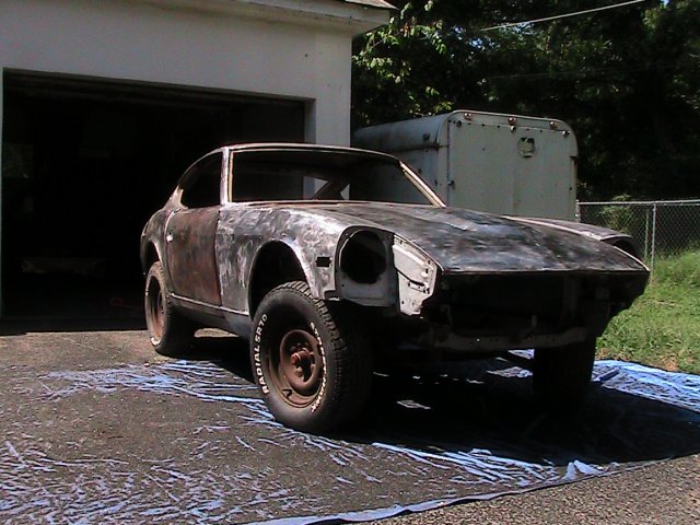

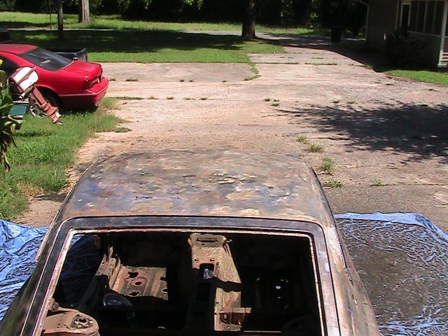

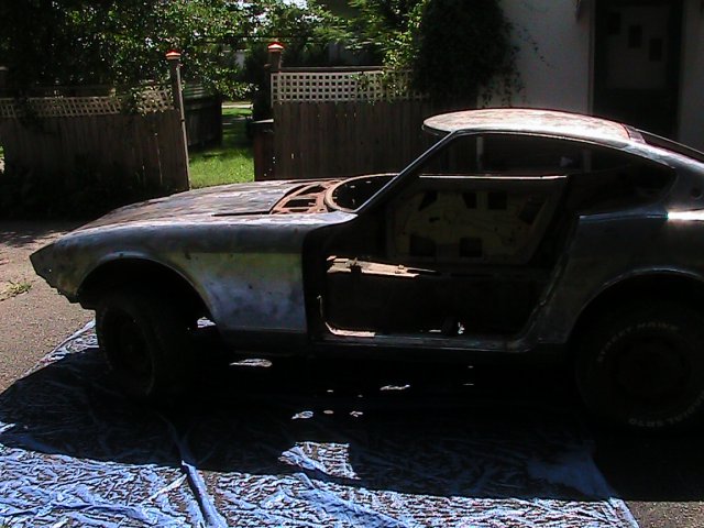

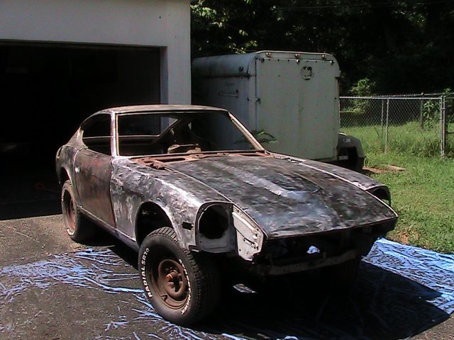

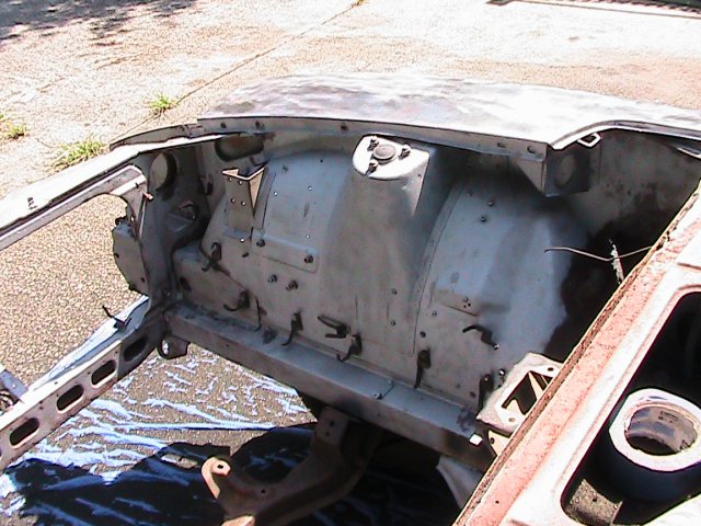

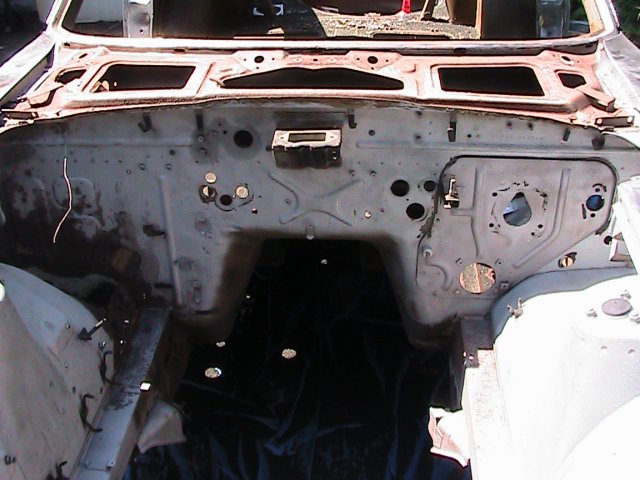

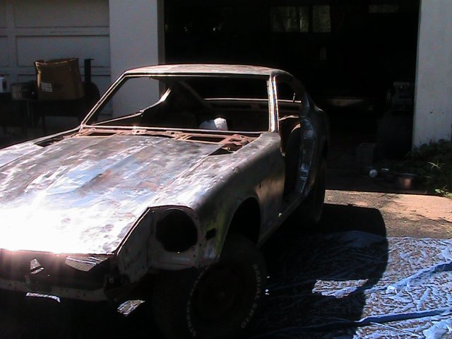

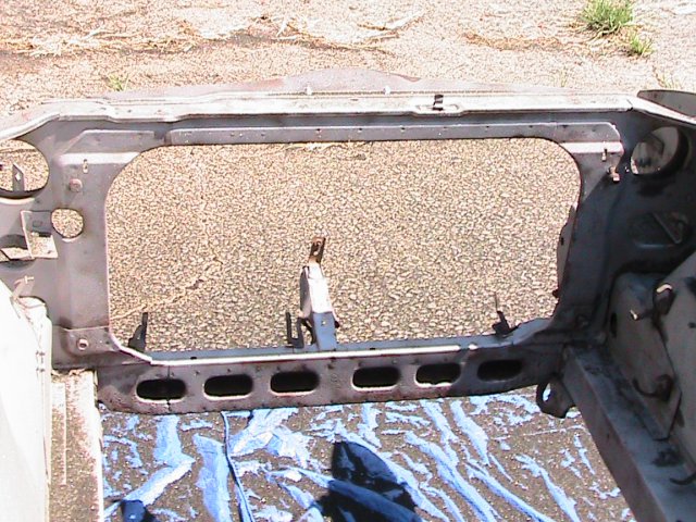

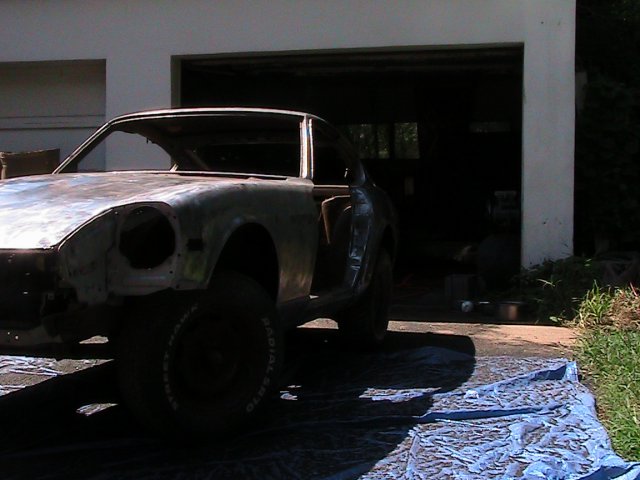

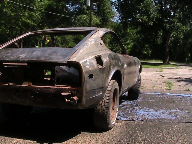

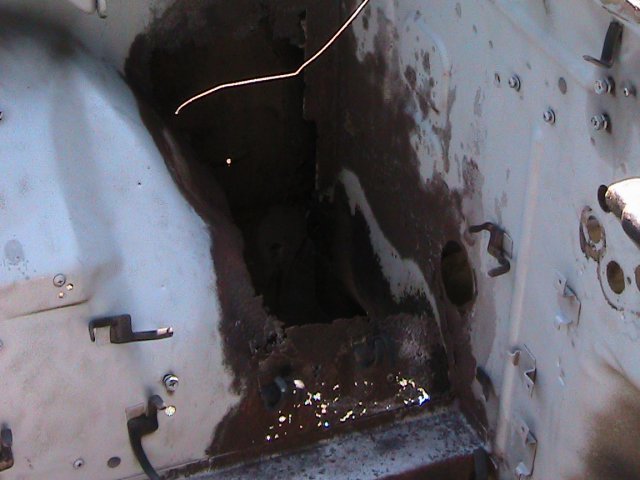

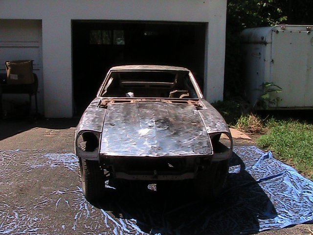

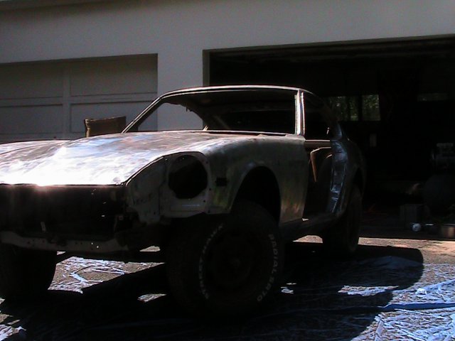

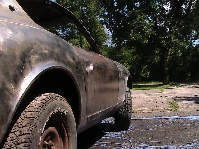

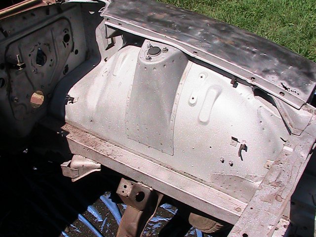

Ok, so I promised pics and here they are... the pics arent great quality but it gets the point across, I'm just about to start the phosphoric acid treatment and then palm sand with 80 grit one last time before cleaning with acetone and priming with epoxy!
so stripping, clean up any flash rust with orbital, phosphoric acid treatment, wash to nuetralize acid, clean any new flash rust with orbital and finally clean metal with acetone before applying epoxy primer... right steps or wrong steps??? thanks
