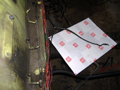

I am separating the engine wires from the harness that runs along the passenger side of the 240Z in prepartion for the SBC install. The black wire in question originally bolted to the back of the alternator. On page 9-2 of the JTR book (7th ed) it says to "cut the black wire (ground) where it attaches to the thick 12 ga black wire" The book doesn't say what to do with the thick 12 ga black wire. I assume that the thick 12 ga wire is a ground. Should the thick 12 ga black wire be grounded (bolted) to the body of the car? Thanks Miles

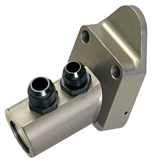

I am installing a MSD 8362 HEI on a GM crate engine. The MSD HEI distrbutor has a yellow tag that says to remove the stock oil bypass. How important is it to remove the oil bypass per MSD and will it have any negative consequnces if it is removed. Thanks Miles

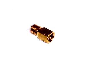

I found the Wilwood to metric adaptor at Flyin Miata. It is specifically made to fit the Wilwood proportioning valve: 1/8 -27 to 10mm x 1mm. p/n 14-76255 Link http://www.flyinmiata.com/index.php?deptid=&parentid=&stocknumber=14-76255
I am plumbing hard lines for a Wilwood proportioning valve (PV). The PV will be installed in the tool box behind the passenger seat. The easy way to connect the Datsun 10mm x 1mm brake line would be with a 1/8 NPT -27 to 10mm x 1mm adaptor that screws into the PV, but I can't find one here, Summit, local parts stores or local speed shops. The only solution seems to be going with a 1/8 NPT -27 to AN -3 male to AN -3 to 10mm x 1mm adaptor which results in an ugly stack up of parts. Does anyone make a 1/8 NPT -27 to 10mm x 1mm inverted flare adaptor?

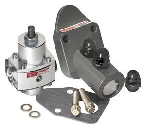

I came across a compact mechnical fuel pump for SBC that may work with the MSA engine mounting kit. It is made by Professional Products "Powerflow" product line. Anyone familiar with this pump? http://www.professional-products.com/ Part number 10730 Miles
