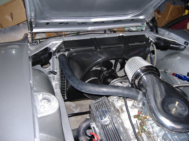

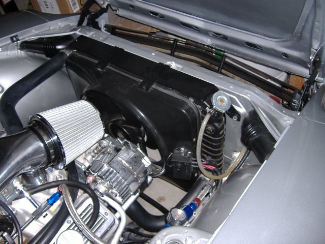

Bob's Z Twins The Summit radiator may be too wide to fit between the frame rails as it has a core width of 26.25 inches. The JTR radiator is 25.25 inches tank to tank which allows 1/8 inch clearance between the tanks and the frame rails on each side. I am using the JTR radiator with a Flex-A-Lite 180 3300 CFM fan, Edelbrock high flow water pump and a 3/4 inch flow restrictor in place of a thermostat. This confguration has worked through two summers. Most of the time I see temperatures around 180 -200 deg with my set up. See pictures below. Also, Motor sports Auto (MSA) claims that thier 240Z aluminum radiator will work with a V8 install, but the inlet and outlet appear to be configured for a 240Z so hosing may be a problem. Not sure who makes the MSA radiator, but it would be worth contacting them to see if they could custom build the 240Z radiator with the inlet and outlet configured for a SBC. Another possibility would be a Ron Davis custom radiator.
Tony Can you post some pictures of your dual fan set up?

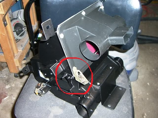

I just finished cleaning up my heater, but I am now missing the cable retaining clip that goes on the short cable on the left side of the box. See picture. Are these clips available?

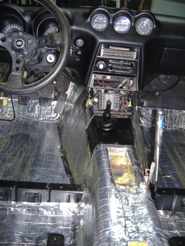

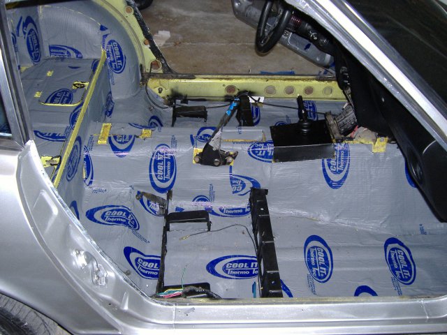

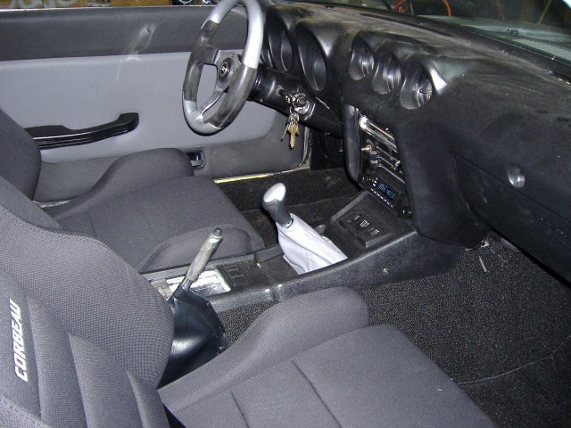

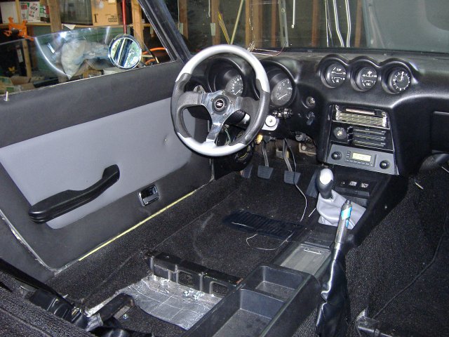

I did the whole floor, trans tunnel, riser, rear deck, wheel wells and quarter panels with a product like Dynamat and then covered that with 3/8" two sided aluminum insulating mat and finally carpet. Major reduction in heat and noise. See pics.
