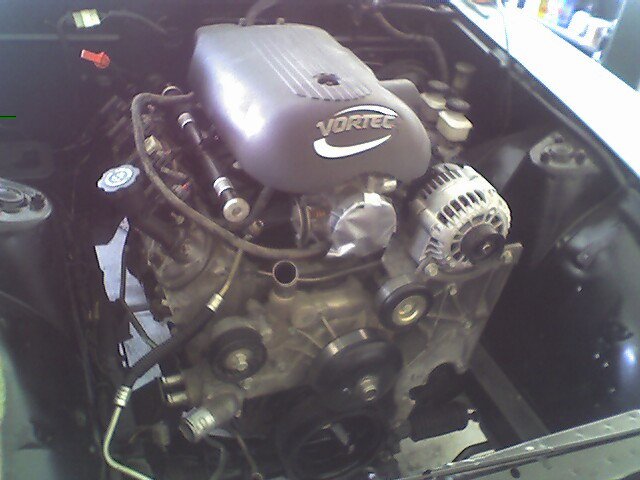

As promised, I have included some pictures of the exhaust intake, mod transmission cooler, the Datsun 240z floor shifter and some others. Tell me what you think. This may not be the best way to go but its a way to go.

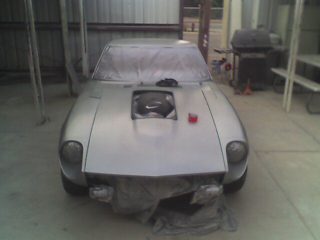

I understand. I perfered not to cut the hood. The other option was to use a LS1 intake and replace stuff. I am too lazy for that. Maybe one day I will, but for now it is what it is.

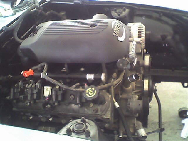

I am not saying you are wrong, but I used the exhaust intake from a 02 Camaro. I had to moditfy them, but they work fine. In fact, I like them alot. I amit it may not be the best way of going, but it worked for me. I will try to produce some pictures at some point. Live well and be strong. -

Here are some more pictures of my progress. As you can see, the 5.3 can be used as a conversion motor. Oh, BIG THANKS to Dan, he is truely the man, for all his help, I owe you BIG brother.

Thats not all together true. I am currently placing the 5.3 into my 240z. I agree you have to replace the oil pan and cut and put a hood scoop on the hood. On the plus side, it is a cheaper engine and tranny combo. On the less side the intake is much higher. Its rated at 285 hp in the truck but my car is much ligther with a 3.7 diff and running stright pipe, no converters, I should get over 300 hp. -

I understand but I am going to put a hood scoop on the car. Will keep upp updated with pictures. -

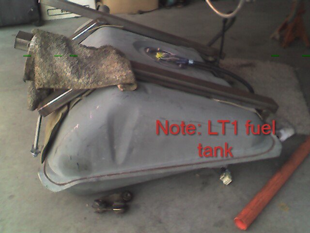

I have a 2002 v8 fuel injection motor and wondering what fuel filter to use. I am also using a LT1 gas tank. Need advise.

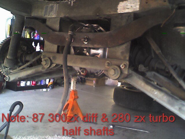

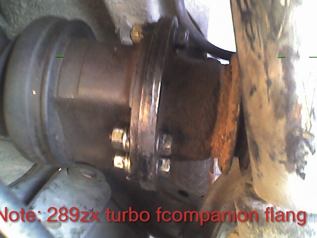

I have the diff and the half shafts (6 bolt holes patterr) from a 87 300zx. I am putting it into a 73 240z. the 240z has the 4 bolts half shafts. Will the 85 300zx half shafts work? I was told that they came with the 4 bolt pattern. Confused
