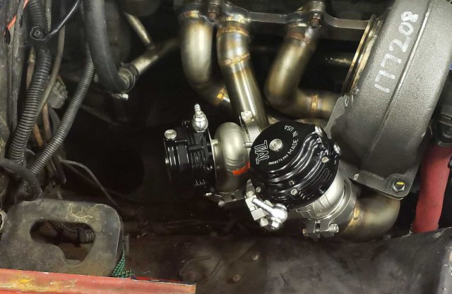

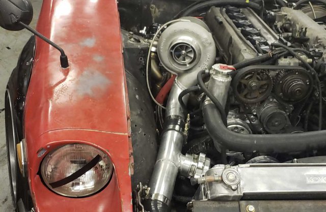

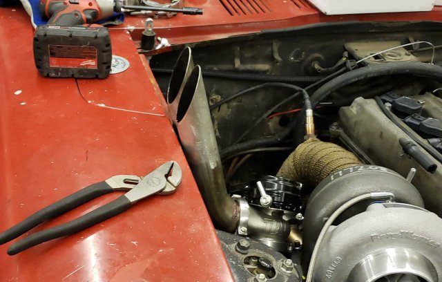

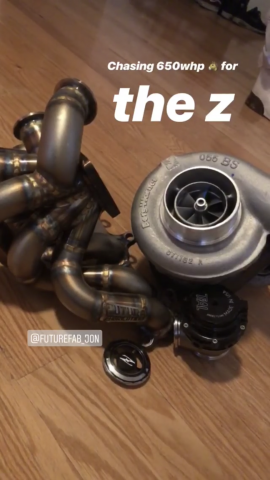

  5. So been a little slow with the upgrades. Was really on it and inspired for a little bit then ended up letting that flame die slow. But since it's somewhat warming up, im starting to feel it again. Few months back i decided to give the Z more power. Since the z was pretty much stockish, other than a FMIC, turbo elbow, and ECU. I decided to buy a few goodies, and piece together a turbo kit. -s366 borg warner 91 trim -future fab turbo manifold twin scroll -dual tial 44mm wastegates -Bosch 1000cc injectors The goal was to try and get really silly and make it to 650rwhp on e85 cams valve springs retainers all that jazz. But then i started to think about that much HP for what my end goal of the car would be. So with that said now im more looking at doing a more mid to high 400's / low 500's on 91. A few pics for a little teaser. Did some preventive as well. Headgasket, FM seal, cam seals, oil seal.... So much seal lol. Anyways Kinda looking forward to support these new mods before I hit the road again. Im in need of halfshafts and rubber...bad. Looking at doing the CV adapter upgrade from Driveshaft shop, or wolf creek.. Or maybe even the z31. As for rubber im really looking into the r888s 225/50/r15 (My specs are 15x10.5 all around -40 i believe) Anyways looked at a few rides with this set up. It'll be a very minimal stretch. Wasn't wanting to stretch tires, but also wasn't wanting that bubbled tire look. This guys on (See below) this is more practical. Ill probably end up running this guys rear all the way around maybe. Blue car is similar specs as the red car (225/50/15 front 235/50/15 rear) Panasport G7-C8S15x10 -40 Front15x11 -70 RearToyo Proxes R888225/50/15 Front 235/50/15 Rear But then there's this dude who is really running stretched r888's which i didn't know was possible until now. Sexy to me, but unpractical for what route im thinking of going. 15x9.5" -15 front, 15x11" -25 rear Volk Racing TE37V wheels; 195/50R15 front, 205/50R15 rear Toyo R888 tires

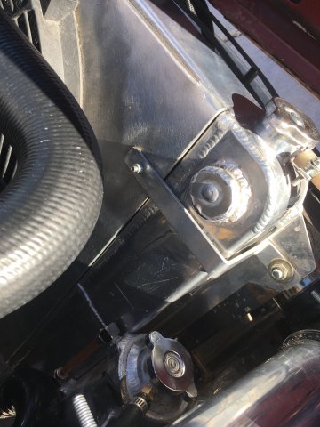

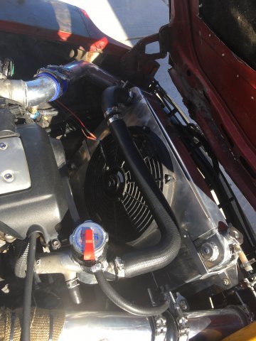

  14. Update** Sorry guys haven't posted in a little while, been somewhat busy with work. Anyways worked on the Z here and there and heres what I've done. Figured out my overheating issue, it was something dumb like i figured it would be. And I didn't figure it out until i was out of town of course lol. Basically radiators, for the most part come in from the top and trickle down to the bottom, which we all know. Come to find out our radiator, well my radiator is cross scroll. Meaning it flows from left (Inlet from engine) to right (outlet to engine) Didn't even know that were a thing. Anyways both my inlet/outlet were on the same side, so in theory it wasn't even acting as a radiator, more like a glorified surge tank. Ran into my wiring guy at the drift event this weekend, streetdriventour, and he said he know it was he cut it open and welded a divider plate in the middle to make it act as somewhat a hybrid top/bottom side scroll rad. lol Didn't really workout to well, so i had it welded and put back on the stock plenum. I had thought over buying a new one, but it worked perfectly fine with the stock L series so i kept it at that. Added a mishimoto oil cooler, now idle is about 170-Fish, and street driving is 185-200-F. I got a sandwich plate from suspicious garage, super easy install, basically removing your oil filter putting the sandwich plate in its place and screwing it back into the stock position. Also came with a oil thermostat that opens at 165F. I mounted the cooler to my front bumper, made some brackets and used muffler u clamps for support. It gave it a nice firm feel, doesn't move around is very secure. 10an fitting of course from summit. Made a shift bezel to take away in-cab heat, and cosmetic look. Used a rubber shift boot from a mazda miata 1994 i believe. And went to home depot for some sheet metal, cut accordingly to my liking and riveted the bezel on. I really wanted to reuse my stock center console, but with the shifter being so far back, or further back, and my hydraulic brake being right there. I thought against it, and sold it. Picked up some Takata harness' from a local. I got the pair really really cheap from a fellow Z enthusiast, Come to find out they are real, just expired, but made for a roadster, so they are also real short lol. The eyebolts for the wastestraps go into the old stock seatbelts, but the shoulder harnesses are way too short to hit the ground. Kinda pissed off for a second, but figured i would get a inch thick bar to be welded in the back to where i can put the eyebolts onto. A project for another time. Next proj will be 1" Willwood Master cylinder, 280z brake booster upgrade. My brake booster is failing, and I feel like my brakes should feel a lot better than they do. I remember i never upgraded from the stock MC. Like i said earlier, I drove the Z out to the speedway to watch some friends at the drift event. I got quite a bit of love out there, had seen someone post pics of the Z on instagram, and they gave me all the pics they took of it. Hope you guys enjoy. I kinda wish he got pics of the full car. actually just found another pic on IG. So just about ready to tune it, and i run into the next issue. lol fix one thing, another breaks..Its a vicious cycle. Anyways my wire in the #1 cylinder port is really finicky. Come to find out its got a hairline crack in it. So it'll run fine then when it wants to it'll run crappy. Did some reading on a few forums to see what others have done, and read this is a common issue for our motors. Did more research and read about the "wasted spark" system the jz series has. Meaning 3 coils feeding 3 wires. Found there are multiple options for both keeping it the same type of wasted spark system I.E 1jzz, or the super spark upgrade. On the other hand i could go to something like x6 coil setup. I.E Audi R8, or Lq9 from the Ls. First thought was to buy one wire from someone locally, or online just to get the car to tune. I figure if i change one i should change them all, so the lifespan is somewhat the same. If one is crapping out, then another is probably going to...atleast with my luck lol. Then thought about buying the superspark upgrade and paying for it once and done. But i've read in drift works sometimes they end up having the same issue. Also considered buying brand new for them, but for cheaper i could get the Ls series or R8 style. I really like how the Ls series sits outside of the plug tunnel and comes with its own ignitor, making the capability of running without the stock Jz ignitor. (read this can only be done with an aftermarket ECU, then again read elsewhere stock ECU is fine) so not sure what to believe there. A lot of guys are running the LQ9 coil pack enough to where there is a bit of info for the swap. Cx racing even makes a bracket for the new wires. I honestly have been leaning towards the R8 coil packs. Brand new you spend 172$ for the six and can be had at most part stores for around $20 - $30 new. Theres mixed reviews on this route, but most are good, even the rb26 gtr guys run this setup. My wiring guy gave me a great price on install, and also runs this setup on his. He said he really suggests this, and from remembering from an earlier post he mentioned switching out the coil packs before going to a bigger turbo system. Here's what I'm looking at, let me know what you guys think. https://www.ecstuning.com/b-genuine-volkswagen-audi-parts/ignition-coil-priced-each/06a905115d/ Filmed a vid to show you what the car sounds like at the moment, where my wideband is, and the faulty wire i talked about. I think this is the first vid i made with the GoPro i got at my company christmas party.

  17. Hot: as in norm is 180-210 degrees F, and I'm creeping passed the 230s. No oil in the coolant, and vice versa. Lean: Im in the higher side of the wideband while on throttle the few times I've driven it. I definitely know I'm not running rich, so its more of an assumption. My overflow reservoir is tubed out from the swirl pot, kinda tucked between the rad hosing and IC piping. Its definitely air tight, its sealed no leaks from anywhere, thinking its just a timing thing now. Thanks man, definitely was a better move upgrading to this setup. My bad yes its Nylon braided. Remember its almost to the bottom part of the car but not on the bottom.

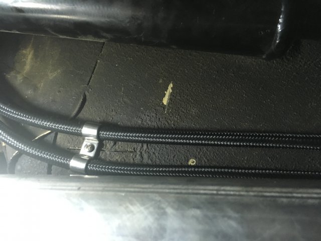

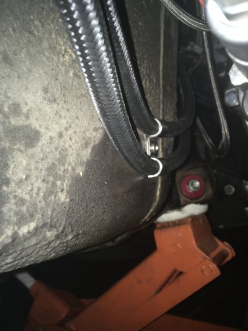

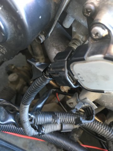

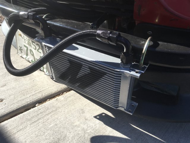

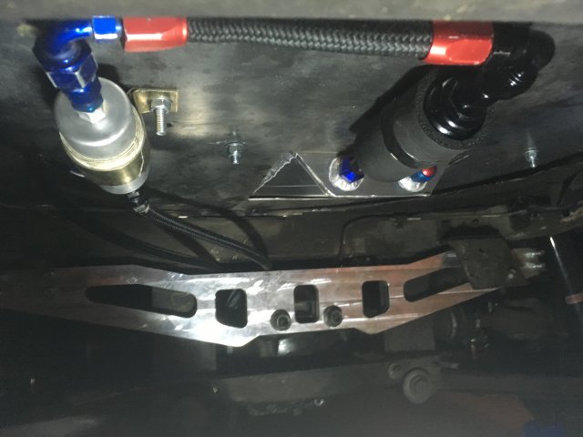

  18. Started to finish the hardlines then thought of the long run. Kinda got stuck with going to the stock hardline on the chassis to my hardlines..So after really thinking about it for a second, I switched to 8an fittings with 8an steel braided hoses. With that said I ran my lines to the driver side tranny tunnel of the car. My first plan was to remove the stock lines and run them the same route, but I thought against it and ran my lines elsewhere. I attached it to the bottom part of the tranny tunnel, pretty happy how it turned out. So my map wasn't the issue at all, it was actually the TPS (Throttle Position Sensor) the three wires that go into the sensor, there was one wire that wasn't getting a connection. After taking the sensor off and resodering the wire, it fired right up. Amazing what one wire could do. Car is up and running now. Im running a little hot tho, and a little lean... So i checked the cooling system, only had water in it. Switched over to the Zerex asian RED coolant (a lot of people swear by this so I checked it out.Burped the system. Still running hot. Remembered I never changed my therm. So i got the mishimoto one from driftmotion. Still running hot. I know for sure my timing is probably a little off. Gonna have my wiring buddy come over with his PC and check the ECU out. So i've kinda been cleaning up wiring a little bit, and small little knick Knacks here and there. Driving it around little bit it feels really really good, even untuned feels very strong. Ill be taking it back to the shop early next week. Side note sold my Daily today. A little bittersweet happy its gone but sucks to let it go. Couldn't stand how low it was. Anyways anybody running the T3 camber arms? I kinda wan those. Want to run some negative degrees in the rear. Just a little bit lol.

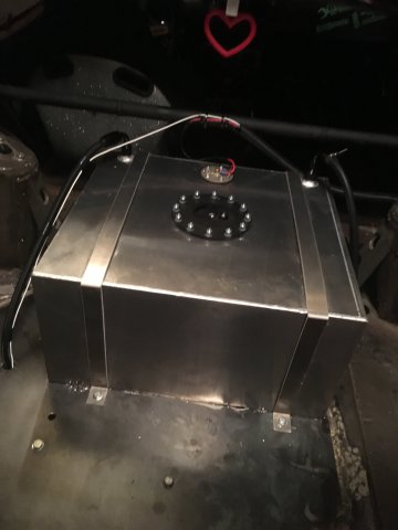

  20. I've seen a few people do this. I like the idea but i chose to go another route. Keeping the factory filler was the main thing that I wanted to do but thought against it, when it came to doing my fuel system. I rewired it prior to the swap to its own individual route. Just wasn't hooked up. I jumped it off the signal light on the OEM headlight switch.
  21. Hmm touche'. Didn't think about that. Figured the car would be too loud to hear the slosh and dribble. After the cars on, I can barely hear the fuel pump. This is why I need to get a full cage, and possibly a bash bar in the rear. Still waiting on the fuel straps.
