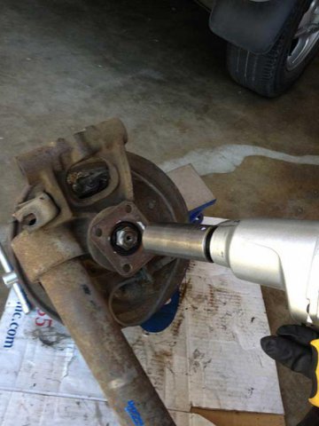

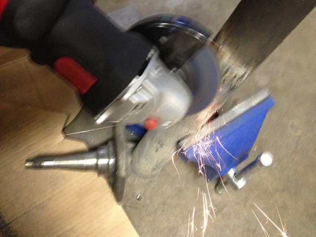

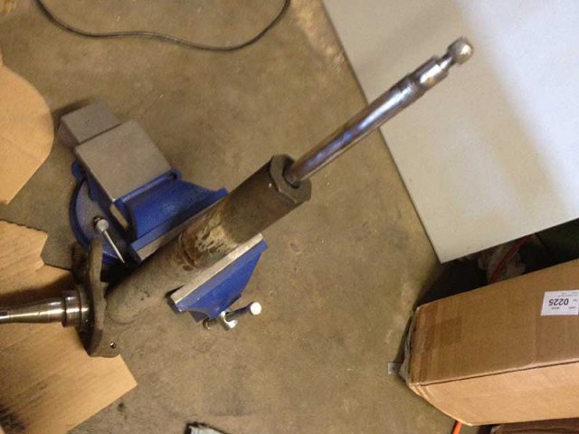

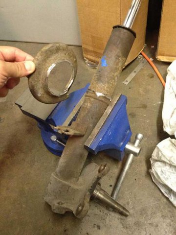

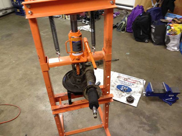

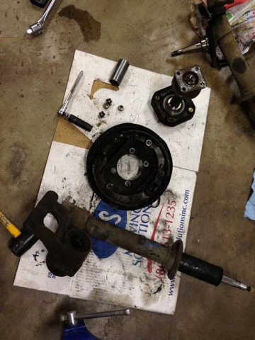

While waiting for the ring pin plier, I was working on coilover project. First of all, I try to cut the spring porch using grinder. It takes too much time and I replace disk to cutoff disk. Using right tool is saving so much time. However, I leave too much metal for grinder. It takes about one hour for grind off extra metal to smooth up just one of the strut. For rear strut, I still haven't remove the drum disk brake. In order to remove drum disk brake, I need to remove the Hub. When I read FSM and Blue's work, it sounds harder to remove the rear hub. http://www.atlanticz.ca/zclub/techtips/rearwheelbearings/index.html I read some other post from somewhere, using impact wrench is much easier to remove the nut. Grind the inner nut of hub and use impact wrench to remove. Then using 12t shop press from HFT, to push out the hub. So far so good for the strut modification. I decided to go coilover conversion uing Bilstein P30-0032 shock following thehelix112's instruction. I don't know whether GroundControl Coilover Conversion kit was available at the time when thehelix112 did his work. When I calculate the cost of the parts, it seems like it almost same with GC coilover kit. I wonder I can use GC's coilover kit with Bilstein P30-0032.- 230 replies

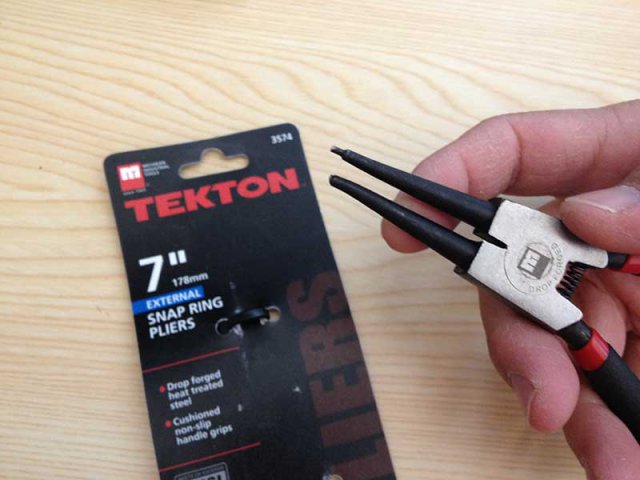

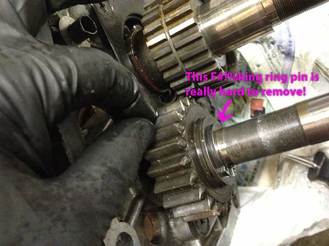

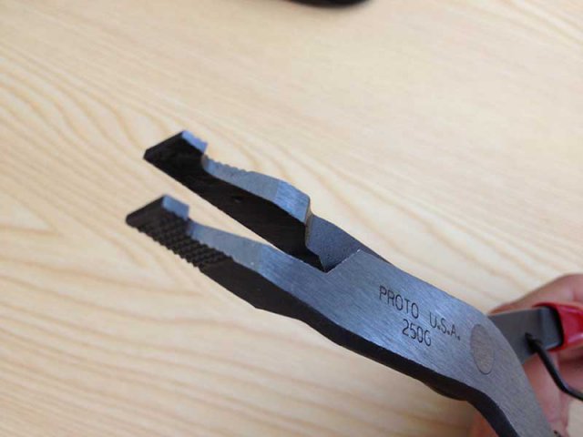

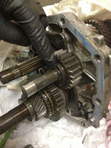

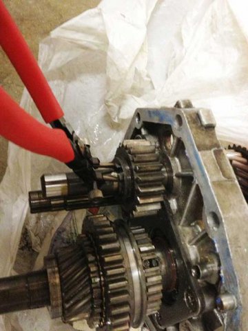

Fighting for ring pin removal from the reverse idler shaft. Waiting for 2 days, got new ring pin plier Tekton 3574 from amazon.com for $5.88 First try, it broke the tip! Cheap made in China product is not durable enough. I read again datsun garage website again and realized that the author recommend Stanley-Proto J250G lock ring plier. This ring plier is different design from regular ring pin plier. Sure, it is heavy duty construction and using slotted screwdriver to push, finally, I could've removed the ring pin!- 230 replies

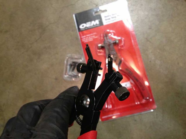

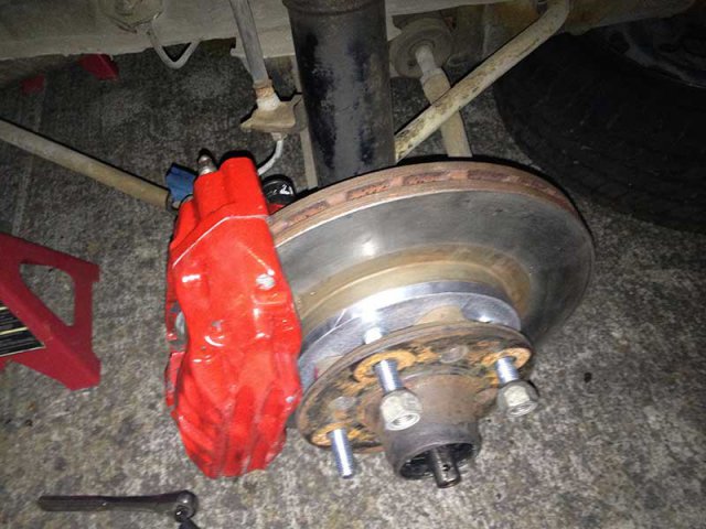

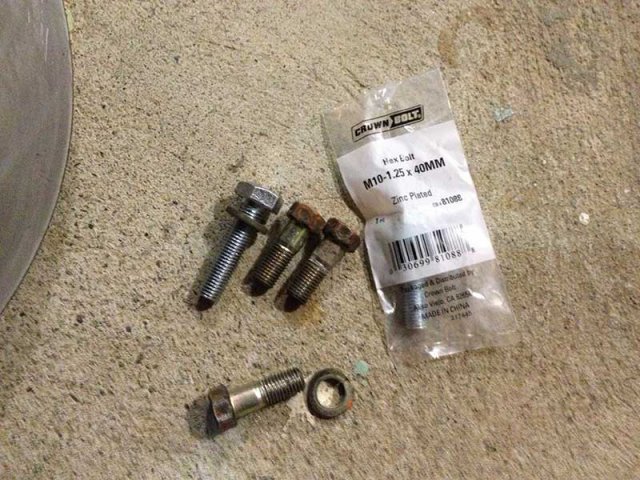

Thanks Leon, I will read over. Tonight progress... not so progress made. Got Stronger Clip Plier at Autozone. It has Internal / External combo with exchangeable tops. 2mm tops is looks promising durability However, it kept slipping with tranny oil and cannot grab the clip... For brake rotor with spacer, I bought M10x1.25 40mm bolts at OSH. This bolt is the best size to fit slotted rotor with 9mm spacer to hub.- 230 replies

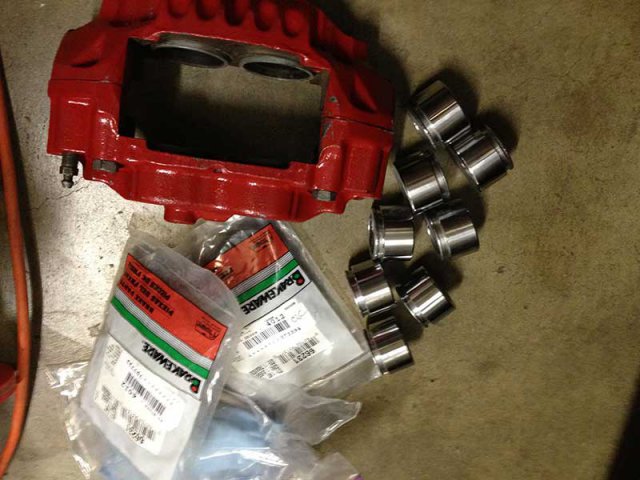

I have S12W with brand new rebuild kits for $80+shipping. Caliper is sandblasted and painted with Dupli color caliper paint. http://www.pirate4x4.com/forum/toyota-truck-4runner/770289-caliper-rebuild-tech-not-dial-up-friendly.html The right side of the caliper paint get dirty due to stuck piston removal. Now, all the 4 pistons are polished and ready to install condition. Let me know if you want this.

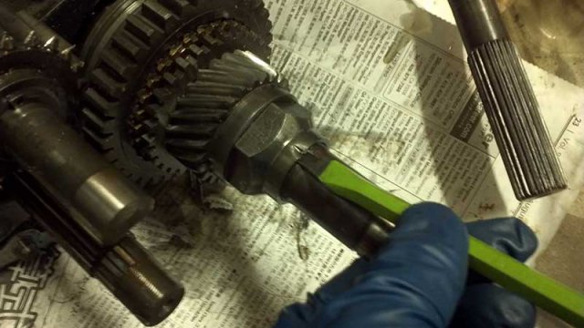

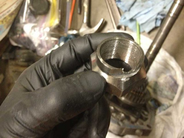

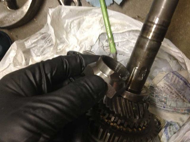

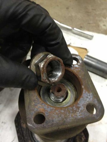

Victory! After grinding nuts, finally I could've remove the nuts from mainshaft! Next target is this snap ring. This snap ring is so strong, I broke many cheap HFT snap ring pliers. I have to find strong one somewhere...- 230 replies

Thanks for your advice! Spitz17 for your offer! I really appreciate that! I will let you know once ready to drop tranny. Based on Leon and Spitz17's recommendation I would like to change clutch too. I have brand new OEM 240z clutch bought @ ebay long time ago. Do you think I can use it for 280z or do you have any recommendation? Some people said Exedy is good, other people said ACT is good one. For mainly street use, I don't know what is the better option. I think this is the great opportunity to swap transmission from 4 speed to 5 speed too. I was working on rebuilding 280zx tranny but encounter issue for removing nut from mainshaft and stopped.... I grinded tools to try to bend the nuts, but I think should grind the nut itself. I should re-prioritize and finish rebuilding tranny first at this time to move forward my project.- 230 replies

Thanks for the information. I will check out local ACE and OSH. I heard rear s30 stud is 40mm where Quest stud is 45mm. http://forums.hybridz.org/topic/97317-extended-wheel-studs/?p=914442 Anyway, removing stud from rear extremely painful (I need to remove rear hub too.) and I already got Quest Studs. Yes, you are right. The thickness of the rotor hub is 3/8" for 280z. I exchange my 240z version spacers with member in this forum since I sold my 240z and got 280z. 280z = .375" = 3/8" (280z hubs only) 240z = .5" = 1/2" (240z hubs only) http://forums.hybridz.org/topic/88620-toyota-4-piston-caliper-spacer-size/?p=841786 Thanks, tamo3
I Slivermine brake spacer for slotted rotor with Toyota 4x4 conversion. Also I got Quest Studs. Part number at napa was 6412785 for 83-89 Nissan Quest Rear Studs. Now I need longer bolts to connect rotor and hub since I put spacer. Does anyone know where can I get that? Longer version of Part #23 http://www.carpartsmanual.com/datsunS30/DatsunZIndex/Axle/FrontAxle/tabid/1728/Default.aspx http://forums.hybridz.org/topic/63877-big-brake-kits-240z-260z-280z/ Thanks, tamo3
