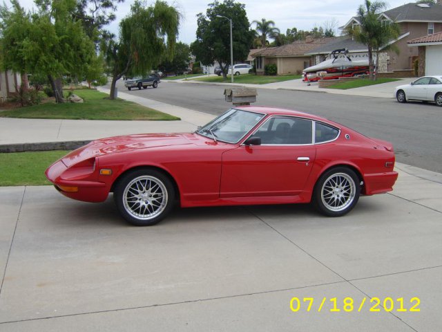

I have almost finished with a cosmetic restore. I've owned this 240Z for 42 years. It's looking good but is SLOW. I've thought about an L28 and checked Rebello. Great power but lots of $$$. The shop that helped with some of the restore really want to do a Chevy LS swap. The budget would be around $10,000. The car would be a screamer...no doubt but I wonder if it will still "feel" like my 240Z. I had an experience back in the late 70's with a friend that put a 327 Chevy into a BMW 3. coupe. It was fast but no longer a BMW. It felt like it was going to fly apart everytime you got on i. To answer you let me say I'm still fishing. The appeal of the smaller high reving v-6 is greast. The Chevy seems like a lot of info. Bones (the shop) has had a lot of experience swapping LS motors into other cars (An AMC pacer was the strangest) but he is not as familiar with the Z. If (and it is a big if) a later Nissan V-6 will bolt up to my tranny well that wold save me a lot of work. I really appreciate your feedback thanks a lot. I'm adding a photo .
I searched vg vq swap but got nothing . The reason I thought this might be easier than the LS swap is all the mods that seem necessary for the ls. DRive line, rear end, half shafts and different oil pans, headers and just a lot of things that would disappear if the later Nissan v-6 will mate with my 78 280Z trans. I want more power but don't need 400hp. I appreciate the feedback. Thanks.

Here are a few shots of my "work in progress". I've owned it since it was new....42 years and still working on it. LOL

These are the Konig 17" wheel from MSA. They fit the stock body (no flares needed) and don't hit anything. 225/45 17 tires -
