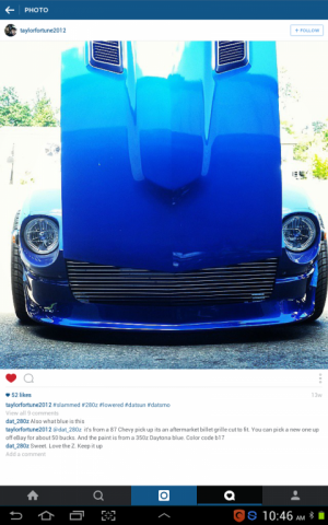

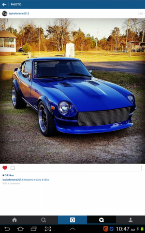

  15. when i come back from the trip i definietly want to install this mod considering my stock 280z grill is bend and not straight at all
  16. the are not perfectly straight. there is a bend ih the middle
  17. i was also wondering about this until i found this guy on instagram who done his grill that looked sweet. he said to basically buy a 1987 chevy pickup grill on ebay for like 60 bucks and cut it to fit. http://www.ebay.com/itm/81-87-Chevy-GMC-Pickup-Suburban-Blazer-Jimmy-Phantom-Black-Billet-Grille-Grill-/200782905571 here are some photos http://forums.hybridz.org/uploads/post-27427-0-23201400-1438527032.png http://forums.hybridz.org/uploads/post-27427-0-93140700-1438527141.png
