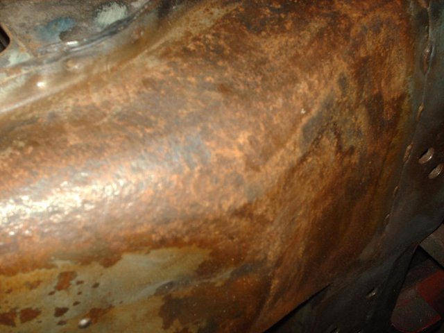

That's after the wire wheel. With some residue left behind from the chemical stripper. Should I take a flapper disk to it and prime it or just throw some rust converter at it?

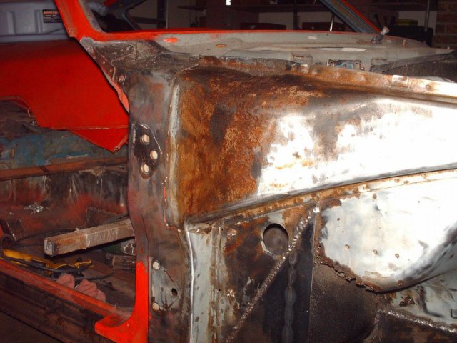

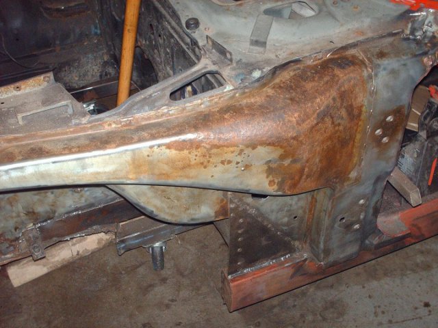

I've been doing a lot of stripping on the weekends lately and I want to get people's opinions on what I should do about the rust on my front frame horns. It looks to be a little more than just surface rust but I can tap all around it with a screwdriver and it all sounds solid.

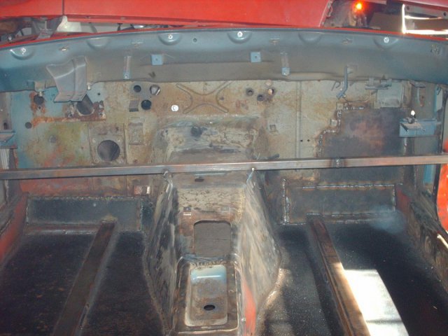

Here's an update. For the past few weeks I've been busy stripping the front end to make plans for the new rails up front, but here's how the floors ended up. Not perfect but I'm happy with it. I haven't fabricated the new buckets for the seat belt retractor yet so no new photo of that end.
