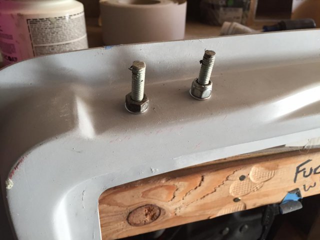

Excuse the shotty hardware...had to go through the scrap bin at the new shop. Rear window is a lexan one provided by Benchmark with hardware/straps. Overall very impressed with the quality the hatch. There was a couple of waves that required a few hours of work, but I'm sure that's to be expected with most FG parts.

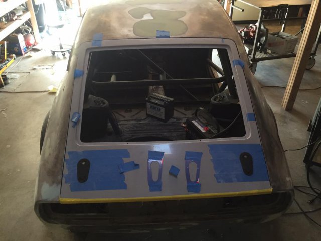

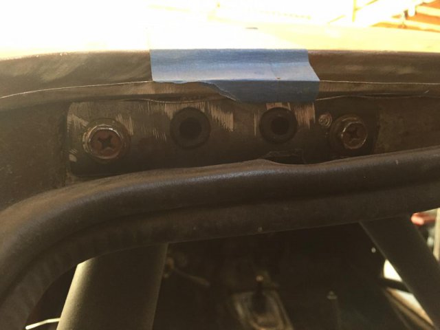

Followed Tube's suggestion. Turned out well and lined up decent enough with a bit of weather stripping. Two 1/4 pins on each side using nutserts. Used the existing brackets for the aerocatch rods and added my own ugly brackets/welds to stiffen them up.
Bought Aerocatch pins ages ago back when I thought I was getting a FG hatch from ______ with hinge provisions. Just got my hatch from Benchmark Composites last week and it doesn't look possible to run the stock hinges...right? I have no real need to open the hatch on a regular basis and not against pinning all four corners, but I'm still running hinges/two aerocatches in the front and had it in my head that I'd do the same for the back. I've typed this out and it's rather obvious now, but hey, I typed.
