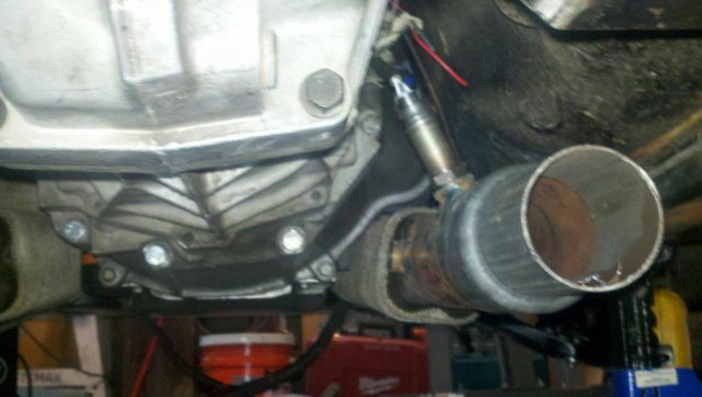

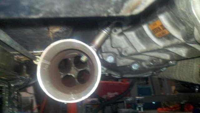

  17. Dom, I should put them up high because hot air rises right? (just kidding) I didn't think about it before but I can snag a right angle drill from work and finally buy a step bit and put my second set downstream and parallel (vertical) with the trans tunnel. That would look pretty slick and keep the wiring tucked away and clean. Keith I think you are right, we're kind of splitting hairs when talking a couple inches, that only matters to the girls. I would think the exhaust pulses would mix pretty well in the collector. I've read everything from as close to the primaries as possible to 4x the primary diameter minimum. I will have them somewhere in that range and I'm sure it will work out fine. http://www.popularhotrodding.com/enginemasters/articles/hardcore/0505em_exh/viewall.html here is a really good article on zero loss exhaust design that a member passed on to me. I can't remember who it was but he built a REALLY nice set of try y headers for his SBC Z.
  18. Here's a pic Dom. I put them in as high as I could without hitting the transmission I will put the spare bungs in a couple inches back. I extended the drivers side sensor wires to run across the valve cover under the fuel injection harness and down the back of the block. The passenger side breaks off the harness right at the firewall and down to the connection, safe and sound
