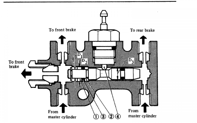

I can bleed the system normally though, it's only under hard braking that it does anything, moderate pressure braking seems normal. Left front also seems to lock up before any other wheel, if that means anything to anybody. Stock everything(good shape) except pads, I forgot to mention it before. I guess I'll try bleeding the master again, can't hurt. here's a pic of the switch from the FSM, just for reference. -
Brake warning switch
letitsnow replied to letitsnow's topic in Brakes, Wheels, Suspension and Chassis
Taking the mechanism out would link the front and rear circuits if I'm looking at the diagram in the FSM correctly. I might just take it out like you did. -

I believe I'm having issues with the brake warning switch. It comes on under heavy braking, and I believe I can feel the switch in the pedal. Whenever the light comes on I can feel a notch or pop in the pedal and again when it goes out. If the light comes on, hitting the pedal again can cause it to go out. It only comes on under heavy braking. I've bled the brakes starting from the right rear going to left front. I've adjusted the rear brakes. Can the switch cause lower pressure on one of the circuits? I feel like the rear brakes aren't effective enough, but this may be because I have parts store shoes and porterfield front pads. Autocrossing, the fronts seem to lock up fairly easy.
