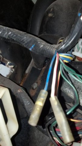

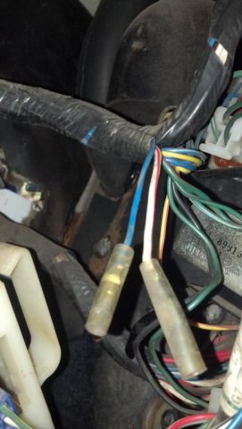

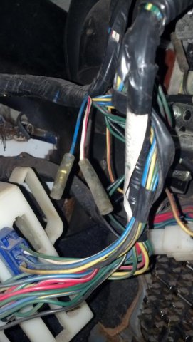

	  77 280z cannot start, injectors not functioning?ISPKI replied to ISPKI's topic in Ignition and Electrical Here are a few shots of the wires that I am trying to figure out. One is a bullet connector, the other is a spade connector, both female. I can find where they are supposed to go. This is on the passenger side. I also found a plug disconnected on one of the relays in that cluster on the passenger side, above the fuse box. A 6 pin connector with 3 pins in it.
	  77 280z cannot start, injectors not functioning?ISPKI replied to ISPKI's topic in Ignition and Electrical ECU looks brand new inside. I was scrounging around and found two disconnected wires over on the passenger side dangling down from where the engine harness comes through the firewall. One was white with a red stripe and the other was solid blue, about 14ga, both had bullet connectors. Not really sure where these are supposed to go but the white/red striped wire has continuity to the large wire going to the alternator from the battery. No idea where the blue wire goes but seems really odd - those white/red stripe wires are usually really important... Will investigate more when I get into it this weekend. I just had to fabricate a new exhaust system for my honda civic before winter hits so that has been sucking away alot of my time.

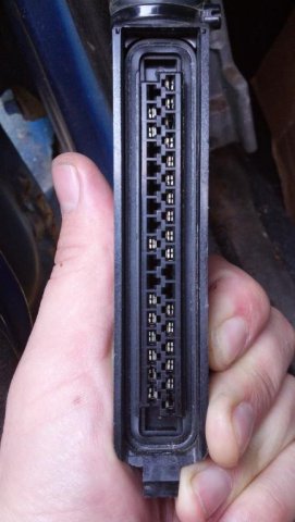

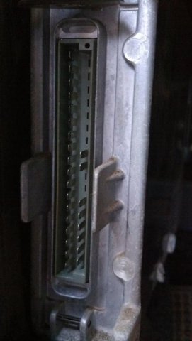

	  77 280z cannot start, injectors not functioning?ISPKI replied to ISPKI's topic in Ignition and Electrical I did not get a chance to check the resistance but I will do that today. Here are the photos of the ECM and ECM plug. I dont recall which end to start counting from but some of the pins are not lining up. I looked online and that appears to be how they are configured, just seemed odd to me. I am leaving now and will continue testing and report back later tonight with results.
	  77 280z cannot start, injectors not functioning?ISPKI replied to ISPKI's topic in Ignition and Electrical Well I located the ground wire on the intake. It was in bad shape so I cut it out at the point where the three smaller wires connected from the harness and soldered in a new wire. Still cannot start. I was looking at my ecm and noticed that there are pins on the plug for the ecm that do not have pins matching up to them on the ecm side.

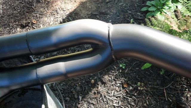

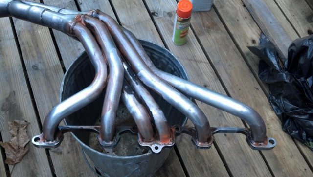

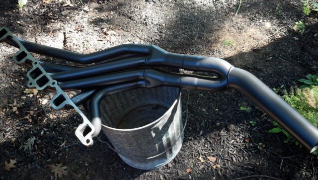

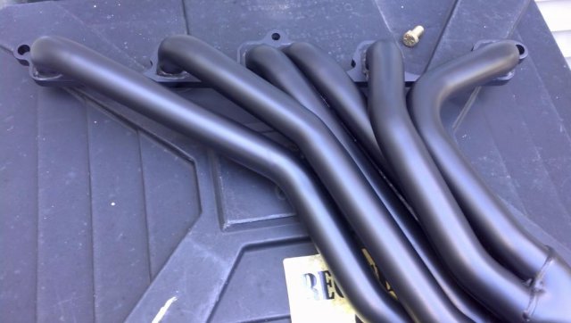

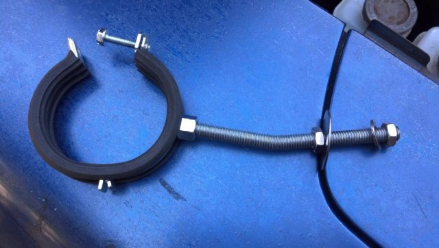

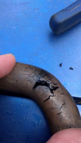

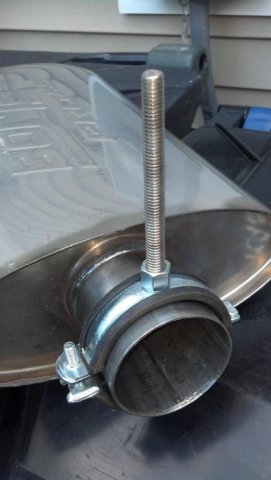

	Been a while since I updated this. I decided to remove my old manifold and rusty exhaust piping. I purchased some MSA 6-2-1 headers new, used a chemical stripper to get the paint off and painted with Rutland's stove and chimney paint. Looks alot better than I expected, has been on the car for a month or two now and no rust. I picked up 5 feet of stainless 2.5" pipe, a Borla Pro-XS muffler and some Torctite clamps to run the exhaust straight back and then out the side behind the door. Sealed the clamps with permatex. I also made up some exhaust hangers with these cool vibration dampening clamps from mcmaster and a SS threaded rod. While I was removing the manifold, I found the PCV hose was literally falling apart on the car - perhaps this was my issue with the engine not running very well? I picked up a new PCV, new SS hose clamps (I got a thing for SS) and a NOS flared hose. Bolted the new header up aaaaaand now it wont start. I have spent the last three weeks trying to find the electrical problem. Everything checked out but the injectors were not firing - not being grounded by the ECU. I finally found that the ECU has no connection to ground on pins 5, 16, and 17. Will be tackling these next.
