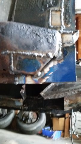

Next up is going to be the bottom of the frame. I am going to replace the sections under the firewall prior to cutting out the entire floor region. Should have it all welded and cut out so I can start fitting my NOS floors by the end of the weekend.

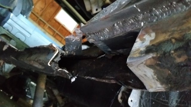

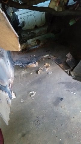

I have the floor cut back to the first cross rail, formed and rebuilt the mating firewall flange behind the fender and have the bottom of the frame (that was warped and rotted) cut out and a 1/8" piece formed to be welded in tomorrow hopefully. Pictures on that progress to come this afternoon. Does anyone have any pointers for replacing the floor panels? Currently, I am thinking I will just cut out the entire frame and floor as I have new frame rails and floor pans to go in but I am somewhat concerned about keeping the chassis straight, albeit, there is almost no weight in the car at this point.

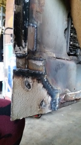

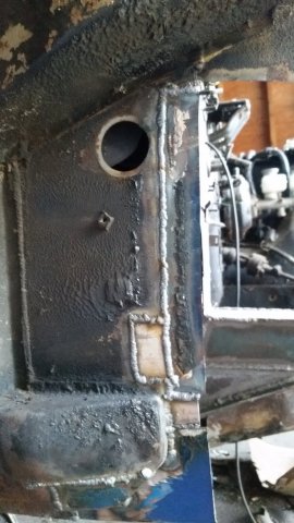

Frame and firewall behind and above the frame is patched up. Started cleaning out the rotted floor and outter fender area. Also - Pulled back all the rusty fuel lines and dropped the fuel tank out in preparation for torching out the pass side floor. I have NOS floor panels to go in.

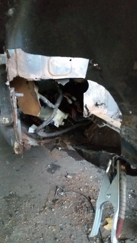

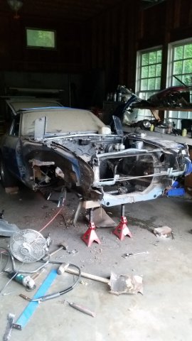

Heya folks. I finally got enough projects and customers out of my shop to bring my 77 280z in and start fixing it. Started off by stripping everything out of the engine bay and repairing the passenger side frame, fender walls, firewall, and floor.
