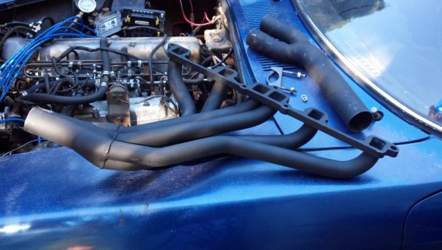

	Had a little bit of time to work on the Z. I decided to go ahead and hack the old exhaust system off and replace it with headers and single straight pipe side exhaust. I got the MSA 6-2-1 headers from thezstore.com super early, shipment was supposed to arrive next week sometime at the earliest but it ended up arriving Saturday morning. Big thanks goes out to Jeff over there for picking up on the small details of my order and saving me from a huge headache! I test mounted the headers with all the shiny new hardware and jacked the car up to see how I would run the pipe. This was the first time I actually had the car this high in the air - I could get a really good look at the underbody! Driver side floor and frame looks to be in good shape - just a hole rotting out around one of the rubber plugs. Frame is very clean though, factory teal paint is even still showing on parts of it. Passenger side is pretty bad. Floor has multiple large holes in it, frame is starting to rot out towards the front of the floor. Good thing I have new manufactured floors and rails for it! Anyways - I ordered heat wrap for the new headers, and about 5ft of metal pipe and a 90 degree bend for it. Just need to figure out what kind of muffler I will run, suggestions are welcome. I also hooked up my new fuse block, looks pretty darn good compared to my old setup. Uses MIDI fuses to replace the fusible links. It also has ATC/ATO blade slots that I am not using. Once I get the piping in to do the exhaust system, I will be able to get it back together and see how she runs. I am suspecting that the old stainless hardware may have been contributing to how poorly she was running as all the washers and nuts are warped due to not being able to stand up to the heat/pressure needed at the manifold. I was concerned that I was stripping out the threads in the head when I tightened them down, but I see now that I was just concaving the washers into the openings. Something that concerns me about the header is that when I bolted the left side down, there was a large gap on the far right side between the flange and the gasket. It was about half an inch before I put the nut on the right side. It smoothed out as I tightened the nuts down but it still seemed odd - the flange is so thick, I dont know how it could have bent except by stresses during manufacturing.

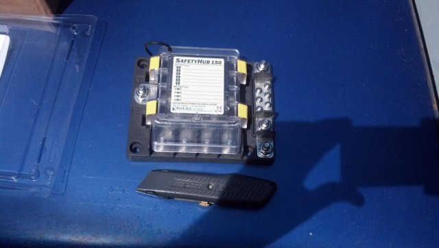

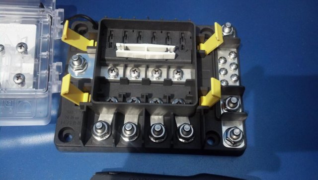

	  What do you use in place of your fusible links?ISPKI replied to ISPKI's topic in Ignition and Electrical Here are photos of the Blue Sea Systems fuse block. Very high quality. I have it wired in but I have not been able to test it as I have been waiting for my headers.

	  What do you use in place of your fusible links?ISPKI replied to ISPKI's topic in Ignition and Electrical I just picked up the blue sea systems fuse block and its pretty nice. Everything is stainless on it, the bolts, the mounting hardware, the plates that carry the current. It has slots for 4 midi fuses and several ATO fuses so I was thinking of running some extra lines through it. Everything is also water proof as expected, there is an O ring under the lid that seals the fuses, the bolts and threading for the fuse mounts are sealed in, its pretty nice, even has a label on the lid so you can record which fuses go to what and what their Amp rating is. On top of that, it has slots for spare fuses on the underside of the lid. It is big however, wider than a utility knife and almost just as long. It is also heavy, and expensive - I purchased it for 98$ shipped.
