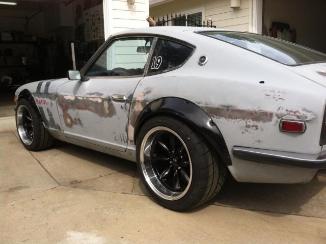

Time for an update. I sold of 2 sets of wheels and tires and purchased 17X9-9.5 Rota RB's and Kuhmo 245 40 17 255 40 17 V720 tires. They have not arrived yet however once installed, along with flares I have sitting on my bench, I'll post some feedback, pics, and some more AutoX video. -

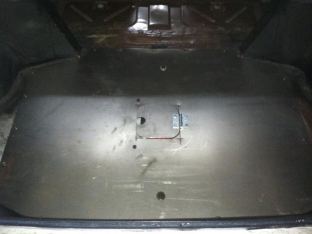

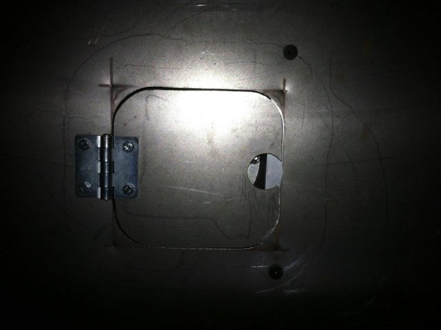

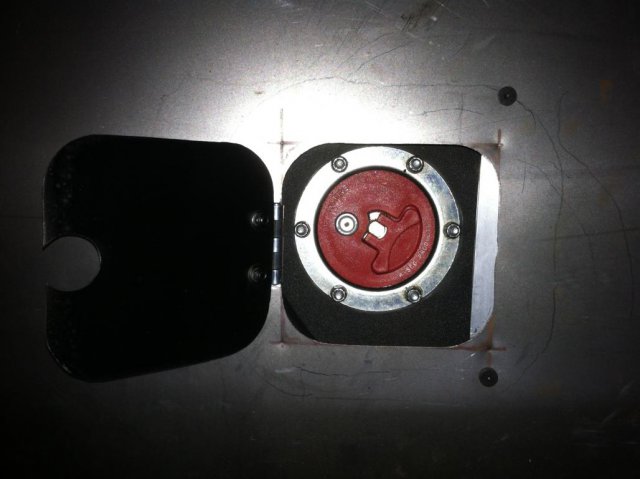

Finally got my anti slosh foam in my fuel cell..... Lost fuel at the pick-up autoX racing last month with 1/3 tank...... Not anymore. -

I forget the guage but it's pretty stout...... I went to a steel fab place and picked it up from there as scrap.... I mocked it up and cut it myself.... painting the underside black to prevent rust... I did seal it. It doesn't rattle and blocks sound pretty well with my carpet kit over the top. I think I'm into for less than $20.00 -

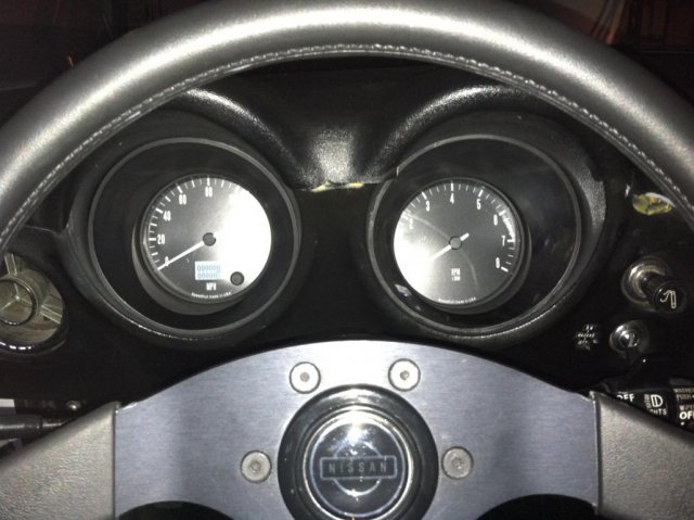

Stock fuel is the first to go..... I will most likely just swap out the clock space for a speedhut, then do the others as cash allows. ordered a new dash cap today to replace the one sacraficed for the gauges. -

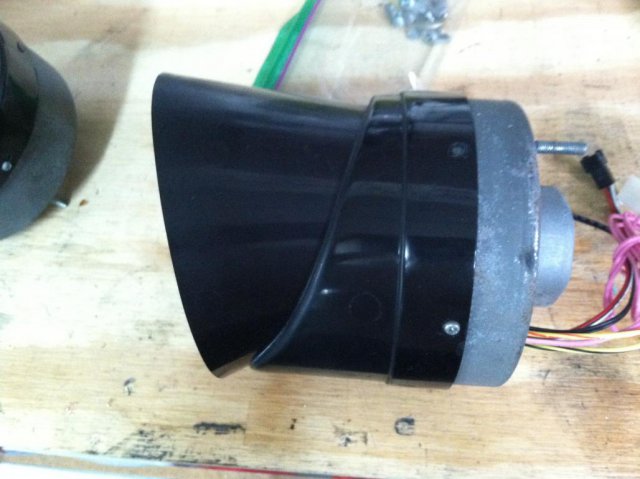

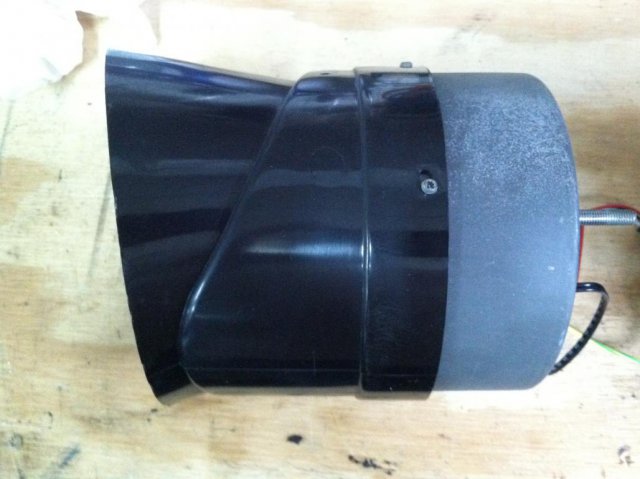

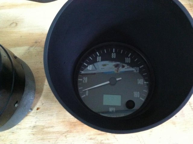

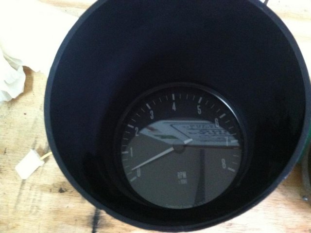

4.5 speedo and tach fit perfect in my 72 240Z LS1 swap, pods and cans. Great product at a great price with great service.....

I'm using stock Datsun for now.... it all works minus the gas guage reading backwards...... I will upgrade to speedhuts later as $$$ allows. These 4.5 gauges fit so nice inside the stock housings.... I got pretty lucky. -

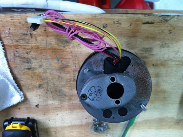

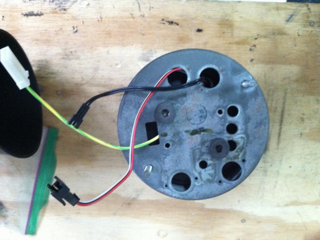

I forget... let me look that up. I think I ran long as well.... you can always cut down but not add to. Finally got my gauges out (thanks for the Hybrid suggestion of 3/4 socket on wing nuts). New qauges are installed in pods, very clean, and will get wired and back in this week. had to sacrafice my dash cap but a new one is on order. pics comming soon. -

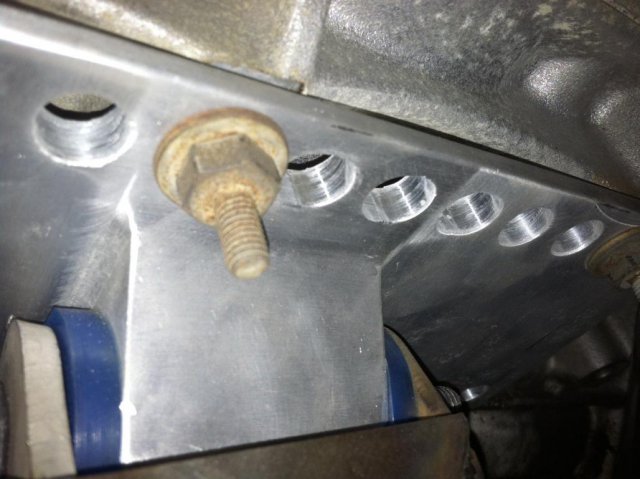

Looking at your mounts..... Looks like same hole locations..... Not sure what the diff is? Keep at it my friend, you will figure it out. Your build looks great by the way. Feel free to keep asking questions. Jim -

Home sick today.... Let me see I can take a few pics of mounts close up as is and post them for you. -

Not sure...,. I bolted it all up where it seemed to naturally land after numerous measurements and according to the fit on the trans brace. Cxr doesn't give any instructions so I just went with my gut after years of tinkering and racing cars. I'm happy with how it works as of now. It pretty close to firewall and it all sits behind the front axle..... A few more autoX races and I will check for stress issues along the way Jim -
