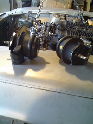

So I got a little more time to work on things this weekend, but not too much since i was tired and it was cold out. Anyway, I pulled out the stock engine mounts: as you can see they're HUGE, they're also hard rubber which I don't think would do much as for vibrations. I could use them, but at almost 5 inches tall I'd have to really build a lot to the frame to support them. I don't belive that's really worth the trouble. I then went looking at other mounts, like the BMW 325I mounts from autozone, Soft rubber 1.5 in thick, definitely workable. but $45 EACH. aaaa no, not going to happen. So it's find something else time; thought about going to U pull it but it was getting late by the time I made it home. But I wanted to figure something. I was looking at the stock L28 mounts on the parts I cut off the crossmember, and sure enough, softer rubber, in good shape. but they have kinda a C around them. Easy enough, cut the sides of the C off, and upside down it fit just fine in the VQ mount bracket. The bolt is a little short, but still workable. I'll need to build a bracket to hold the "top" of the stock bracket to bolt the mount to the frame but I think these will work. I'll get a pict soon. I also figured I'll have to bebuild the AC system since the waterlines were in the way So I removed the stock AC pump, and lines to the firewall. I'll reroute those later if I can change the pully on the AC pump. In NM gotta have AC... Any questions let me know, I learn from you guys as well. Oh Myron in another thread said to keep the oil pan level, good advice. I'll try to do that. Phar

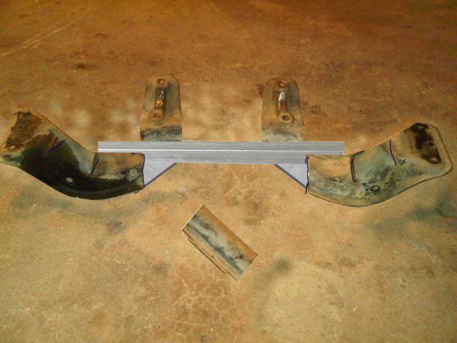

So I've been doing a little work, but it's been slow due to relatives being in tow. I went yeserday and bought some 3/16" thick 4" wide flat stock to build my engine mounts out of and to use for gussets and whatever. I want to use the Stock 350z hydro engine mounts since vibrations really bother me but I don't know how much they compress yet so I'll need to clamp on some steel to the frame and drill a couple holes to try them out in a non perminent setup. This will be good to so I can test my hood fitament at the same time with the hoist out of the way. I'm waiting on my Energy suspension kit to get here too, since I've got the front all apart, I might as well replace things while I'm at it (I know dangerous words "while I'm at it..." ) Anyway that;s it for not, any questions let me know. Phar

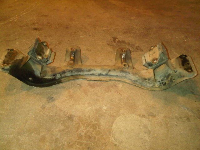

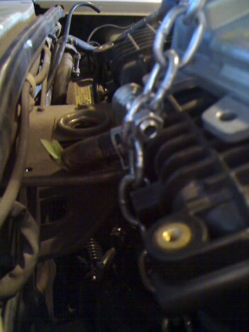

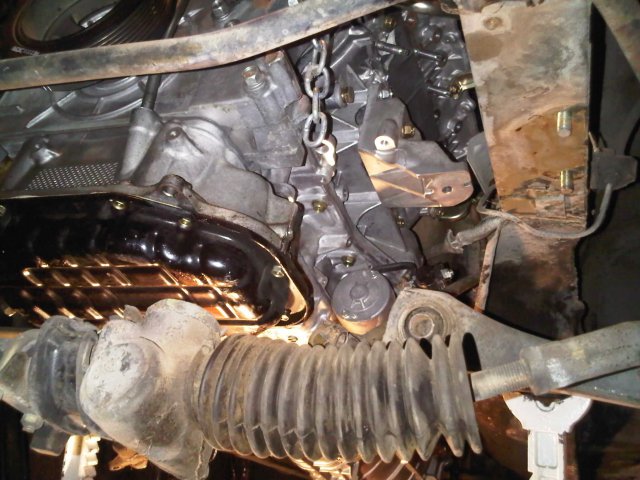

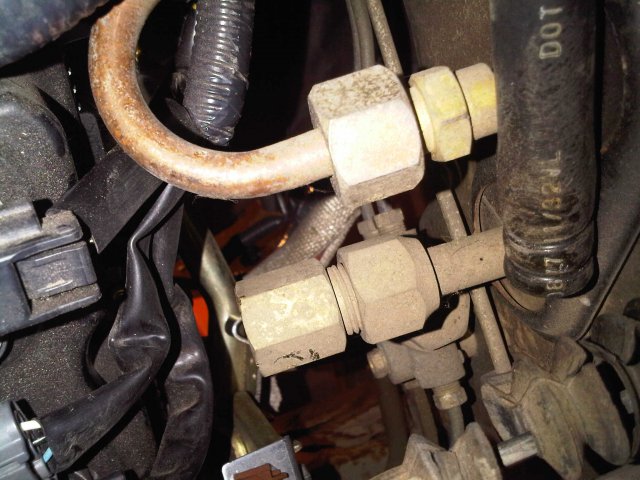

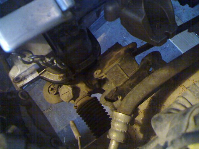

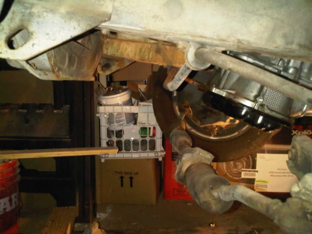

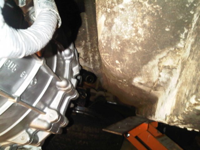

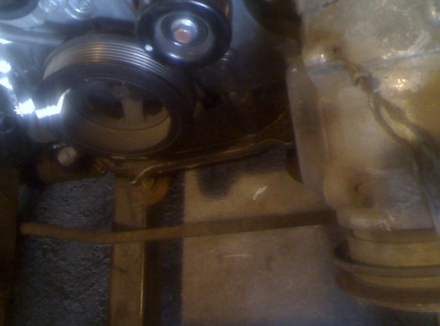

Okay, I removed the engine crossmember and found the engine still is going to sit a litt far forward unless I remove or at least change a lot of the AC piping. Not too hard to do, but a pain that I have to do it. couple more picts: Gotta remove the stock tranny mounts duh, forgot that. This is about an inch lower than the engine will actually sit in the bay. basically won't be any lower than the fron sway bar. so that's good. This shows the AC pipes that actually are sticking out about 3 inches from the firewall. I'd prefer maybe an inch tops. I don't want the engine to rub anything. Gold pipe on lower center is actualy a waterline I'll replace with rubber hose to avoid AC piping. rubber hose on right is the Brake vaccuum tube. The stock crossmember. This in an idea for the crossmember redesign. The Steering rack mounts would actually be mounted more vertically putting them almost over the 1.5" sq tubing. flat stock for bracing shown would be massaged to clear the lower block. I'd like at least an inch clearance. We'll see how it fits when I get the engine mounts in. Engine mount will need to be about level with the top of the frame rail for engine to clear hood. Exhaust is going to be a tight squeeze. That's it till likely after the weekend. we'll see how it goes. let me know if you have any questions. Phar
