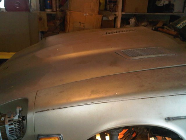

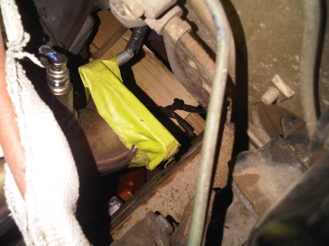

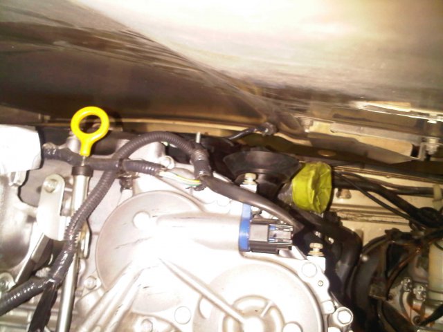

So it's been a while since I've posted. In that time I've pulled the engine twice and reset my motor mounts since I didnt' like how far forward the engine was sitting. Ahoke and Ey weren't kidding when they said it was tight. Though the VQ35HR does seem to fit a little better that the DE version. Mines about as far forward as theirs BUT I still have my hood latch. I've been modifying my Steering crossmember much like Ahoke did, so I'll be posting some picts of that soon. I'm really happy with my hood clearance, and with the oil pan clearance. I'd thought is was a lot taller than the DE engine, but really I'm not seeing this to be much of a problem at all. Here's some picts of the clearance. under hood clearance Exhaust is tight at the firewall, this will take some work. another exhaust view, I'll have maybe 5 inches to make that bend. Hood closed no trouble.
