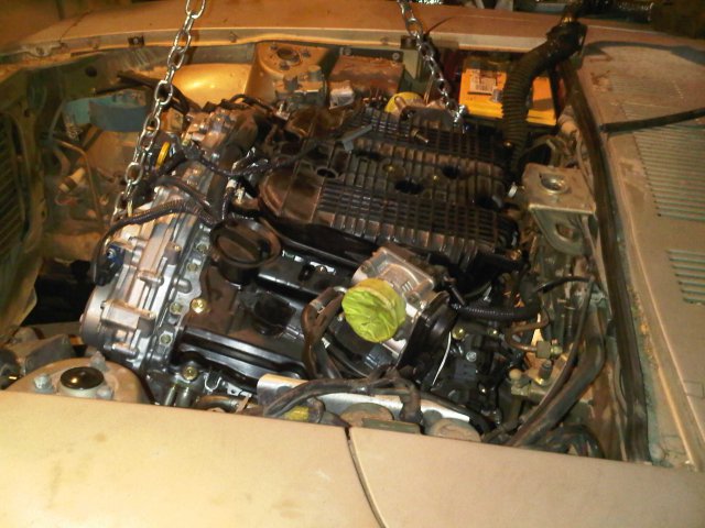

that's a clean orange and brushed alum looking engine. nice! Here's mine: It's in there w/o the chains and such now, and at a better angle. I'll be pulling it again to better weld and paint things.
