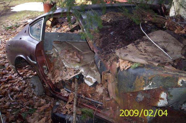

been a while sorry. here is a couple of cars I checked out over the last few days. Not interested in them but thought I would post them here for others who might be interested 240z for $1 on the sunshine coast bc http://s674.photobucket.com/albums/vv103/BigDaddyP77/. 280zxt for 3200 homebuilt as you could tell -

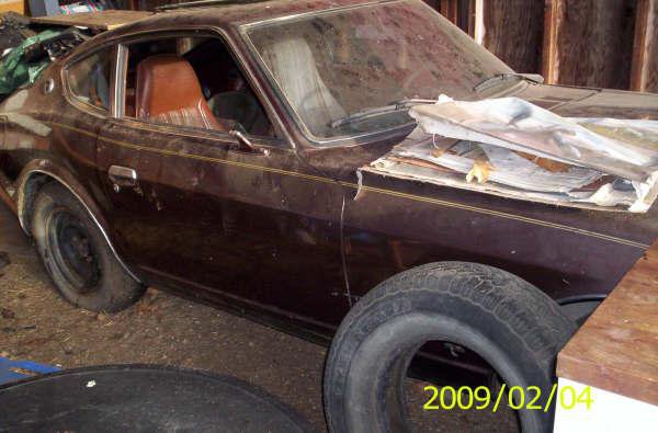

I just got back from up-islamd checking on my cars. Time sure got the best of these. The 240 is gone but have a 741/2 260z, 78 280z, 80zx, and a 83zxt left.The 260 needs alot of work but is still almost all there. Missing 2 front fenders. Hood,hatch and doors are off but there. The 280z is intach but it needs some help. Dissappointed about the cars being moved out of the barn but hey I never paid to have them stored so it is what it is. Gonna check out this 80 280zx tommorrow. http://www.usedvictoria.com/classified-ad/8119073 Cheers ! -

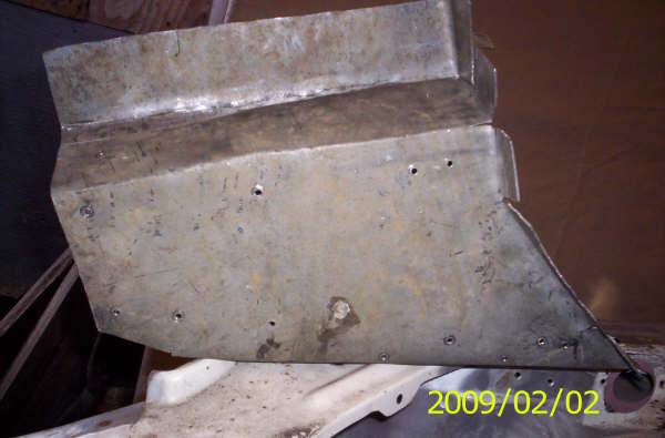

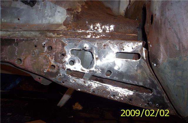

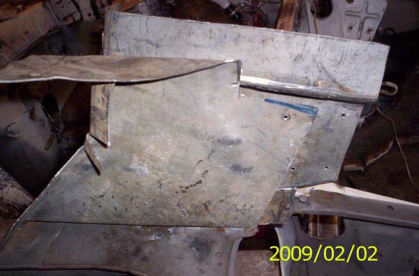

Wow what a great responce ! Thanks to all who have thrown in their 2 cents. It's nice to know there is others out there that have expierenced (unfortuneatley ) the woes of a leaking battery in a Z. I have posted a couple of pics of the work I did over the weekend. I plan to scab that piece over what is existing. It's heavy guage galvanized. I plan to be ventalated when welding. I cut the parts that were protuding from the side of the rail and am supprised how well the new piece matches. Next I will sandblast inside and out of the existing rail and then scab this on. The frame rail goes from this new part back. Thanks to all that have suggested Null's work and Mikeatrpi's work. Good info ! And the offer to cut out what I need out of a good donor car Unbelieveable Thanks man but I don't want you to cut up your car. Thanks though -

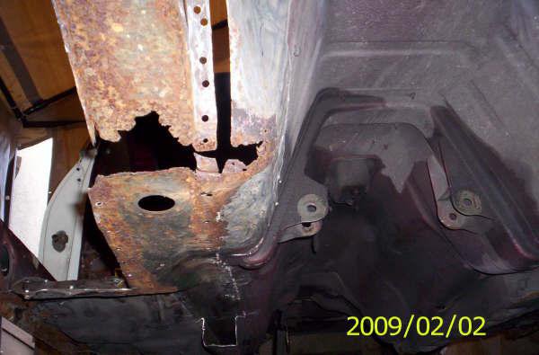

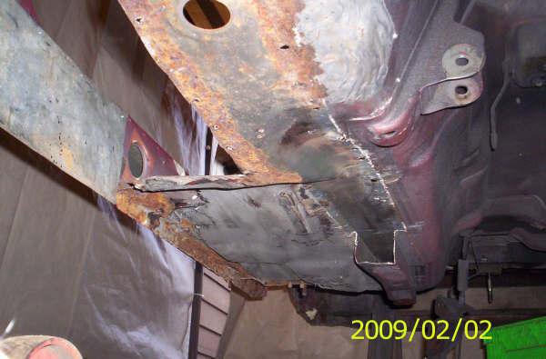

I really do appreciate your feedback. I went gun hoe on this project in Nov./08. Had spent hundreds of hrs rebuilding a l28et. Cleaning, porting, and polishing everything. Got to this point and had the wind knocked out of my sails when I saw the rotted frame rail because of the battery. I am gratefull of your link to your site mikeaprti Nice work ! Supprised to see the floor patch was welded from the inside. I can understand for the ease of the repair but what about trapping water inbetween ? I am only asking because I am trying to get strength and I am not afraid of working to get get it right. Hope this doesn't come accross as me calling down your work:). Not my intention My problem right now is where do I start. I have placed a piece of metal along the rocker panel (horizontal). The frame rail has been removed from start (below battery) to the rear. I drilled out spot welds to remove rail. The rail for the engine is in good shape the the top but paperthin on the bottom. I was going to wrap a piece arround the rusted metal and leave it in. Or should I remove it all together ? -

any repairs I did inside held well and didn't cause any worsening. The rocker panel and rear 1/4's DID NOT work. Caused water to keep the rust wet. Looked ok outside but when I removed it, a whole lot of rust came with it. I had ground all the rust out and had spayed a rust product on all expposed when I did the work. I am always willing to learn, so if you have suggestions I will appreciate the help. I have all the tools (air everything, welder, grinders etc.). As far as skill is concerned, I was a Caterpillar specialist who rebuilt equipment for the Alberta tar sands. Have fabricated many hyd. parts but never have replaced a floor pan and rail that is hardly even there. But I am willing to try. -
I have had my 1980 280zx since 1991. I rebuilt the drivetrain in 1991 and have put over 200k on her. I had used fiberglass to fix spots along the floor/rocker seams and placed some sheet metal over rusted floor in pass. side. I have a turbo l28 ready to go and just wanted to strengthen the body to be able to handle the new torque. I have every bolt out of her and then ripped my handy work out to see the state of integrity. I didn't want to put everything in to find out the first time the clutch gets dropped and have my car twist I have been reading alot of threads on floor and rail replacement. Most relate to the older z's that have a flat floor pan. The 280zx has a really poor design for replacing. Most guys here find a donnor car and replace the needed area with matching contours. I have over 10 280zx's all with the same type of rust pattern and it doesn't make sense to replace something that might be a temporary fix. Plus I want to put a lot of torque to my rear wheels. Here are some pics of my issues. The passenger side is rusted right out but drivers side is completely intact. As noted with many other 280zx, the battery rots out the firewall and main rail. My question is = Do I continue trying to fix this with new floor/rocker/frame rail/inner fender/firewall Toast this rusted heap and look for a California car I think I might be biased and am trying to keep this car for the memmories
