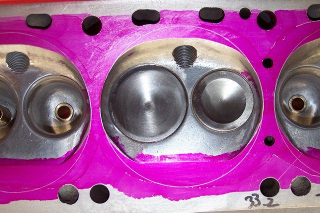

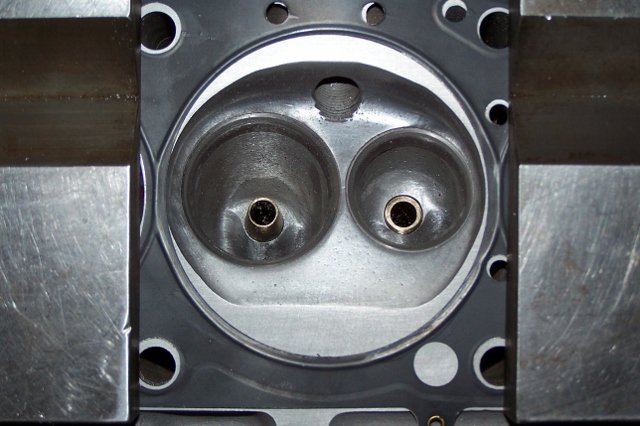

Yes, you also have to use an adjustable cam gear and time the cam because although the Kameari unit takes up the slack, the distance between the cam and the crank gets shorter. And this alters the cam timing in relationship with the crank. Xnke, I'm not sure where to do more unshrouding work. The Nismo gasket is 91mm wide at 3:00 and 9:00 if I recall correctly. As you can see, the gasket is right at the edge of the intake valve. There is a little room left on the exhaust, but my bores are only going to be 88mm... As it is, I'll need to eyebrow the block for flow reasons. Should I take the exhaust valve area out to the edge of the gasket like on the intake side? Or, are you talking about more unshrouding elsewhere in the chamber?

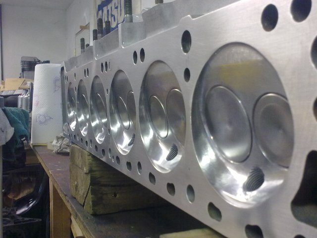

So, I have been held up with the decision of what to do about my head. It is a late style E88 and I didn't realize the lack of quench issues with it. I explored all kinds of options, popping a flat top piston up out of the deck, welding chambers, etc. After chewing on it for some time, I decided to mill the heck out of it. At this point, it has had .107" taken off of it. Here is a pic of one of the chambers. The .6mm Nismo gasket is laying on it. Chamber size is 33.2 cc. So, the idea now is to order custom JE pistons that will work with this chamber. I'll be running zero deck. Based on some earlier mocking up and measuring of piston to valve clearance, my valve reliefs will need to be around .160" intake and .180" exhaust. Piston to deck clearance will be the Nismo gasket = .024". I calculate that between valve reliefs and a dish in the pistons, I'll need to find 11.75 cc's to bring the compression ratio down to 11.0 to 1. I could also open up the chamber a bit on the spark plug side, but I'm thinking it would be good to have the flat area there for quench. I am hoping to run this thing on 93 pump gas with 35-36 degrees advance. If I can't do that with the Mikuni set up, maybe the Tec GT fuel injection setup can make it happen.

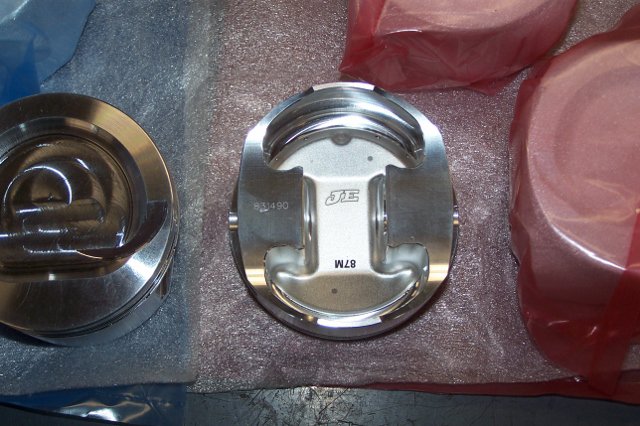

Anyone know of someone at JE that is knowledgable about L series pistons? As with many things, it would be very helpful to talk to the right person who has actual knowledge, instead of doing the best that I can with whoever answers the phone. My thinking is that, if this person exists, they will know what blank to start with and a lot of the parameters that I need not rethink (don't want to reinvent when what has been done before works). Would be great to start there instead of from scratch. Alternatively, if you have a JE job number and can describe what you ordered in detail, that could be good info. A job number is a good place to start if you know all the info that was specified for the pistons. Thanks for any help you can provide.

Do you recall the name of the place that did the welding work for you? Pistons are anything from ~$850 from Rebello to $1200 or $1300 direct from JE. If I send it out for welding, I'm thinking new guides and seats all around, in addition to the welding, plus head gasket resurfacing and combustion chamber shaping. Most of that my engine builder could do... I'd like to estimate these costs vs. doing a P90 from scratch I guess. My engine builder did one of those recently, and he didn't care for the shorter valves - which put the exhaust port turn even sharper... Plus, he said something about not being able to get good quality valves for that head. He ended up having to get a custom set I believe. And then, there is the option of a welded N42...

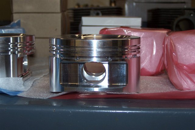

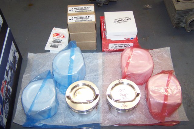

The stroke is 3.165 (80.39 mm). I was shooting for 81 mm using the stock crank (79 mm), but this is the most the crank grinder could get out of it. I am using Toyota Celica rods... They are 5.430 (measured) center to center, which is about 8 mm longer than stock. Cam redline is 7700 RPM with the springs that came with it. Stock flat tops wouldn't have taken those revs... and of course, I will be using the Toyota rods. So, custom pistons are a requirement now. The E88 head has had the seats replaced with hardened ones, intake seat and valve is now 280z size. I just did a ton of port work and combustion chamber work, put in new maganese bronze guides, had them sized to fit and refaced the Manley valves (tuliped ones sourced from Nissan Comp back in the day). If horsepower is in the heads on these cars (and the money), I really hate to start over with another head. I talked to my engine builder about the three options I mentioned in the post above. He suggested another option... Ordering flat-top pistons that will pop above the deck by .095". I know of no one who has done this. But, he makes some good arguements. Looking at my combustion chamber, he says that he could stick the head on his mill table, and then remove material from each chamber... But, he says we'd only have to remove a little bit from say, 11:00 to 1:00 (on driver side of the chamber), and cut back the edge of the chamber a bit along the 5:00 to 7:00, or 4:00 to 8:00 locations (passenger side of head) to make room for the piston. The other locations around the chamber are already cut back enough for the 88.5 mm piston to come up into the chamber - because of the unshrouding work I have done. If you look at this pic, you can see the chambers as they are now. Note the little shelf at 12:00. That shelf is about .080" stepped down from the head gasket surface. Cutting another .080" off of the head (.017" has been cut so far from stock) will give me a flat area for quench that will be about the size of that little shelf. But, add flat top pistons to this mod, and I will probably be somewhere between 11.5:1 and 12:1 based on my calculations. With the pistons in hand, we could mill a small dish as necessary under the exhaust valve area to fine tune the compression - bring it down to 11:1. Another benefit is that the chambers would be modified identically across the six where material is removed instead of any casting irregularity that I might have now. I'm chewing on it.

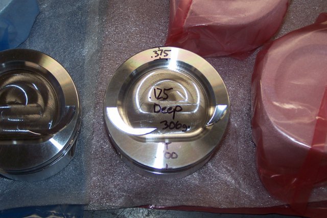

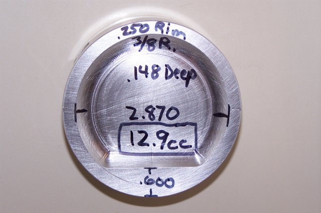

Did a sonic test on my block and we won't be able to go to 89 mm as I had hoped. Based on the numbers, I'm looking at 88.5 mm max. That means the compression ratio is going to be too low for the cam (~ 10 to 1). So, I need to put a dome on the pistons. So, how do I do that? I can easily calculate how much of a dome I need (in cc's)... But, how do I specify such a thing? I'd like to go with JE... Have no clue how to proceed. I'm guessing that they have several L series pistons in their database, but I really have no idea how to specify exactly the contour that I need with valve reliefs, etc. Shooting for 11:1 compression ratio... Anyone know how I should proceed? How do I specify what I need to JE? Garrett
