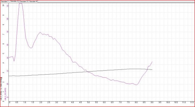

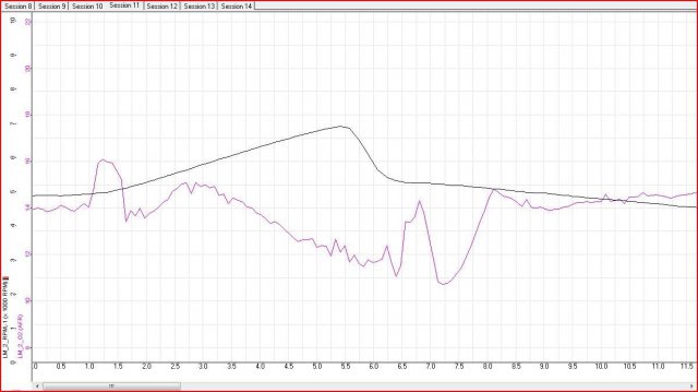

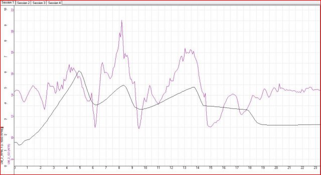

When I have had time over the last month or so, I've been working on tuning my freshly built engine. I'm using a wide band O2 sensor. I had just recorded a few runs to the Innovate LM-2 SD card. I pulled off the interstate and swung around to the on ramp on the other side to go the other direction. I stopped on the side of the on ramp... pushed record, and eased away in first. I ran through the first 3 gears pulling just north of 7000 in each gear... I slowed down and merged onto the interstate and stopped recording. But within a 1/2 a mile, I noticed some very light smoke spiraling off the right rear of the car. Since the exhaust is on the left, I really didn't know what it could be. I pulled over, popped the hood and ran to see what was going on. Immediately I see fluid around the starter area. I wipe some with my finger and smell it - it is coolant. I yanked on a couple of the hoses, but didn't see any coolant spurt out. The hoses looked fine. So, not knowing how much coolant I have lost, I run to check the temp - (the car is idling) and see the guage is at about 240 - definitely south of 250. A tenth of a second later the car is off. While I am waiting for the car to cool down, I keep looking until I see the problem: So... how the heck?! I've never heard of anyone experiencing this before. I am aware that there are mods that are done as precautions... In fact, I have an old Bob Sharp prepared L-20B block that I have been hanging onto forever, and it has these: I don't have a handle yet on how much power my engine is putting out, but I wouldn't have thought this mod necessary. My front timing cover is modified for a Maxima diesel pump, but I am running a stock pump because I haven't been able to locate one. Don't see how this could be an issue... Anyone else have this happen to them? Engine seems fine, by the way. I think (and hope) that I caught it in time. Garrett

Cool. Thanks for offering... I just started doing some more testing and when I feel like I know what direction I need to go, I'll be in touch. Basically, what I have been doing is taking the car up on the highway and doing 2 pulls in 5th, 2 in 4th, and 2 in 3rd. With each, I start our 65 or so MPH. I had the car running pretty well with one combination, but the thing that is bugging me is the 5th gear pulls. Consistantly, shortly after giving full throttle, the AFR drops down... down and then, when it gets below 10, the motor starts acting up, so I immediately let off. So... to rich on the mains right? To see if I could alter this behavior in 5th specifically, I went with the leanest sets of jets I have on hand. 150 Mains and 190 Airs... along with the 57.5 Pilots and 40 Pumps. And here is what happened: Sooooo... how could that be? Mains too big? I think not - as here is a run through a couple of gears with moments of full throttle, but it was leaning out big time with this combo. This graph shows that pretty clearly. I have a run in 4th also, but I just stopped making runs with this combo because it is clearly too lean. I guess it is possible the air is too big, and the main could be sized correctly, but based on my results from this following combo, I don't think that is the problem: 180 Mains, 220 Air, 57.5 Pilots, 40 Pumps... these are the two 3rd gear runs: And, yes, I totally have a hesitation for a split second when I snap the throttle open. I'll try larger pumps... which should shorten the duration of the fuel stream event. The way I read these graphs, it seems that right at full open, the AFR jumps lean, but then is followed by a brief rich spot before it seems to come into a steady line. This can more readily be seen in this 4th gear run: Perhaps larger pumps will put more full into the first half and less into the second... and smooth it out. We'll see. -

Read some forums and found where people having same symptoms with AFR readings on their LM-2 fixed it by re-calibrating the o2 sensor. So, I pulled the sensor out of the exhaust pipe and took the unit outside the garage to another one of my cars (for power) and re-calibrated it. Then I re-installed it but it was too late at night to fire it up to see if the AFR readings had returned to normal. As I was trying to go to sleep, I recalled that I had seen "CAL" show up very briefly on the LM-2 screen. Thinking through the event... I believe I somehow triggered the calibration mode without going through the menus... and the thing calibrated while the engine was running. Again, E9 is "supply voltage too low", so when I first saw it, I reached in and pulled the power adapter from the cig lighter and put it back... and I did this a couple of times in rapid succession hoping to get a better good connection (I have since then gone through the cig lighter and cleaning everything for good electrical connection). I also read through the Crane Hi-6 manual and the LM-2 manual in search of answers for why the RPM's weren't being read correctly. I'm using a MSD tach adapter with my Hi-6, which I had to put into the loop to get the stock tach to work. Not sure, but I am guessing that wiring the tach adapter into the mix could be causing the signal the LM-2 is looking for to be unusable (the negative from the coil). So tonight, I took the LM-2's black and white wire which was hooked to the negative wire coming from the coil and changed it to the tach output wire on the Hi-6 (green wire). Seems logical that with so many people having good results with hooking that wire to the MSD 6AL tach outputs (more forums) that the LM-2 should be able to use the Hi-6 tach output signal. Then I fired it up. First, the AFR readings are back to normal. So, the O2 sensor isn't fried yet. The change I am seeing as a result of moving the RPM wire location is basically twofold. First, RPM's almost never read 0 now. Second, I get a few, somewhat accurate readings around idle speed, but when I get into the throttle at all, the RPM reading on the LM-2 screen jumps to various readings in the 1k to 5k range. They are pretty random. The LM-2 manual has a brief section on "Attenuating a Tach Signal" which involves putting a potentiometer into the circuit. I figure that is worth a try next. Progress can be painfully slow sometimes. -
