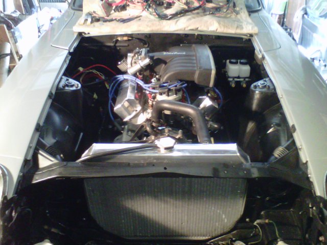

  10. Very nice conversion. Nice work with the ECU. Do you have any before and after data from the manifold change? Looks like you would get alot more horsepower with that manifold, but lose some torque.

  17. How close are you to assy and firing it up? Looks great. Are you planning to get it going with the carbs and then switch over to ITB's?

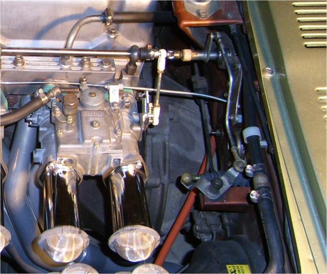

  24. Where the linkage attaches to the firewall has a ball that rotates quite a bit. Just try it like Tony suggested and if it doesn't work then just relocate that ball assy. Alot easier than going thru the deal with the cable set up in my opinion. See the photo from my car since I moved it on the firewall. Scott
