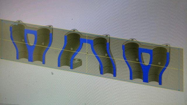

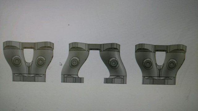

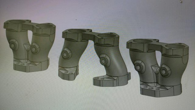

  11. If anyone wants the cut file let me know. I ended up finding a SK intake that I love. I would think the intake would have worked fine.
