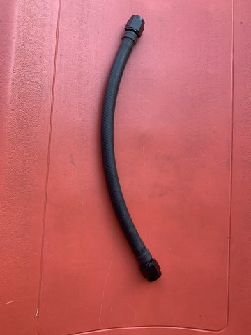

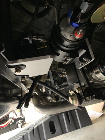

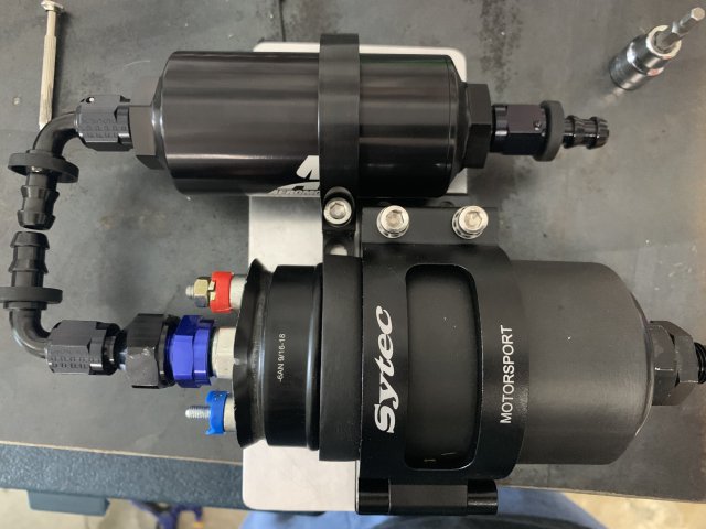

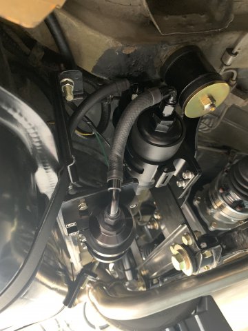

  3. My stock lines are 5mm return and 8mm supply. So the Return gets a 3/16 line. Which is pretty tiny.

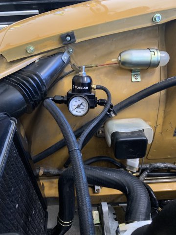

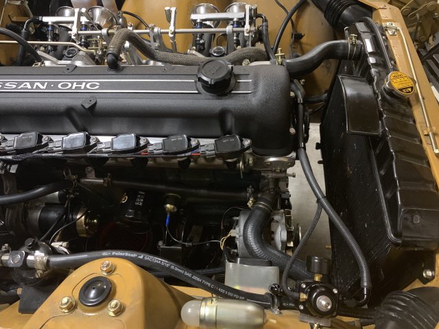

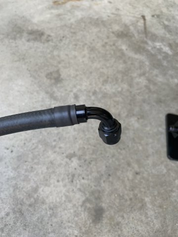

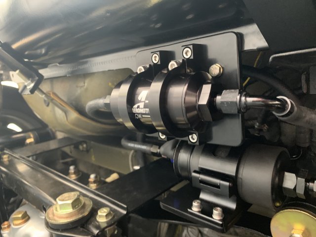

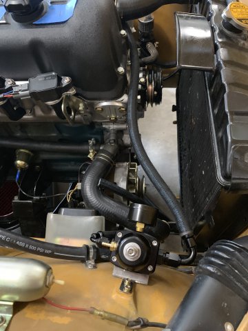

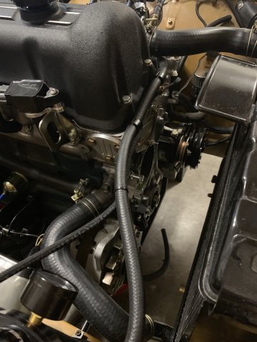

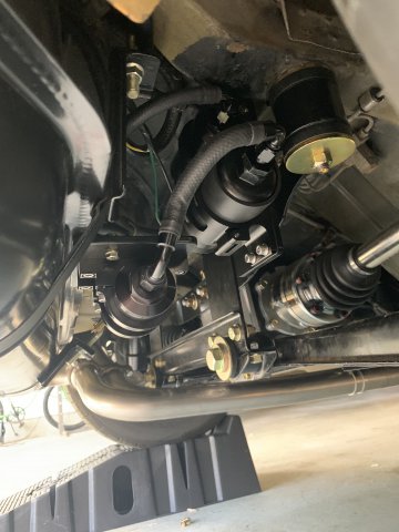

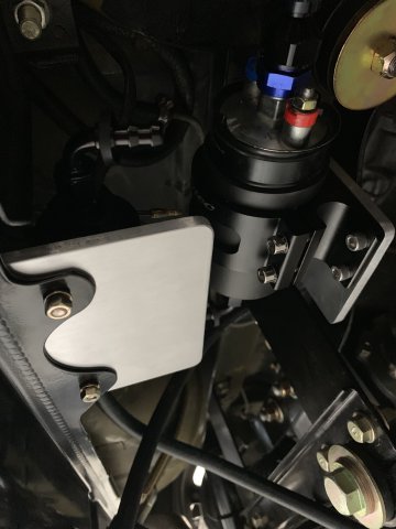

  4. First major setback. The return stock hardline is too small and is causing pressure to build up. Lowest I can get is 75psi. My plan is reuse the 8mm fill line as my new return then run 3/8 new flexible hose from the pump to the fuel rail. Then 5/16 line from the FPR to the 8mm stock line back to the tank. Then Y the 8mm (5/16) hardline to stock 5mm return and the 10mm tank vent.

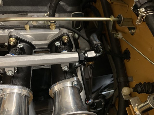

  7. now Engine bay is wired Now to hook up the fuel pump, keyed ignition and tach

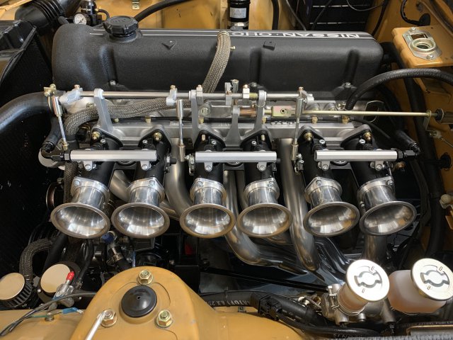

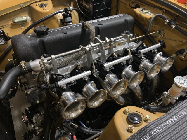

  10. I got pretty far but I didn’t finish. Tedious work

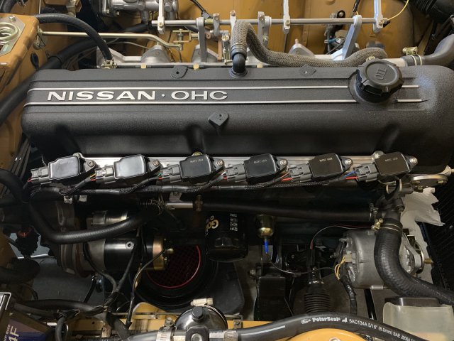

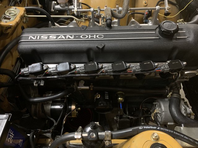

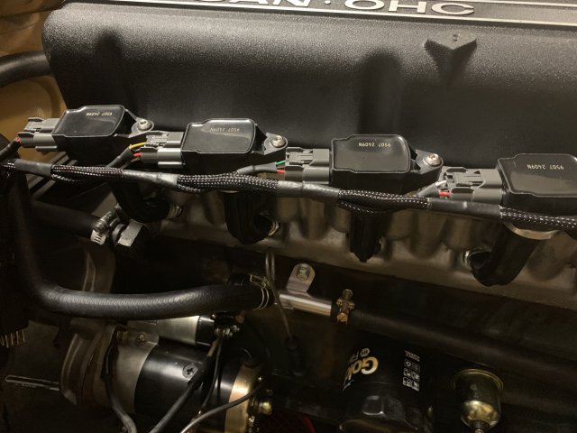

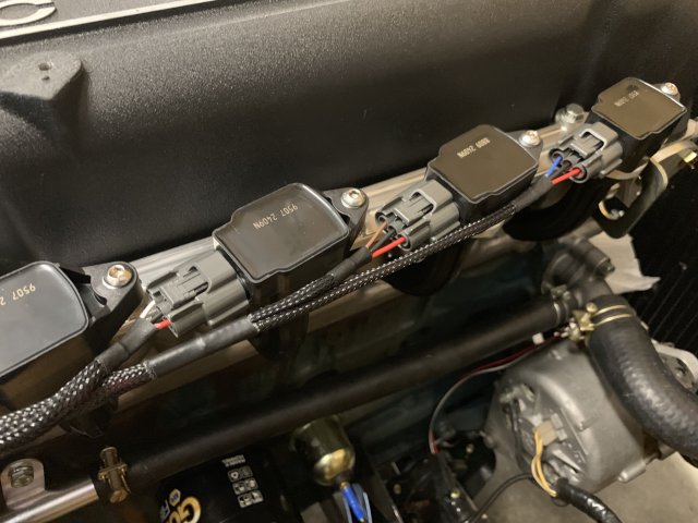

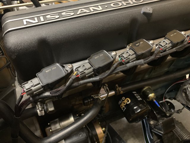

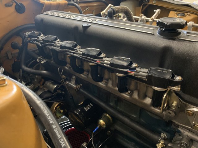

  11. Injectors are wired. I can’t tell if that was fun or not. But I’m proud of how it turned out. Matches my coils pretty darn well. Now the easy stuff is left. Hopefully I will get that all done tomorrow.
  12. This is my plan for the injector positive. Basically a Y splice and crimp. The pulley wire isn’t cut. Just the sheath is removed. Then crimped another wire onto it. Then a dab of soldier. Then heat shrink. Should work perfectly. It’s just going to take a long time!

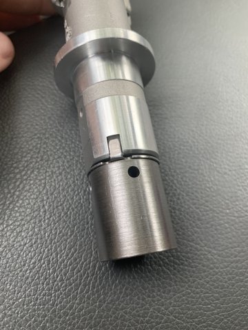

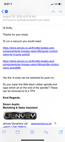

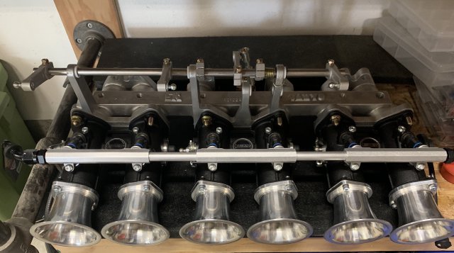

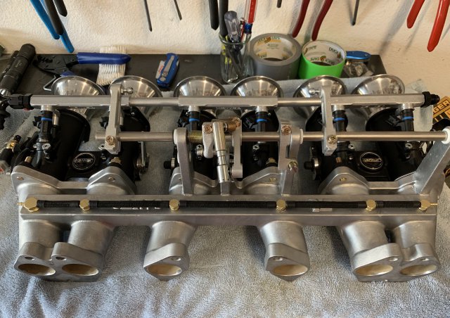

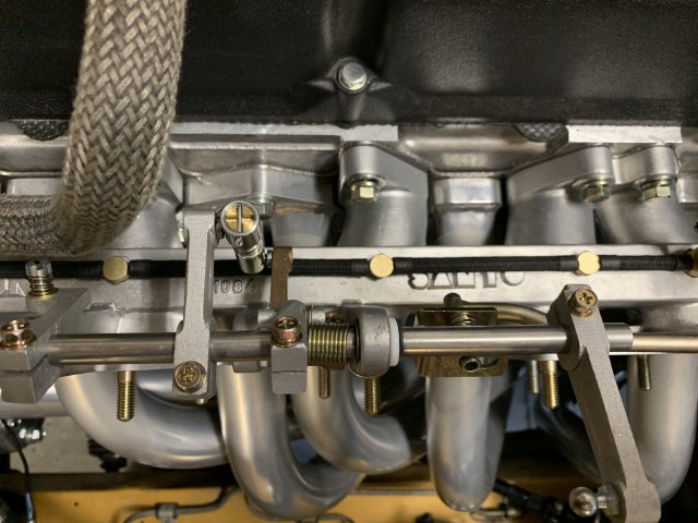

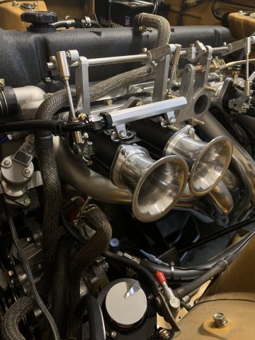

  13. It’s shorter. Which I didn’t want. I actually called Jenvy and asked for raw in the standard size. They said no

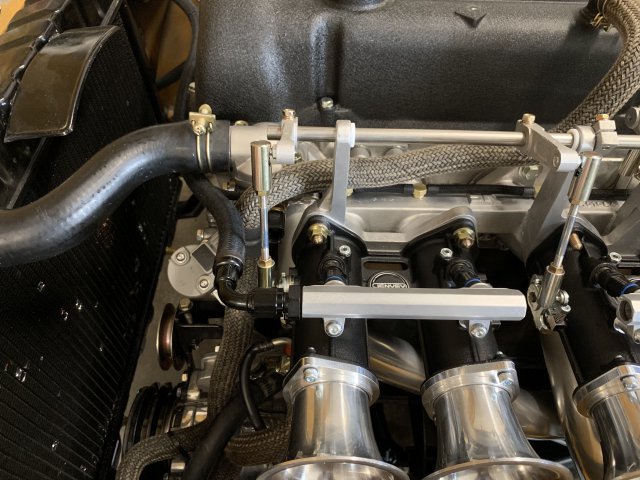

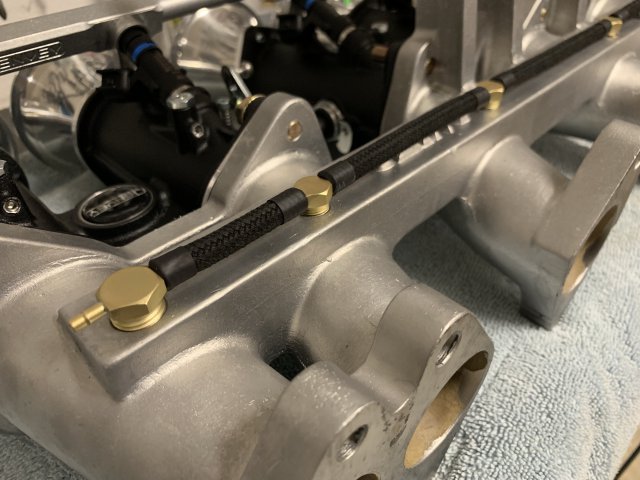

  14. That was also an option, but your tape lines would have to be perfect. Honestly I wish the throttle bodies were raw aluminum.

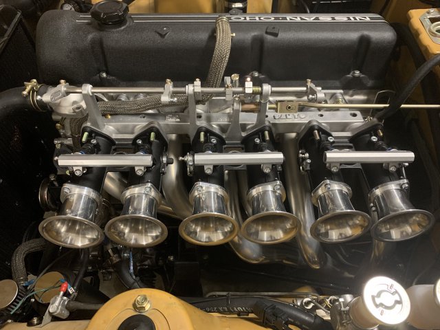

  15. The Mangoletsi intake is very well thought out and made. It was on the top of my list. SK Mangoletsi Jenvy

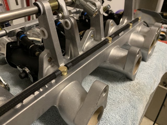

  16. Those look to be very similar intakes. I would guess most intakes were copies of designs. So similar runner length and spacing. Maybe I am wrong. Who knows, point being I dislike the look of fuel rails:) I was going to cover my tubes between ITB in some sort of cloth to mimic fuel hose, but decided against it when i didn't have any on hand. I have owned a Harada, FET, SK and TWM. I love my SK, to me it'just old school cool with the linkage. Plus the casting is light years nicer then the harada. Which I couldn't live with.
  17. I have owned 4 triple intakes. All are slightly different lengths, spacing etc... the dcoe pattern spacing is the same. But spacing from carb to carb would be different.
  18. I actually don’t like the look of one piece fuel rails. All triple intakes are different. So they could make one for their own intake. But not all without a lot of effort. My SK has the idle bump/ stop.

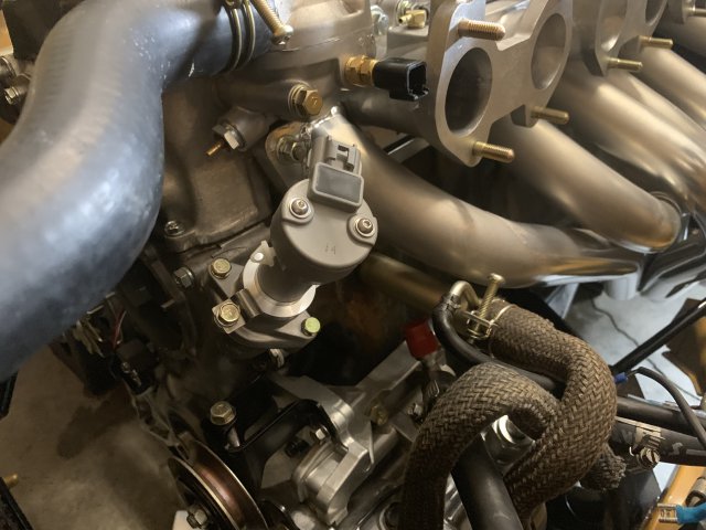

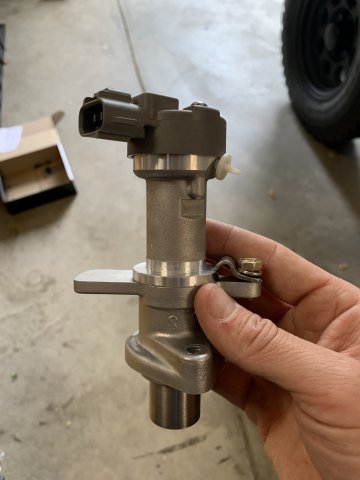

  19. These injectors can be pointed any direction. I will leave enough pig tail for each to plug and unplug easily. Shouldn't be an issue. I am copying the datsun spirit wiring and injector wiring setup. I bought the kit from them. Swap wires? No room to change any of the wiring without a ton of effort. It's all shielded and should be perfectly fine though. I am using a hall effect home sensor on the cam. Not enough wiring length for the crank sensor wiring to be on the injector side.
  20. I think this is how I will run my injector wires. Then y off at every runner. It would take some time. But look reallynice.
