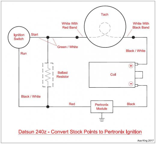

I did the same thing, works perfectly as my home signal for my EFI system and full sequential. I found a NOS one on ebay.

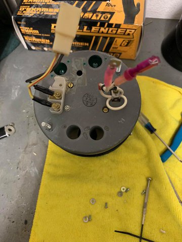

Well my stock original 1971 series 1 tach works with my fully sequential r35 coil on plug Efi system (haltech elite 750) . I literally ran the coil positive out from the ecu through the white wire with a red band then out to the coils through tachs white wire with a black band. Nothing else was needed. Added about 15” to my entire positive for the coils. I like how the tach feels and reacts the same as it always has. This would work on any 240z tach and a rb swap or aftermarket Efi with COP and fully sequential. I don’t know if it would work on wasted spark or not. Thanks Dirk Stoop for pushing this way vs the others. Where I got the idea https://www.viczcar.com/…/9515-getting-a-240z-tacho-to-wor…/
