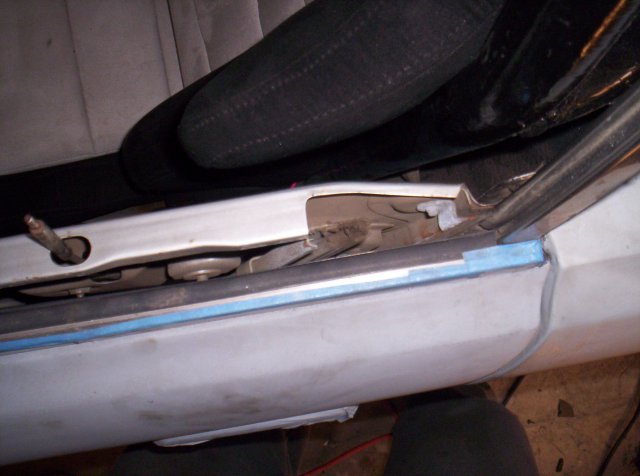

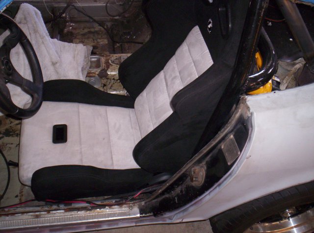

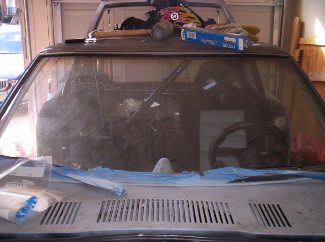

Here are some pictures of what it looks like. I will try and get a picture of the headroom and post up later. As you can see my next project is some floorboard repair.

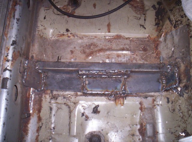

I have a 77 and just got done installing the TRS into mine (literally yesterday). The stock brackets line up with the rear holes on the seat mount, and a set of unthreaded holes on the front seat mount. I guess they figured you would somehow put a nut and a washer through there to hold the seat on. When positioned on the stock seat mount the TRS sits way to high for comfort (I am 6' and with a thick haircut would be rubing the roof). There is only about 3 inches from the seat to the steering wheel. I removed both of the stock front seat mounts (not that bad about 3 hours work with a angle grinder and a die grinder). I replaced the front seat mounts by using 1" square tubing that is anchored by 1/4" steel plates welded to the transmission tunnel and the rocker panel. Under the 1" square tubing I used 1/4" steel plate to anchor to the floor. Once the bar is in place I welded some 1.5" pieces of 3/8 all thread to act as a mount for the seat in the front. I then cut the tabs off the corbeau sourced brackets and bolted them to the new seat mount, and the existing rear seat mount. I then trimmed the excess metal from the corbeau brackets (there were some misc ears and etc that werent used). Once you have the bracket trimmed you set it in the car ontop of the ears that you bolted in, tac weld it to hold geometry. Then unbolt it, put the bracket on the seat and test fit. I did this a total of about 4 times for each side until I go the fitment correct. You will find that on the drivers side you have to beat the crap out of that catalytic convertor hump to get the seat to fit, and you will want to get the sit as close to the transmission tunnel on both sides as possible. Once you get the fitment correct just remove the brackets from the seat, and burn them in good so the seat wont bust while you are going down the street. It was a decent amount of work but the seats do now fit properly in the car.
