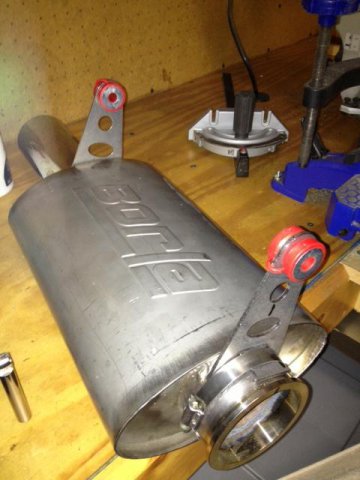

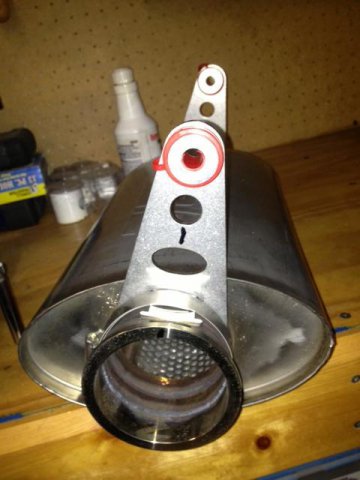

  10. Made a bunch of tabs to be welded to the underside of car for muffler hangars to attach to. Loving my Milwaukee portaband saw and my Swag Offroad table attachment-that kit has saved me tons of time. Photos show final muffler mock-up and my lousy working conditions due to some home remodeling.

  23. Muffler brackets on-pictures show hose clamp, but the brackets are tig welded onto the muffler now; thinking about adding a third bracket that connects to the spare tire well to "triangulate" it and make it a fairly fixed point to plan pipes from muffler to crossmember. Rethinking the v-band going into the muffler, the clearance is pretty tight between that inlet and the tire-wish I had chosen an offset-type muffler. Driveshaft just hit my porch; some tubing from Columbia River mandrel bending on porch too. Hope to get some work done this weekend between a gun show, cleaning up a friend's property, on-call for the hospital, killing weeds in my yard (not the California or Colorado weeds), church and keeping my wife happy. Maybe I'll sleep a little, but I gotta see some car progress.
