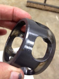

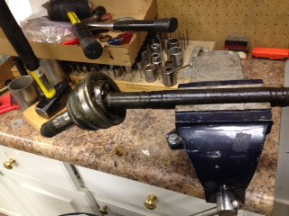

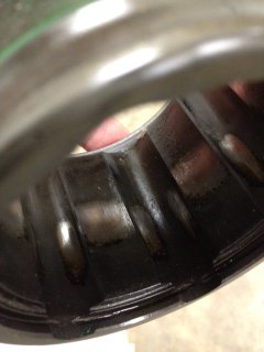

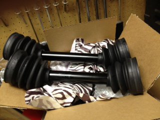

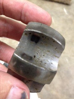

Doing the JMortensen axle swap / CV rebuild. #1 how the heck do I get that stinkin' inner CV off the shaft??? I have been whacking it with a brass drift until I'm afraid I'm gonna snap a tooth off of the big star fruit-shaped thing-em-a-bob in the center of the CV. The "sticky" references using a pipe - can anybody describe that technique in detail? Or tell me where he heck I'm supposed to whack this thing to get it to come off! Maybe I'm just not whacking it hard enough - should I worry about breaking things? #2 take a look at the photos I've added. Does the wear on this first outer CV look acceptable? Should I rotate the star-fruit thing-em-a-bob 180 degrees to get eliminate the wear pattern that the balls ride on? I only ripped off 2 fingernails getting the old boots off and the new boots on the new shafts - that is pretty good for me. I have a goal of getting to the strip with R200 CLSD with slicks on May 17th. Keith

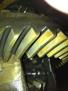

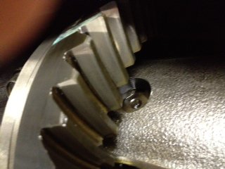

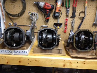

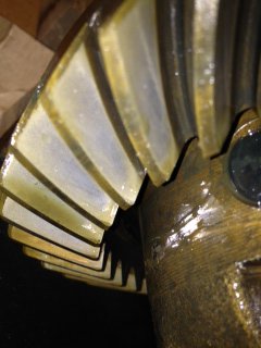

I'm collecting diffs for my LS2 project. Currently installed in my car is a STi R180 3.90 CLSD and 1st gear is kind of pointless, so I'm thinking about putting together a combo that has higher gearing. The T56 gearing is so close from 1st to 2nd that the shift light just stays on even though I've shifted up a gear! The picture shows, starting on the left: 3.90 CLSD, 3.70 CLSD, 3.54 Open. The 3.90 and 3.70 were purchased from Hybridz forum members while the 3.54 open was given to me by a friend who I share my old L24 parts with. Supposedly it was from a 1988 Z31 Turbo - it was supposed to be a LSD, but at least the axles were right. Anyway, if you compare the photos of the ring gears, the 3.54 open looks like varnish was sprayed into it. There is a yellow-ish tint to the entire inside of the diff. Also, when I try to turn the input flange, it kind of sticks or hangs up, then rotates freely, but with a little roughness, when compared to the LSDs. Do you think the open diff got hot, causing the discoloration? Simply aged oil? I was kind of hoping to swap one of the LSD units into the 3.54 in order to get high enough gearing to use 1st gear occasionally. I'm also wondering if it is worth the trouble to replace the bearings in the 3.54 - may be a heck of a lot of work. The browser posted the pictures in a different order: left is the inside of one of the LSDs (they both look great even though they were sold to me by different members), then all three diffs on the bench, then two shots of the interior of the open diff in question. If I can't figure this out, I may just shoot in the middle and start prepping the 3.70 for the time being. What do the sages of HybridZ recommend? Keith

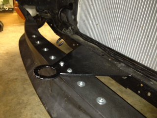

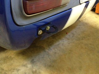

Totally stupid question, here, I don't know anything about racing regulations. Why does everybody label their tow hooks with the word "tow?" Maybe it isn't obvious?? Probably a regulation? The tow hooks look great. I use my front one everytime I winch the car on and off the trailer. So far, haven't used the rears.
