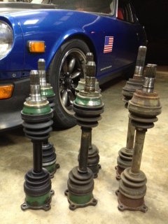

The Siro (Shiro?) axles I have are super rusty (from Ohio) on the inner and outer CVs, The regular Z31 turbo axle inner CVs are shiny under the paint, almost as if they are machined stainless steel. Is that true? Are the inner CVs stainless? I'm gonna have to get the Siro CVs sand blasted and I'm probably going to wind up swapping the Siro VLSD carrier into another differential case - rust is coming off of the casting in great big flakes.
I'm working on my R200 conversion and wanted to show some different Z31 axle configurations for comparison and discussion. The shortest (and cleanest) axles are rebuilt and modified with JMortensen's shortened shafts for installation into S30; I have also flipped the outer CV cages to shorten an additional 1/8". The longest (and rustiest) axles are from a 1988 Shiro model Z31 with VLSD. The middle set is stock Z31 turbo. I was not expecting the Shiro VLSD axles to be so significantly different from the standard Z31 turbo axle - the inner CVs with their splined output shafts are entirely different.

I use either a wood splitting wedge or a cold chisel (or is it coal chisel?) (which is basically a small wedge). I insert the wedge between the axle and the differential case and tap it in until the axle releases. A lot easier for me than prying-I can't find a place to fulcrum the pry bar or screwdriver.

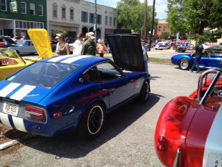

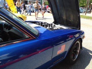

One of my best friends was diagnosed with prostate cancer this week and has surgery on Monday. We're going to a car show in Athens, Alabama this morning for a last "hoorah" before he's off-line for a few weeks. I see a stock 240z there every year; hoping to get a parking spot next to him. We'll see what the reaction to the stacks is. Got all my parts for the R200 swap - gonna go hard on it over the next 2 weekends and see if I can get it done. -
youtube "Dellorto Carburetors on 240z" for how the muffler sounds. Unfortunately just idling.
