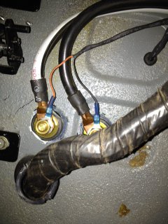

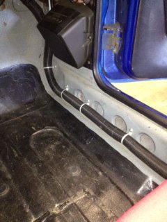

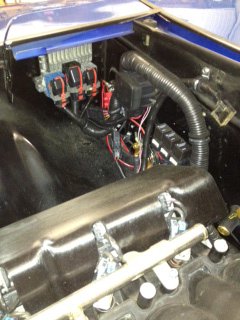

I relocated my battery so that I could put an engine wiring center in the location of the old battery. I have a bad back and while lots of guys want their engine wiring center on the inside of the firewall, I didn't want to spend that much time under the dash-I can't walk for two weeks after installing a speedometer. It is a little messy, but someday cleaning it up will become a priority and I will combine some of that squirrels nest into fewer wires and connectors. What are you doing fuel tank wise? If I had it to do over again and could weld, I would trash the spare tire well and build a recess in my rear hatch for a fuel tank and another for the battery leaving room on either side for dual exhaust. That way, my tank and battery would drop in from the TOP instead of having to lay under the car and lift the tank up while trying to attach it. In this day and age, a cell phone pretty well makes a spare tire optional. I have the battery in the rear hatch, electric fuel pump powered directly off it thru a relay, main cables traveling thru unibody over inner fender along passenger side rocker panel to a pair of bulkhead connectors from Speedwaymotors.com at the firewall. The bulkhead connectors now become terminals that the rest of the wiring system is built on. If you don't have EFI motor, your firewall would be really clean with just the bulkhead connectors and your power cables coming off of them just like a battery. Put a battery cutoff switch of one style or another in the system - mine has already saved me once from letting a small electrical fire turn into a big one. I had my battery cables made at a local truck parts store, they crimped the 3/8" terminals and heat-shrinked them for me. About $100 just in the cables (copper is expensive). Get BIG gauge cables, this isn't the time to try to save weight. You could probably just use one cable and ground your battery to the chassis, but I have had grounding problems before and just want my system to be bullet proof. Aren't cell phone cameras great? For some reason, the pictures posted in reverse order of my description above, view them from right to left as you read.

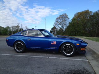

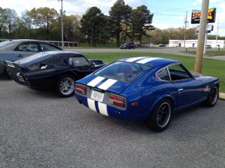

Drove car for about 2 hours - no issues. Video sounds bad, but the in-car sound is awesome. It was a beautiful day, drove up with a buddy tailing his Daytona Coupe replica to a little restaurant across the border in Loretta, TN. Gas gauge shows 3/4 full when totally full with fuel in sight in the fill tube. No leaks. No fuel cutout or rev limiter this trip. Fuel level still above 1/2 tank (according to gauge) after 2 hours of driving around. I think we were cruising at 60mph. Got a red left arm and sore cheeks from grinning all day. Notice God's favor raining down on the Z in one of the pictures-not photo shopped. Walbro fuel pump is not too noisy, just quiet buzz, water temp sitting at same point on gauge as my L24 did, same with oil pressure. Close ratio of 2-3, 3-4, 4-5 gets you there in a hurry. I keep shifting into 4th when trying to hit 6th. In 6th, the car just sort of idles down the road. If there are any bad vibrations, they are drown out by the straight pipes. Dump tubes are getting a nice light gray soot in them. Even with dump tubes in front of me, this car does not smell like fuel fumes like the old L24 did. I wasn't dizzy from carbon monoxide poisoning like I used to be. Perched car on the headers coming out of a driveway. Saw that the drop from the driveway to the roadway was risky so I went slow and backed up as soon as I felt pipes touch and picked a different route to get out of driveway. Inspected headers and oil pan - all OK. Low cars are a hassle, but oh, I love the sound of the side exhaust. Considering different routing play, but I gotta keep them in concept. Porterfield R4S pads are VERY dusty. Accelleration.MOV -

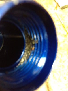

I made a pledge to clean my pre-pump fuel screen after every tank of gas until it was clean for two checks in a row. I almost talked myself out of it, but when I had some higher rpm cut-out, I couldn't be sure that it was my rev limiter and not that sandy tank again. So, I mustered up the strength at 11pm to go and put on some sexy 240z cologne before climbing in bed with my lovely wife. Pulled fuel screen and it was filthy again. See pictures. Even though I have been very careful with the tank, there was even a little paper towel fragment in the screen. I think I just kept myself from being embarrassed with the Cobra boys on tomorrow's reliability run. Saved again! By the way, as a board certified ophthalmologist, I can also attest that, while it hurts like hades, a healthy volume of $4.07, 93-octane gasoline directed straight into your eye will not permanently blind you. Should be fine by morning...I hope... She loves the smell of 240z - gonna get some action tonight, for sure! Note healing left thumb-add that to the cost of the build. -
