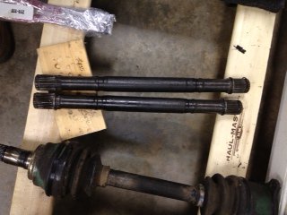

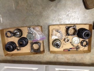

I couldn't go to sleep without giving it one more try with the info you guys have given me. Mounted axle in vise with inner stub hanging down. Grabbed the stub with left hand and pulled down while whacking (the CV) with a soft rubber dead blow hammer (my old one). I was not careful or timid. Came right off in a few smacks. I think two things were key: positioning the axle so that I could put a constant pull against the snap ring, and not being afraid of breaking anything. You guys gave me the confidence to be as rough as I needed to be. I didn't worry about breaking anything because of the video and your reassurances. Went ahead and did second axle - the whole dissassembly took me like 20 minutes (now that I know what I'm doing)! Thanks so much for this forum and all who contribute. Now to go to the JMortensen thread on dissassembling the inner CV! And, I can return the new $16 dead blow hammer!
