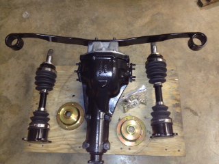

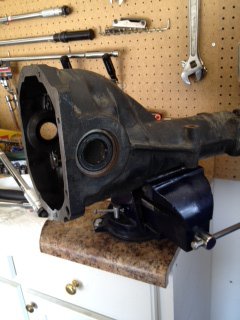

Finished product. Sub assemblies ready to be installed next weekend. Will try to yank down the R180, axles and control arms this week. I was hoping to drill the axle bolts and driveshaft bolts for safety wire this weekend, but just broke all my bits. Gonna treat all bolts to some blue locktite and mark them to show wheather they have broken torque or not. Used 2 quarts of Valvoline synthetic 75-90 for LSD and one tube (7oz) of CLSD additive. By the way, how do I distinguish transmission clutch chatter from CLSD clutch chatter?

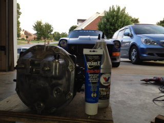

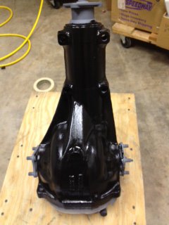

R200 CLSD subassemblies rebuilt, painted, filled with oil and ready for installation. Used 2 quarts of Valvoline synthetic 75-90 for LSD and one tube (7oz) of CLSD additive. Gonna jack up car tomorrow night and try to have all the old stuff off during this week so that I can start re-assembly next Saturday. Anybody know for certain which side gets the short CV axle? Otherwise, it is measure and trial and error for me! -

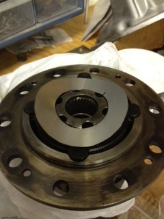

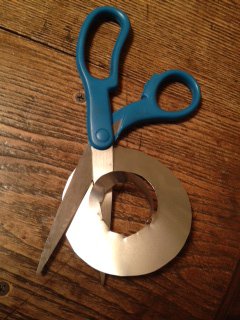

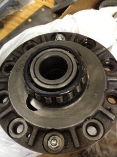

The sticky thread on shimming the CLSD was very helpful, and so was JMortensen's thread that further discusses the subject of adding clutches. Using shims to replace the two stock CLSD spacers is described, but no pictures were provided, so I had trouble getting my head around the process. My contribution is these photos from my R200 CLSD upgrade. When I ordered my CLSD clutches from Savage42, I forgot to discuss the shimming with him. After discussing this with other forum members, I ordered 0.004 shim material from McMaster.com I put them all on one side to make future adjustments easier. With the shims and additional clutches made it impossible to get the Phillips head carrier screws on, so I used 1" long 1/4" bolts to compress the springs until I got the Phillips head screws in and torqued. I supported the carrier by mounting a stub axle in a vice. The additional clutches increased the break away torque so that I could retorque the ring gear with lock tite to 70#, inserted the carrier and torqued the retention yoke bolts to 70# with red locktite, then installed a new gasket and torqued the rear cover bolts to 17#. Then lots of scrubbing, wire brushing and cleaning before paint.

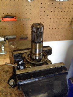

I've got the axles totally rebuilt off the car using a vice and getting help from my daughter. JMortensen, we are on the same basic sheet of music. In the axle rebuild, the main problem was my lacking the confidence to strike as hard as necessary with a 3 pound sledge. Once I committed to that it wasn't a big problem. I just fought and fought with inadequate hammer force because my dad was a rocket scientist and I'm an eye surgeon. The concept of pounding something into submission is just difficult for me to face up to. Once committed to the amount of force required, it was a breeze, just like you said it would be. I put my daughter on a stool and had her do the hammering while I massaged the c-clip and kept constant pressure on the shaft. My neighbors were probably spreading rumors after hearing me yelling: "Hit it harder, sweet-heart! Harder! Harder!" People always assume the worst in Alabama. It was a little scary with her swinging a 3 pound sledge right over my head-I'm surprised she didn't take advantage of the opportunity to give me a little attitude adjustment. I and others have had some trouble getting the (already assembled) inner CV end of the axle to pop in and out of the diff, once the diff is installed in the car. That is what I'm referring to. I'm sure that too, is just a matter of me being a sissy. And the lack of a chassis lift doing this on my back. I'm getting a pretty good cussing vocabulary, which always helps just about everything. It is almost 1200-noon, I need a beer just thinking about it. When you discuss checking for CV axle bind, I think you mean to unbolt the OUTER CV (typo?). You can't unbolt the inner CV; it has no bolts.

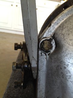

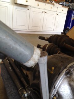

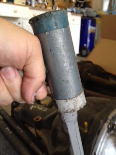

I just saw a 3.70 CLSD se on eBay for $300. Of course that was the morning after. Damn sleep! Why do we need it? I took some photos of the chisel technique. Put the chisel between the axle and the case. Strike the chisel with a straight blow to get it started out, then strike the chisel with a glancing blow to pop it all the way out. Try to catch it so you don't goof up the splines when it hits the concrete. Pictures posted out of order.
