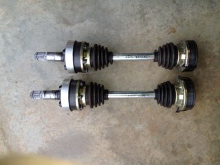

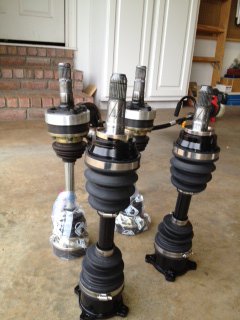

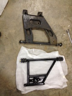

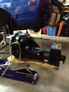

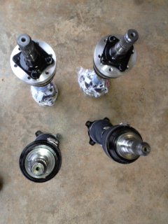

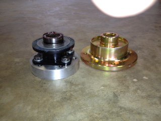

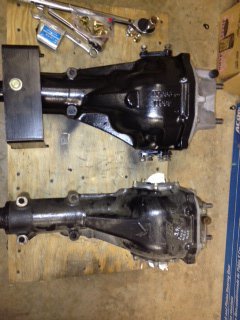

Got diff R200 in with CV axles, and shortened adjustable rear LCAs. Ops normal, I did everything wrong and had to do almost every step twice. I am now an expert with the spindle pin puller, having learned the wrong way to use it first and getting it stuck on the spindle pin. (That tool is an ablsolute miracle - everyone should order one right now). I am an expert on putting a spindle pin in backwards (why didn't Datsun, put the flat spot exactly in the middle so it could go in either way??). I am proficient at cross threading a locking nut onto a stub axle, but luckily, I'm pretty good at cleaning up goofed threads. I'm good at re-routing brake lines that rub on the companion flanges. All that considered, it went pretty well. The RT mount is so much easier to install than the stock mount; it also allows you to torque the driveshaft bolts with the crowded front-rear suspension crossmember off, although there still isn't enough room to use an actual torque wrench to tighten them. The 280z mustache bar goes in pretty easy if you take the rear-rear suspension cross member out first since it goes BEHIND the uprights instead of in front of the uprights for the 240z mustache bar. My buddy's high torque long-ass torque wrench is awesome. The CV axle bolts have room to use a crows foot and torque wrench to torque them rather than using german torque as required with stock companion flanges. The Z31 CLSD R200 input flange was exactly the same as my old 240z R180 input flange, so the JCI driveshaft bolted right up without modification - I just dropped the driveshaft and let it hang, so I didn't have to drain the tranny. The adjustable LCAs allowed me to reduce the negative camber induced by lowering and upper camber plates, as required to get my wheels and tires inside the wheelwells. I kicked the top of the tire in just enough for the tires to clear the fenders. Well, I used the LCAs to pull the bottom of the tire in. Stock LCAs are about 14.5" center to center. I adjusted my new ones an inch shorter at 13.5". That actually gave me some obvious positive camber! Imagine - a lowered Z with positive camber! Once the suspension settles with a test drive, it may not actually be positive. When I get it to the alignment shop, I'm going to arrange for 2 settings: drag with zero camber and autox with whatever johnc's specs are. I dropped my coilovers way down and jacked the LCAs way up with the CV axles loosened up to check for axle bind (the shafts are shortened by JMortensen). Full travel up and down, and I always had a little slack in the axles (not much). Glad I flipped the cages while I had them apart. It was a busy weekend. I'll try to add some pictures tomorrow. -

I had a hard time coming up with one, myself a few months back. Mine was present but bent up - I managed to carefully hammer mine back into shape well enough to use. Is yours lost or bent? Make sure you measure for the one you need, so you can check the supplier - the only one I came up with was the wrong size for my axles and I wound up sending it back. If you wind up having to go without, you may be ok depending on what you are bolting the axle to. It is just a dust cap and really is only needed for storage.
I need a source for some of the plastic storage plugs for the side axle (stub axle or whatever) holes in the R180 and R200. Part number will put the icing on the cake. Using paper towels for now, but I would like to store diffs full of oil. I know I'll still have to be careful to keep diffs upright even with plugs in. Can anybody help?

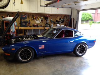

Wake up its Zaturday! Get out in the shop and send us some pics. -
