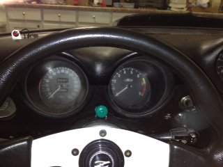

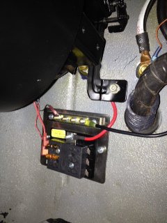

Got shift light working. Brand is "Raptor." I chose it because it is small, has a really simple LSx wiring plan and install plan and easy to adjust. Chose green color because green means GO! Mounts with one screw. Wires to the brown/orange tach output wire from the PCM; I mated it directly to the back of the JCI-modified stock 240z tach. Then I sent a 12V wire and ground to my fuse new inside fuse block with 5A fuse. No problems with the tach - it seems to match what the shift light is saying. With low diff gearing and close-ratio T56, I'm gonna be one slap shiftin' fool. There is so little rpm drop between gears that the shift light comes right back on right after the previous gear change and it is time to shift again. My buddy made a pretty good youtube video of car running - closes thing to being there. Shift light wasn't initially working because I had dip-switches set up incorrectly. Re-read instructions and it was fixed in a minute. Instructions were well written, I'm just a little stupid. IMG_0247.MOV -

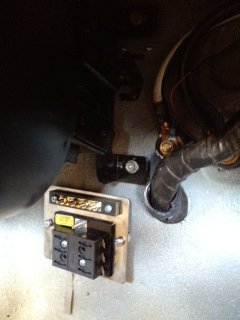

Tach, shift light and line lock wired. Little red indicator light lets me know line lock is engaged; green thing between speedo and tach is shift light. Next is speedo. Anybody know, off hand, what thread pitch the tach retaining nuts are? I seem to have lost mine...I can trial and error if nobody knows. Still gotta figure out where those 4 bulbs in the back of the tach go....Does a 240z have a check engine light? - I'm wondering if I should wire the "malfunction" wire from the PCM - where did (or didn't) you guys wire that with the stock gauges? I may add pictures tomorrow, but other than the shift light and my "inside accessory fuse block" there is not much to show. -
