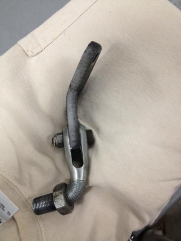

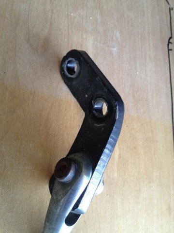

The bolts are all perfect. The washer on the rear hole is bent. I think you are spot on about the need for more meat around the bolt hole. I'm waiting on a quote from an on-line supplier for both 4130 and 4140HT. My only real remaining question is on the clevis bending. Chicken or egg? My best pics are two quotes up.

Rob, there may just be enough slop in the bolt holes to allow the theoretical misalignment to be neglected in reality. As we bench race, we assume zero manufacturing tolerances, which isn't really true. You are giving me good data to consider. If I misunderstood Gabe, he may be saying that from your 4-degrees, perhaps I could get 3more for a total of 7, which is no slouch. I haven't totally taken TTT rods off the table. If I can, I want to make my doglegs wider at the rear bolt as 74_ has done. I think that's where the actual bend started due to weakening from the loss of material after the hole was drilled. TTT rods have about as much material in that area as mine did. I think the bending of the clevis saved my ass. So I want to be careful not to throw out the baby with the bath water. The car has been squirrelie on braking for a while-the dogleg may have been flexing for as much as a year before it finally said "enough."
74- what does the frame end of your TC rod mount look like? Heim or inner tie rod? I think Im gonna just make a heavier dog leg out of chrome moly (or whatever the best alloy I can get is) for now since I think the failure initiated at the rear bolt hole (picture later). As I see the ball joint swinging like a pendulum from the camber plate, to eliminate ANY flex moment would require mounting the the dogleg approximately 3-feet below the ball joint and would assume no bending of the strut tube: a totally idealized situation. I think some flex/rotation at this point must be accepted as a reality. Maybe this winter I can step up to heavier clevises (3/4") too.

74_, I'm pretty sure you and I are on the same sheet of music. And fortunately, I understand the issue with rigid connection of the LCA to the TC rod intuitively, cause I sucked at trig (11th grade). If you had tried geometry(10th grade), you might not have lost me. Remember, I was raised in Arkansas and I now live in Alabama. We know how many stars are on the Confederate flag cause we can count 'em on our toes! Rob is from Louisiana, so he probably understood you loud and clear, although I need subtitles when he talks. From what I understood in your earlier texts, you kept the same basic design, but made it heavier duty: stronger dogleg with more meat around that rear bolt hole, and 3/4" clevis where I have 5/8, and larger diameter tubes. Am I missing something else? I wonder if there is a point relative to the ball joint, any point, at which the dogleg is not in flexion/bending? This may be part of why Cobra Matt went non-S30 on his latest front suspension make-over (?) although I'm pretty sure it had cost him a year or two of racing the Z. I was surfing the net for swaged tubes, clevises and inner tie rod ends. Not a huge job to go bigger (the only issue is non published specs on the inner tie rod ends). But I'm thinking about putting a dogleg on the underside of the ball joint (too) to put that clevis in double shear. Whatcha think? I'm off to church.
Rob, do you know how much caster your alignment has in it? I talked to Gabe via email and he told me that he has some spacers one can add to his TC rods to achieve 2-3 degrees of caster. I'm running 5 degrees now (limited by tire clearance); I want to run a lot more (maybe as much as 10 degrees) for my 1-mile runs in June. The purpose for me is to achieve a car that is so stable that I could release the wheel at 200 mph. Before this broke, this was gonna be a winter project, but this little breakage moved it up on the list. I wonder if flexing in these dogleg/clevis portion of the TC rod is why I had such scary "bump steer" under braking at the Ohio Mile. Imagine if this little parts failure had happened then! I feel pretty lucky.

What would happen if I bolted the plate to the BOTTOM of the ball joint mounting web? Instead of the top? Will that stop the bending moment? I was all ready to buy TTT TC rods, but I just realized (and it was mentioned above) that without the clevis, I would lose the ability to adjust caster (which I really want to be able to do-allowing me to run LOTS of caster for landspeed and a little caster for autocross.
