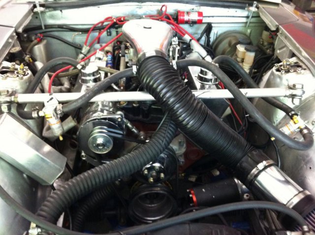

So there was a LOT of discussion last weekend about doing a leakdown test and how some thought the motor was broke or rings were improperly installed. Tom and I did the test and saw on average 4-6% between cylinders. This last weeks worth of posts is important because as we all have seen, crank case pressures CAN cause real headaches and force oil out of interesting places. What I did was start researching how the latest models are handling crank case ventilation. This lead me to buy TWO baffles for the valve covers, to incorporate the valve cover breather tubes from the exhaust extractor kit previously used on the car, and to plumb everthing thru a pair of air/oil separators. I then ran the lines from the air/oil separators back into the snorkel on the intake. We expect this to work, but at least now I know the rings are sealing the motor properly, and the valve seals are also doing their job. Moral of this story is not to panic, but to also remember that once vacuum is lost, parts can't function properly without that vacuum. In my case, we had TWO pieces fail. I will know for sure if the new solution works later this week. I'll get the car out for a quick 5 mile drive and see how the motor handles the extraction of gases thru the new system. I was VERY frustrated at being at my favorite track 3.5 hours from my home and unable to drive this car. Hopefully we'll get to have some enjoyable time in the seat this year... Hopefully. Mike

Today Tom Harris and I did a leakdown test and came away with what are considered very good numbers for a 10.5:1 compression motor with 12 miles and 45 minutes run time on it. What we are thinking may have happened is that the grommet on the passenger side valve cover was leaking, along with one of the Moroso exhaust extractors had failed. I had T'ed the valve covers together so there was NO draw on the valve covers from the intake or exhaust to draw the pressure off the crankcase. To fix this whole mess, I removed the Moroso exhaust extractors and capped off those pipes. I now am running some custom valve cover inserts that have baffles, and I use the moroso valve cover breather routed to a pair of air-oil separators from jegs, and then plumb them back into the snorkel on the intake. I will drive the car in the next day or two to test the theory and see if I can force any oil out of the dipstick tube.

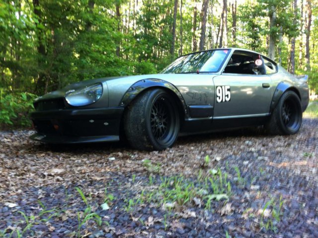

Man this is an oooooold thread... Wanted to weigh in with CHANGES to my aero and some more data. The car actually weighed 2709 pounds full of fuel back when I had the small flares, heavy grey 5 stars, and large wing on it. we did a BUNCH of weight reduction and the car now weighs in at 2625. Some of the weight reduction was due to wiring changes/removal of the painless nightmare of the painless harness, reconfiguring the fuel deliver which removed the surge cannister/plumbing, extra pump and lines, removal of the windshield wiper assembly/arms/motor, and removal of the passenger seat/mounts/harness/hardware. I ditched the sheet aluminum dash and went with a FAST touch display on my own custom dash made of kydex. I also added CCW LM20 wheels and much lighter hoosier tires. We ditched the big rear wing for now because of stability issues. Pete, the wing was an ebay special. I now run the ZCarCustoms JDM rear spoiler and I really like the looks of it. We've also changed the stance by adding the larger ZForce flares, fender air extractors, carbon vents in the hood. I do plan to now start working on some subtle side skirts and an under body tray up front, along with fabrication of a rear difuser. I previously thought this might be a waste of time, But I'm planning to fab something up that can be easily removed. We plan to be able to attach it off the sides of the fuel cell can (steel structure) and the rear subframe, and maybe use Dseuz fasteners to provide ease of attachment and removal. more as the bits develop. I also plan to remove my radiator air box, wrap it in wax paper, and do the cloth/resin hokey pokey to make it fiberglass. We are also THINKING about dumping the back side air up at the hood... Starting to noodle that over now. Go to my build page for more updated photos! Mike -
