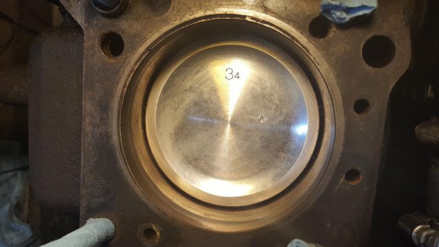

Small chip on piston. Does this need to be replaced?
dpuma8 replied to dpuma8's topic in Nissan L6 Forum
I didn't run a compression test and the engine ran fine with my N47 head. I am just changing over to P90 and turboing it so I wasn't sure if this was a major issue while tuning. Thanks for the help! -
	I am converting my 280Z N42 block over to turbo so that I can get my megasquirt tune down before I put in my $3500 L28et that a shop is making. While swapping the head to the P90 one, I noticed that piston #1 has a really small chip in it. Is this a big issue that needs to be replaced immediately or will it be fine for tuning purposes?
