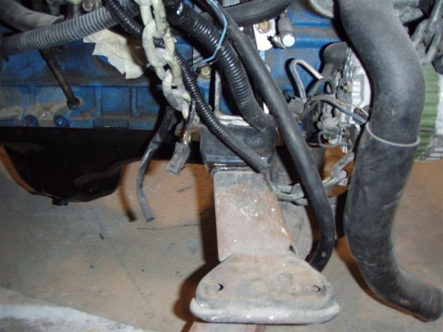

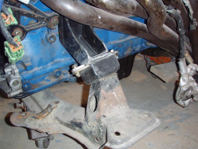

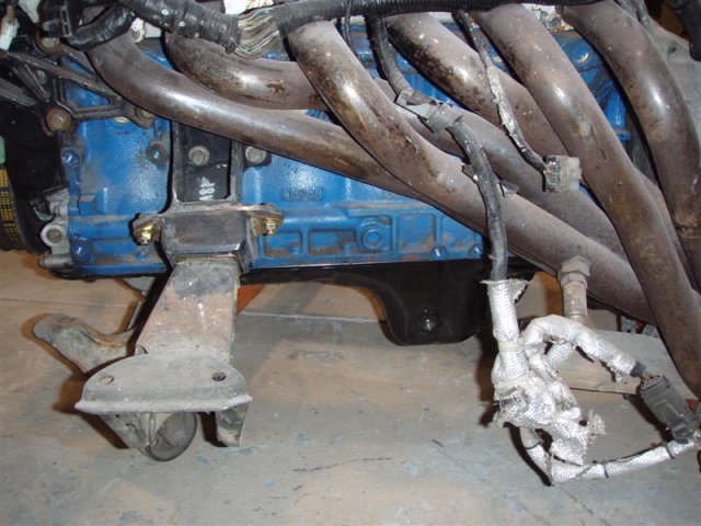

Modified Castlemain Rodshop units. The Castlemain mounts are designed to use the standard zed isolator but I am using the Energy Suspension isolator partnumber #2.1102 as they have a safety interlock design see http://www.energysuspension.com/pages/univ3.html and here http://forums.hybridz.org/showthread.php?t=120218&highlight=2.1102 So we cut off the ears and welded on a new 5mm plate that had longer ears for these wider mounts.

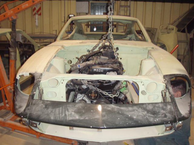

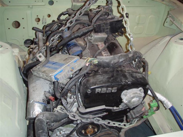

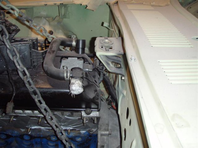

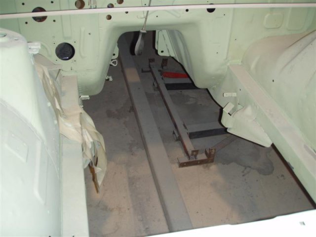

Some more pics - the cross member is the not the final one just one spare that I had. We can now fab up the gearbox mount and sort a few other things in the engine bay before the engine is removed and the body work finished once and for all.

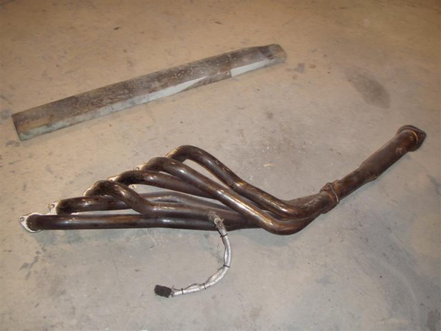

Ok got busy tonight after work. The stainless steel headers that came with this engine are a very close fit. And they almost fit but they are fowling on the flange at the floor but only just. You see the engine mounts have been modified for the captive engine mounts and this has raised the engine 5mm from the standard castle main mount. So if this was not done I believe there would be no issues. Having said that I plan to install the RB30 in the future so that will lift the head 38mm from where it sits now so I am going to see if I can get the header modified to lower the flange. Anyway here are some pics.

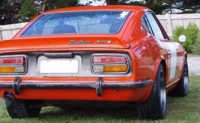

Not quite right. You see the 7" rim is infact almost 8" from outer rim to outer rim and the 8" rim is 9". So an 8" rim with a zero offset is more like 4.5" backspace and a 7" with 0 is 4" so +15 will then add your extra 0.59" so both will have almost the same backspace of 4.5". The max of the 280z due to the lower spring perch is around 4.5" to 4.65" so a 8" with +4 would be good. The 0 will work too but you need to be careful of the tyre choice as they could catch on the guards and it will be rear that will have more issues at the 0 offset. Here is a different (more of a side shot of my old 240z) with the 16x8 +10. Now on fronts I had a disk setup that went over the hubs so this was the same as running a 6mm spacer so that would make the rims on the front sit the same as the 16x8 +4. You can see there is room on the rear (you might also make out that rear guards are rolled/trimmed, this was done before I purchased the car for when it had the 16x9 with a 245/45/16 fitted) so with a 225/45/16 you can see on the 16x8 it is a good fit. As the 240z spring perch is almost 1" higher you can get away with more backspace on the fronts like almost 4.9" (this is what the 16x8 +10 end up with, and they would clear with my old brake setup which was stock) These would not work on a 260z that I tried them on (we did not get the S30 bodied 280z but our later 260z has the same suspension setup as your S30 280z) So I would recommend 16x8 +4 on a 280z, these will be very close on the fronts so a 245/45/16 will more than likely cause rubbing. So a 225/50 or 225/45 would be the best bet. The only reason I say this is you will have the same rim on all 4 corners ie you can rotate the rims/tyres which you can't do with the staggered setup. However your investment in rims your choice. I have been there and done that a number of time with rims and for a car with stock guards I liked the setup that was on my last 240z you can see by the pic the combo worked well on the 240z with the 16x8 +10 so I think if you have stock type brake setup ie no disk over the hub then 16x8 +4 are almost perfect on the zed cars. A 0 offset gets a bit close to the lip of the guards. Cheers Mike
What zed to you have a 240z or a 260z/280z? There is a difference in the front strut spring perch location so it can make a difference. I had a 240z with stock spring perches and when I purchased the car it had 16x9 on all 4 corners without guard mods. I then replaced these (as a 245/45/16 which was ideal for the rim were too wide and guard mods would be required) so I go some 16x8 +10 on all 4 corners with no issues anywhere. Here is a pic rims are Rota RB-R in hyperblack 16x8 + 10 tyres are 225/45/16 with a rim protector type side wall. These rims would have clearance issues on a 260z/280z front strut so you would be better with the 16x8 +4. With a 0 offset you might have clearance issue on the rear depending on the tyre ie how it sits on the rim and the size as there appears to be less room on the rear than the fronts.
