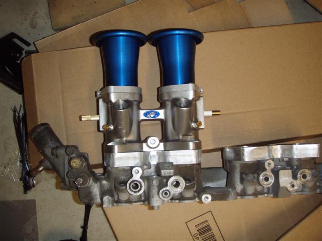

So tonight I spend a few hours in the garage getting the TB shafts the right length for the RB26 manifold - so here are the results. Can't want to get these on the car - however that will not happen until after the engine bay is painted.
great news on yours 260zman. Mine is still sometime away. After selling my 240z to fund the building of a new garage for the 260z and to complete the project once and for all (10 years and a number of project scope changes I will get there) I can see light at the end of the tunnel. Here is tonight's efforts - I now need to visit the car and measure from the head mounting face to the strut tower to check that distance but I think they will fit - however I might need to shorten the trumpets up a little so I can put a cold airbox around them. Now I just need to have the throttle shafts shortened so I can mount all 3 TB on the manifold.
Well - lets see - put some bungs in the standard injector holes - mount some DCOE TB's on with the injectors further away this has benefits, many when looking at larger injectors and higher performance applications. There is lots of info and theory about this on the interweb thing see here for example http://www.hotrod.com/pitstop/hrdp_0704_pitstop_fuel_injector_location/index.html but the idea is that small injectors have a good spray pattern = close the head is good ie OEM setups but larger injectors the spray pattern is not so good so having these further way = more atomisation before it get to the valve. You can run a tapper TB like I will be 50mm at the trumpet, 48mm at the butterfly and 45mm at the manifold = better for flow = more performance can be gained vs straight bore TB's. If your ECU support it - you could have a dual injector setup ie use the ones next to the head for economy/low speed work and the add or swap to the higher performance injectors. Or you could have the injectors in the stock location but have empty carbs and use these for their butterflies and the old school look - now that is an idea I like They will look way cool - how much is that worth? And also this •Long skinny intake runners create air velocity and torque at low RPM. •Short fat intake runners create air velocity and horsepower at high RPM. So you will be adding more length to the intake runners as the DCOE TB's will be at least 20mm further away (this is how thick these adaptors are) and there is room for this in the zed engine bay

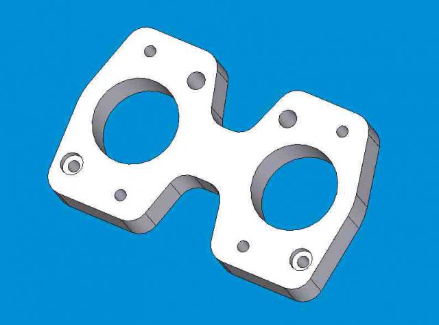

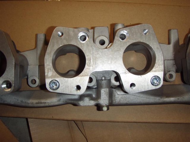

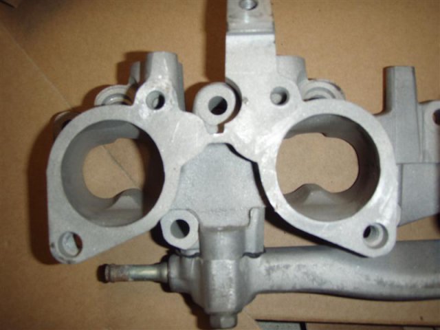

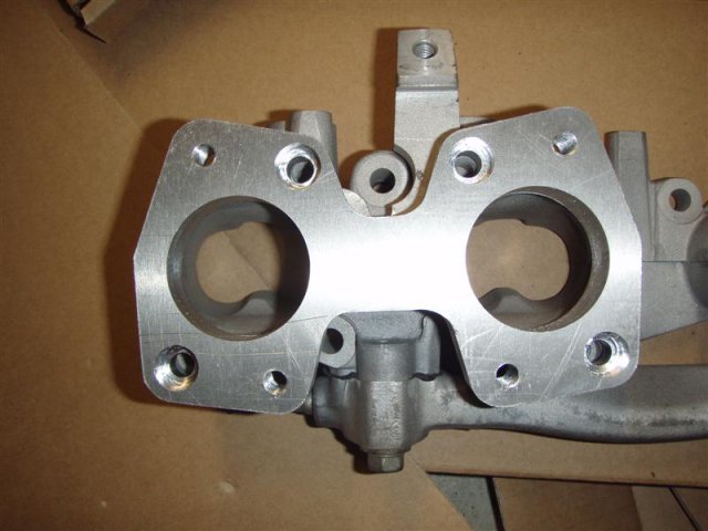

Just got my RB26 DCOE adaptors back from the CNC guy. So my question how many others on here would be interested in a set? I can arrange the supply of these for $300 USD + shipping for 3 of these adaptors. They will be supplied with cap screws to mount these to your RB26 manifold - these replace the standard RB26 TB and allow the bolting on of any DCOE carbs or throttle body. Made from marine grade alloy. Perfect for you N/A RB26 head conversion or maybe a blow through setup with something different from the standard RB26 TB setup - ie using the standard injector location and second set in the DCOE throttle body. Pics attached and once I mount up the DCOE TB I will take some more pics - I might mount some carbs for photo's too Pic #1 = RB26 head manifold without stock TB installed Pic #2 = RB26 head manifold with new adaptor sitting in place Pic #3 = RB26 head manifold with new adaptor 1/2 bolted down Pic #4 = Prototype drawing If no interest then at least you guys will see what I have done

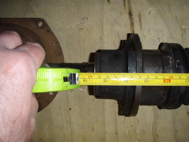

Just realised I did not post the length of that other axle that I found. Anyway attached is the 300zx and 300zxt shafts (complete max and min length) as I have 2 spare long shafts I can confirm they are approx 400mm long and I know the short side is approx 10mm shorter and looking at the attached spec sheet you will see that this works out - ie long side fully compressed = 421.5mm short side fully compressed = 409.5mm so the difference is the shaft length (as if you look at how the length is measured you will see this does not include the bit inside the diff) so that is a difference of 12mm or almost 1/2" for you guys that measure in that method. So to recap the 300ZXT shafts (that is without the CV's on the ends ie just the bare centre shaft) are as follows (approx lengths) Long side = 400mm shaft Short side = 388mm shaft The other Nissan shaft that I have found has the same splines as the Z31 300zxt shafts. And both sides are the same length. The length is 343mm for the shaft only. so that is 57mm shorter than the standard Z31 300ZXT long shaft and 45mm shorter than the Z31 300ZXT short shaft. My plan is to do see if some standard short nose R200 plug-in axles + these shorter shafts with the right combo of CV bits will result in a solution with no binding or chance of such occurring no matter how low your car is - once I know what the solution (if it works) I will let you know what the axles are from but they should be more common and easier to find given the number of these manufactured. If this does work it will also mean there will be a solution for VLSD centre too without the need for the hard to get (rare if you like) 1988 SS (or is that SE) VLSD Z31 300ZXT halfshafts. And even a solution for the S15 HLSD centres if you get the diff input axles too. I will update this thread once I get hold of a short nose R200 with the diff plug-in axles that I am looking for (I will know after the weekend if I get the one off our evil bay for $20 - want to keep the cost low incase this does not work don't want to be too far out of pocket) but again all using parts from wrecks so far to see if the combo does work out. Cheers Mike
