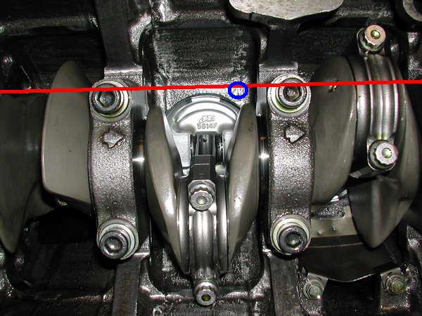

Yep - for those of you that didn't check out the link the TheSwede provided, here's a pic, linked from that article:
I'm pretty sure that this was what the original post was asking about.

The engine is from a Toyota Hiace, a 2.6liter straight four. Turbo converted with oil jets from BMW,the type you machine into your maincap bearings. Not much else done internally than forged pistons and rods. The last dyno sheet said 627bhp at the wheels. (2 bar/30psi of boost :)

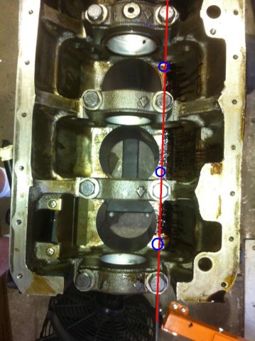

So digging around on the internet, I came up with a link to this BMW install. It's from Sweden, so local for some.
http://forum.e46fanatics.com/showthread.php?t=720393

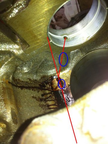

Still haven't tapped into my block yet. I'm thinking I'll either have to bore diagonally back to the main oil galley on the side of the block, or tap the oil flow in each main bearing web and turn it to hit the piston with a custom nozzle. More research is required.

Also, the main galley looks to run the length of the block and is just to the passenger side (in the US anyway) of the cylinder bores, so I don't think you'll have to angle drill to intercept it - I think you were looking at the galley that feeds the oil filter input.
